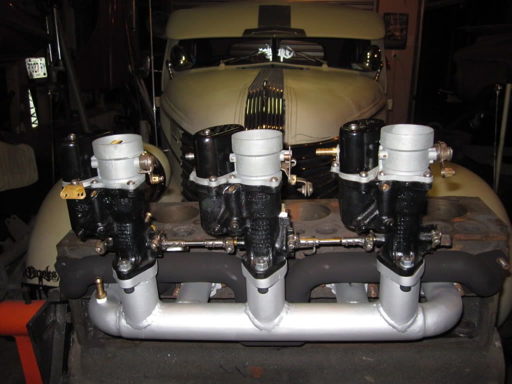

Hey guys, well after searching for a split exhaust manifold for my 38 Pontiac without any joy as they are as rare as rocking horse shit, i decided to have a go at making my own. Now bear in mind, ive never tried this before and i have no special tooling, apart from the laser cut flanges this was all done using steam tubing and bends, hole saws, drill press, mig welder, 4" angle grinder, spirit level and some eye-chrometering to get it looking sweet. After making the exhaust manifold, i realised that the original intake would not fit, so a new intake was made also. Turned out pretty sweet for an ammatures first attempt, hope you enjoy the pics
This is the original setup on the car at the moment.
I borrowed a block and manifolds from an old digger who has a fully restored 38 and previously owned mine.
I made cardboard templates for the flanges to be cut out of 10mm mild steel plate
The assembly begins
After the 1st half i got carried away and completed the whole manifold except the outlet flange and forgot to take progress pics
I then started the intake........
....and went with tripples!!!

Now i just have to set up the carbs, linkages etc. im going to be running Carter W-1 carbs all going to plan. Still a way to go but am stoked with how its turned out so far

Just finished cleaning and assembling the carbs, gotta sort out how to link them together now. Still missing the lid off one of the carbs (any spare carbs or parts are welcome) but gives the general idea.

Got the carbs fully assembled today and painted the manifolds for the time being, im too broke to get em chromed and there isnt any other shiny stuff on the motor anyways.

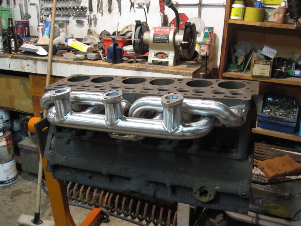

Was speaking to a buddy who owns a traditional hot rod shop in town and told him what ive been up to lately, he directed my attention to an old manifold sitting on his window sill..... for the price he was asking, i just had to buy it, check the pics
Im still going to run my triple manifold, the twin will be nice wall art for the time being.
