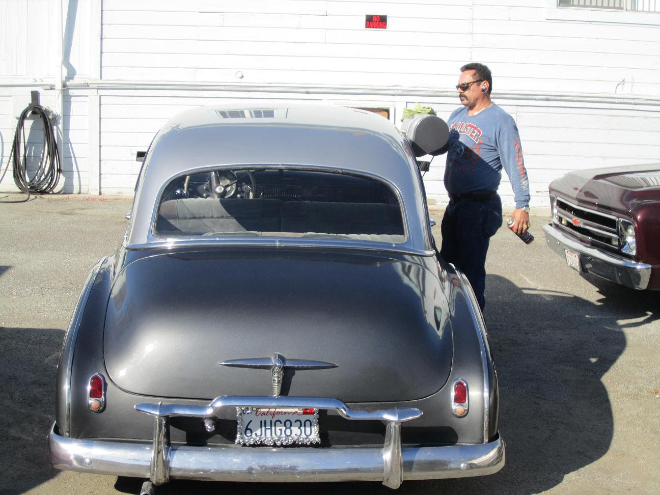

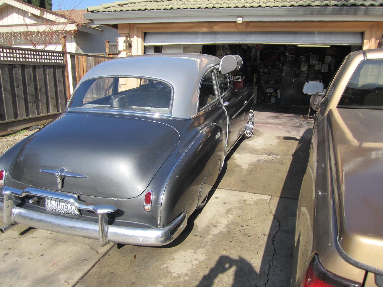

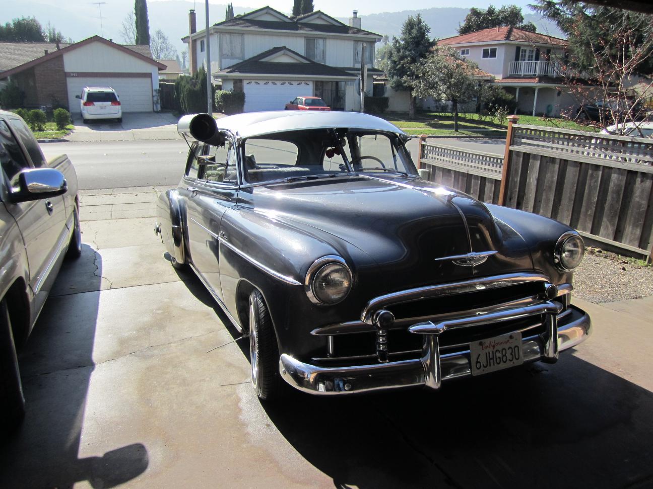

Here are some pics from the previous owner

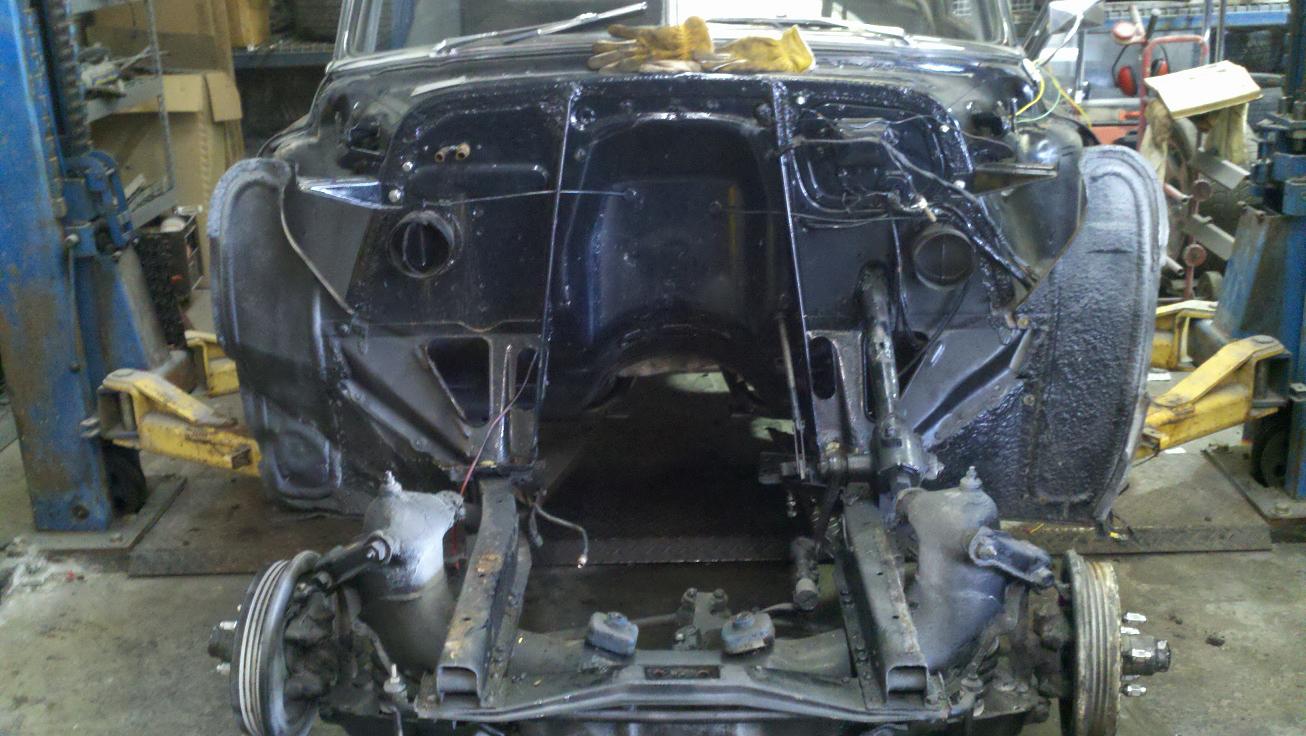

Step One DISASSEMBLE JOHNNY 5
We ripped all the front sheetmetal, the engine, trans, closed driveline, rear springs, etc. out of the car.

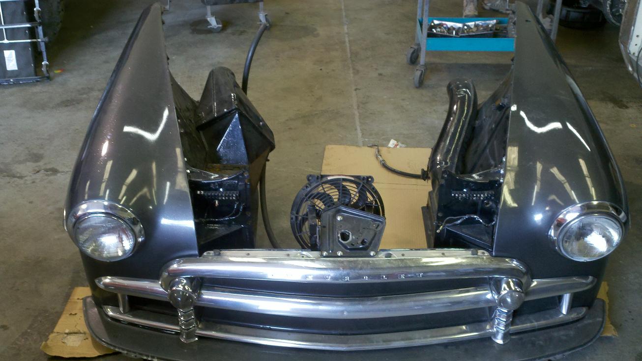

More Disassembly

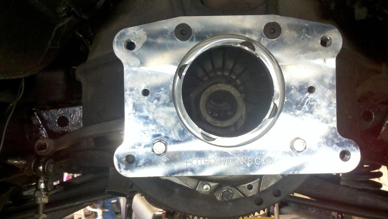

For the trans, I went with an S10 2wd, 5-speed. HotRodWorks sent me out the trans adapter and mount setup.

My friend Danny is an amazing welder, so I coaxed him into helping me do the Fatman kit. He welds for the local refineries and wineries and his skill is badass.

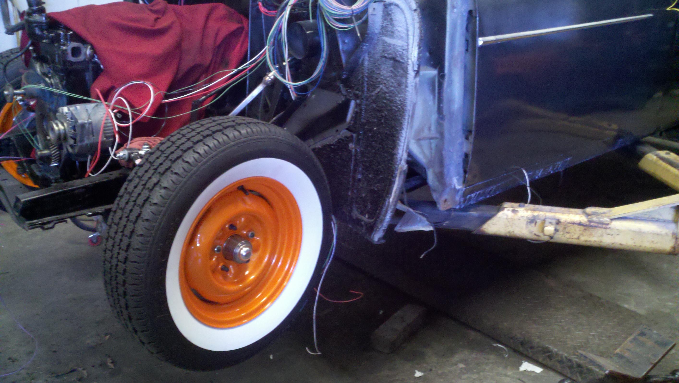

Decided to run the stock steelies, painted in HOK Sunset Orange with some ribbed rings and spiders from HubCapMike. They were beautiful out of the booth, and got even better with the Cokers installed.

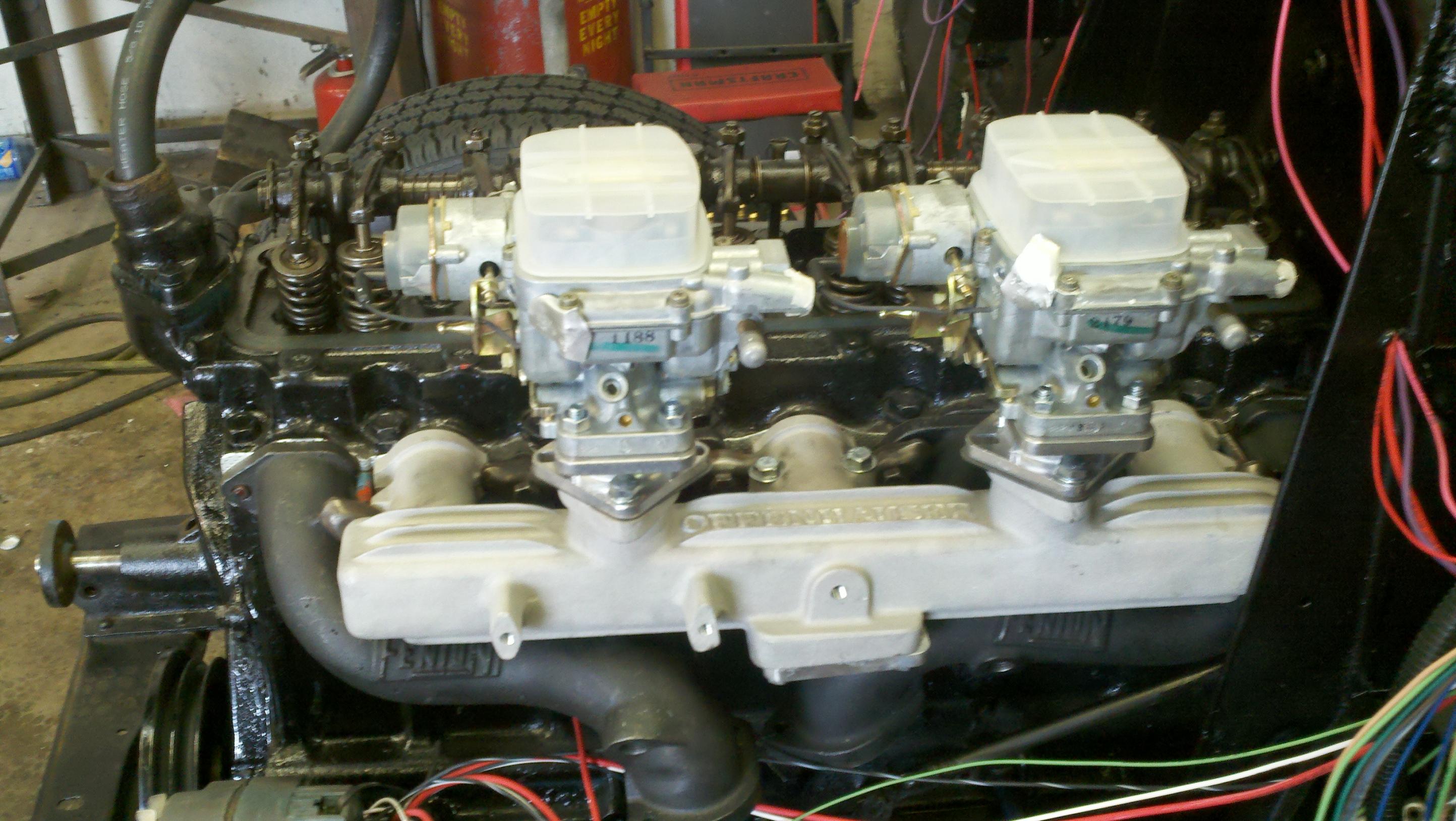

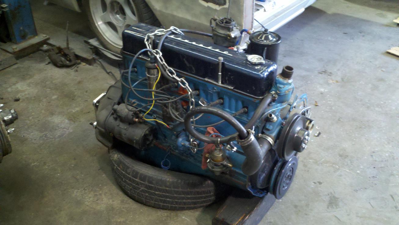

The old girl already had a rebuilt 235 from a '60 chevy installed, so I went with that. Added a big cam from Patricks, an Offy side cover and manifold, twin carter/webers from Langdons and a Langdon's HEI. I really want turnkey reliability so I can drive this sucker daily...or most of the time anyway.

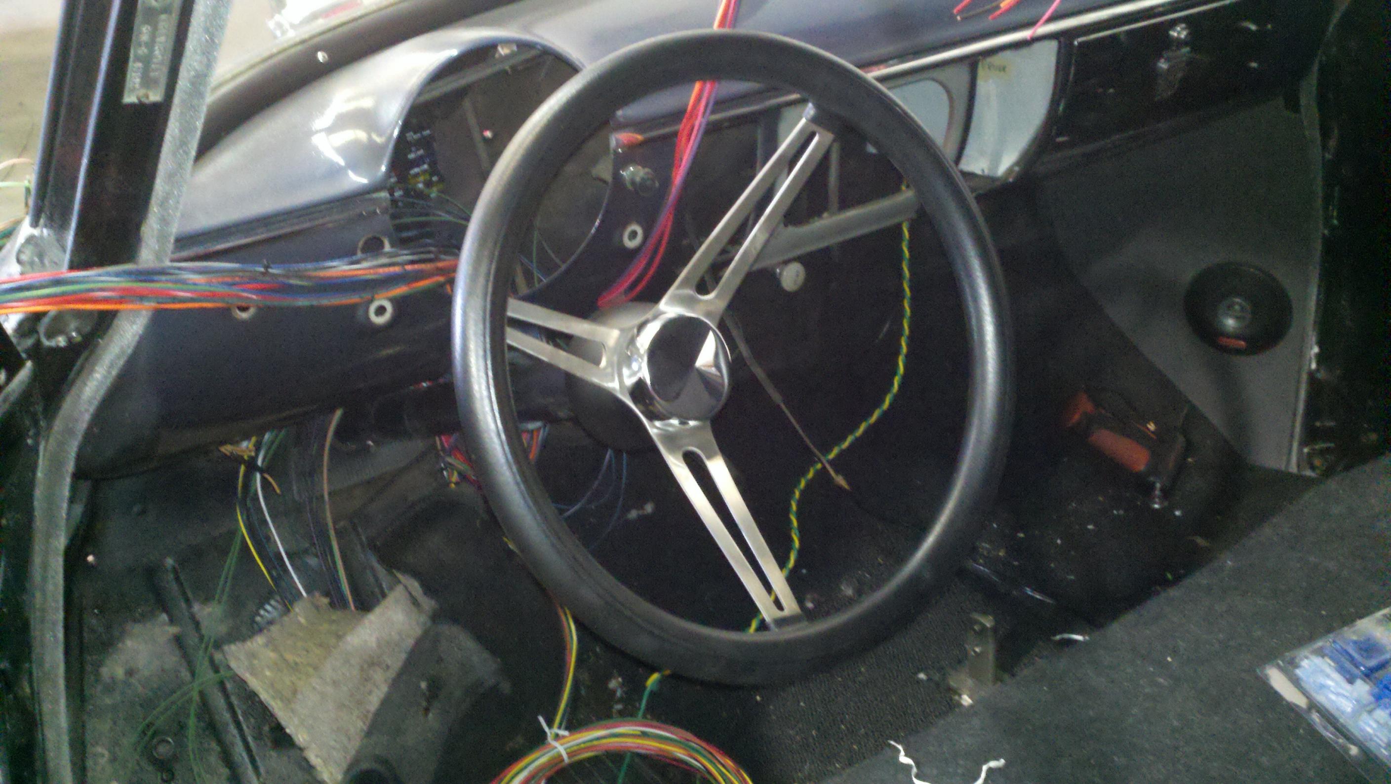

My car had been converted (sort of) to 12v. There was a ton of stock wiring still in the car, with insulation coming off everywhere. It had a 1.8 amp draw that I literally couldn't find. SOOO, I decided to rip it all out and start over with a Painless kit. I guess I am a glutton for punishment.
