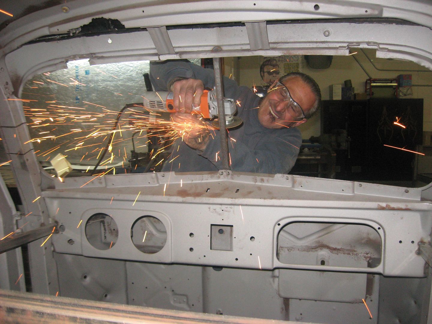

    we had 3 cut off wheels going so we were haulin ass we got to cutin on the a pillars and the back of the cab makin sure we left a tad bit of metal so every thing stayed a \tached until we were ready to remove the top
    we desided to remove the back window be cause there was some riot we need to fix on the bottom channel

    ok now with the top off we can cut the metal were removing from the a pillars and the back of the cab

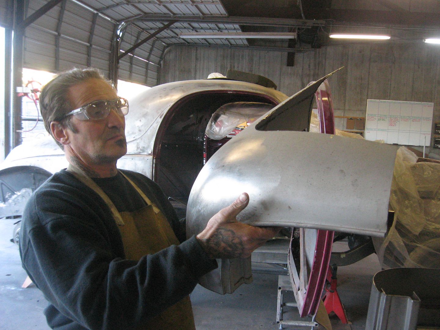

    ok were there the driver side cab corner is off

    ok heres a pic with bolth corners gone before we cutem off we put in a suport to hold up the top

    heres the cab corners
    getting all the burs left from cutting cleaned off
    heres the corner clamped in place

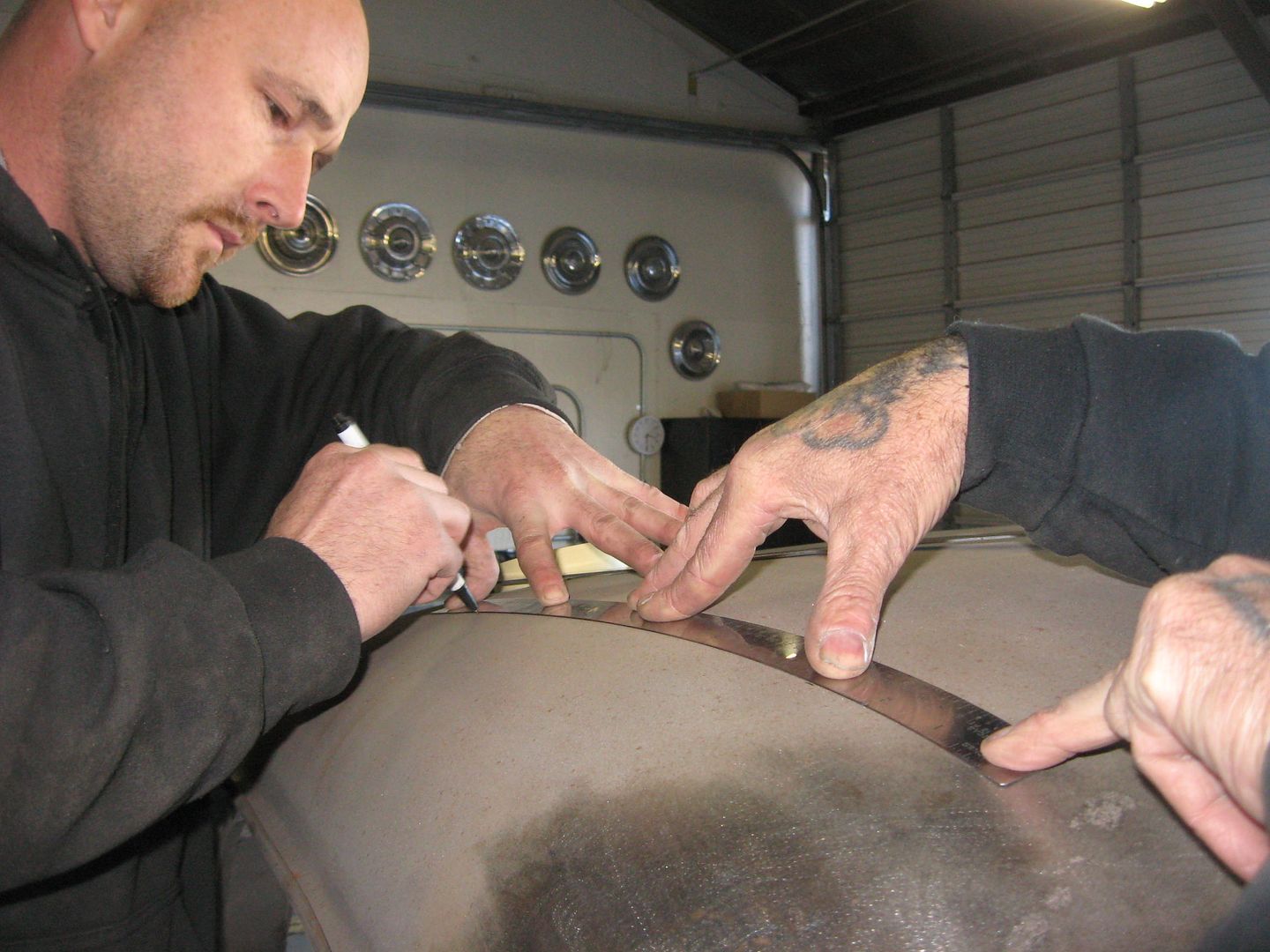

    ok now we can make some filler pieces for over the door jambs area on the top side of town
    drip rail included
