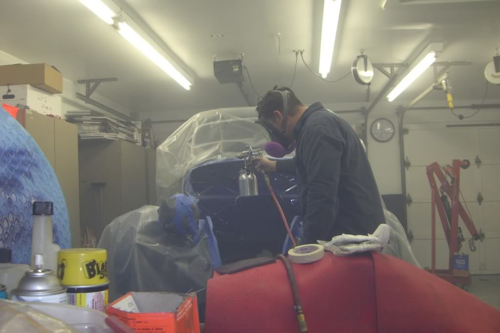

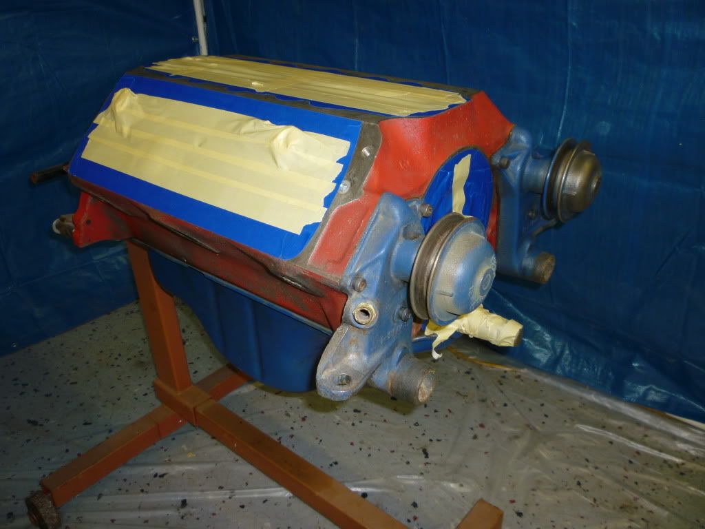

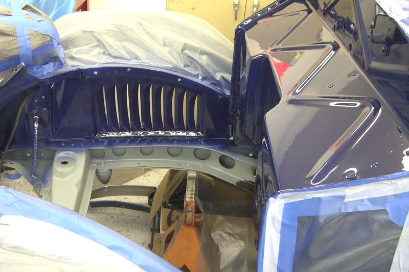

    The firewall was my first attempt at painting, and it turned out well, so I turned my attention to that ugly (but patriotic) motor. I also found some pretty decent 16&#8221; steel wheels. I debated for weeks on what color to paint the motor and wheels and finally settled on gold.
    In this mock up you may notice I swapped out the 8BA Offy heads for some early style Edlebrock Block letter heads. I also picked up a couple of 97s.

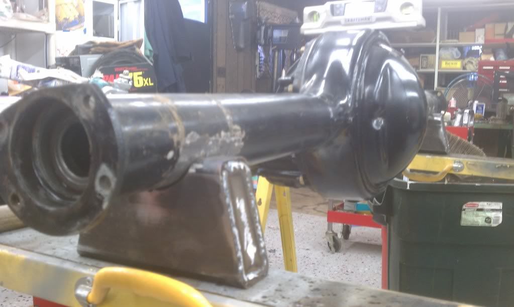

    Since I now needed an open drive, I decided to ditch the stock low geared and mechanical brake banjo and go with a ford 9&#8221; out of an early Ford Bronco. It has nearly the same width, self-actuating hydraulic brakes, most have a 3:55 gear ratio and an they have an early Ford 5 on 5.5&#8221; bolt pattern. I used a Chassis Engineering parallel kit, that I now regret using. If I could do it over, I would have used my stock 36 radius rods with a transverse spring. I just can&#8217;t get the rear of the car as low as I want it with this set up.
    I mounted it up using lowering blocks, but later made a spring perch using rectangular tubing to lower it 2.5&#8221; without the block.
