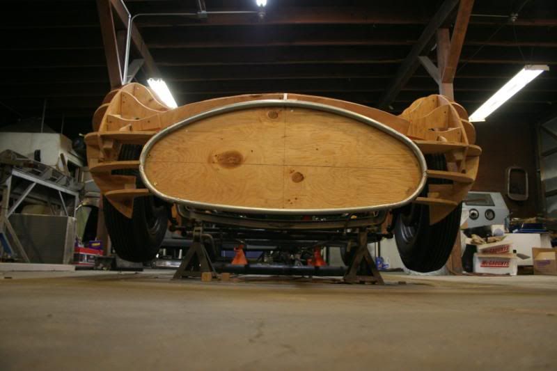

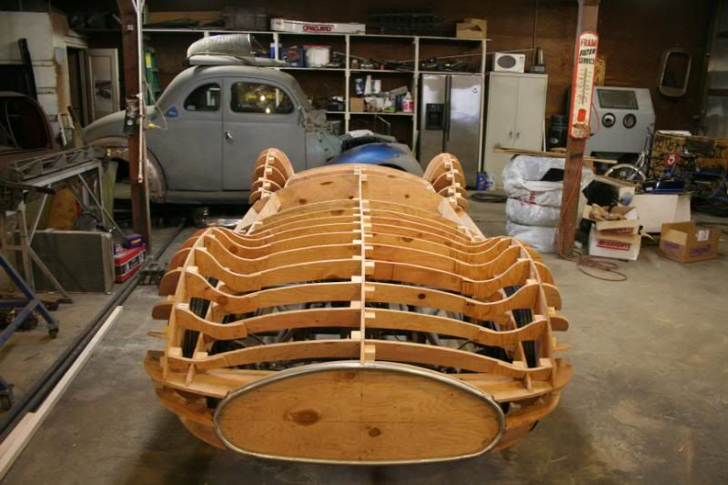

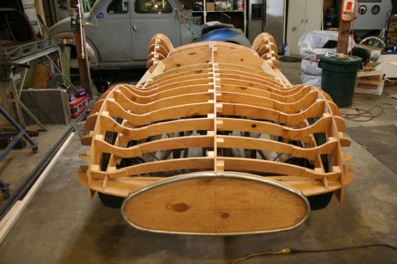

    UPDATE #3 The buck is moving right along and as suspected the front of the car was the most complicated to design. I got stuck on the grill for a few days because I need a large opening to get enough airflow to the radiator plus I want to run fog lights behind the grill. An oval opening is to plain and I really don’t want it to look like a Cobra. My friend Ralph came over and asked if I had looked at any Cunningham’s which I hadn’t. I Found a picture of one online and really like the shape of the grill so I stole the design. After the grill opening was done I got the outside of the fender and the shape of the hood bucked fairly easy.

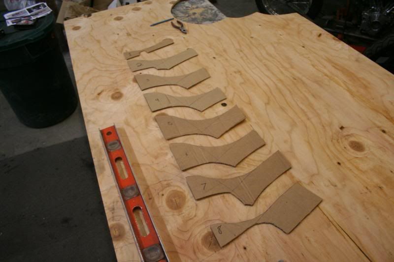

    But then came the challenge of having to transition from the hood to the fender. I had made a few temples out of cardboard and had problems adjusting for the uneven rise and fall of the fender to the hood. Then on Thursday night Kirk came over and it took both of us well over an hour volleying ideas back and forth to solve the geometry problem that let the fender drop into the hood evenly. Once we got the concept it only took a half hour to lay it out. (Thanks Kirk). The next day I transferred all the temples to wood and worked on the transition from the grill to the lower front fenders. I probably have eight hours left in the buck then the task of aluminum shaping can begin.
    As you can see in the pictures I’m going to need a blister to cover the Magneto and Webbers. I could go aluminum but I’d rather make it out of Plexiglas . If you have info on how to blow plexi please feel free to post it on here Thanks!<p>[​IMG]

    Looks great! Will it have body work between the driver and passenger (as in a D type) or is the central piece of wood to line things up?

    the wood is to line it up, but I do plan to run a spit like the D type

    So will you have a removable panel over the passenger well?

    Yeah, the last bits for the front fenders were one of those geometry problems that you need two brains for. Once we figured it out it was one of those "duh" moments that seemed simple in hindsight.
