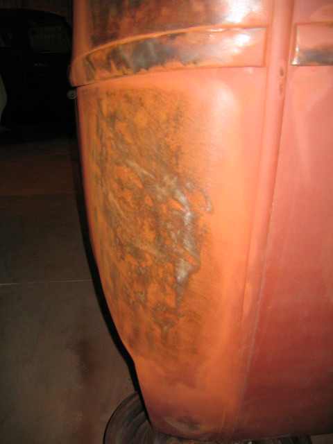

    Moved it to our shop finally and was able to start work on the body.
    Started with the big ole dents on the rear and moved to attempting my own body work. LIKE I said before. All of this is trial and error and reading as many articles via the hamb and google about the topic....

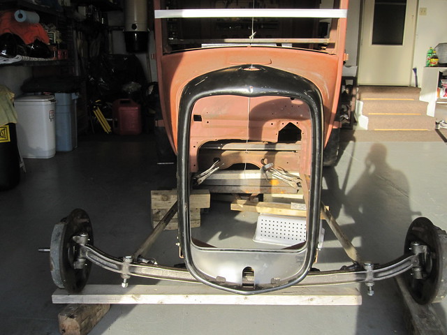

    Ended up moving the project home for a bit and was able to work pretty hard on it which brings the progress up to date.
    Front suspension with grill shell checking fit with spring and axle.
    How I resolved the front spring perch. I ended up making a set of bushings to accept the tapered end of the perch rather than machining the perch itself. The idea was to save that bit of taper for added strength to support forces applied to the perch.
    Perch holes drilled and bushings test fit with front suspension entirely mocked up before initial tac-welds prior to final welding.
    Tac-Welds all in place and assembled prior to being final welded and burned in real good with 220 Mig.
    This is the desired angle for the wishbone but I'll probably have to mount the rod ends a few inches below the rail rather than immediately on the rail once the tire rake comes into a more accurate measurement.

    You do some very nice work. One thing I want to mention is make sure your spring perches are far enough apart so the shackles are at about a 45 deg. angle when fully loaded. I know a lot of people that overlook that and think long and hard before you do your chop. I've got one buddy also sentimental of his T now considering adding a few inches back to it.
