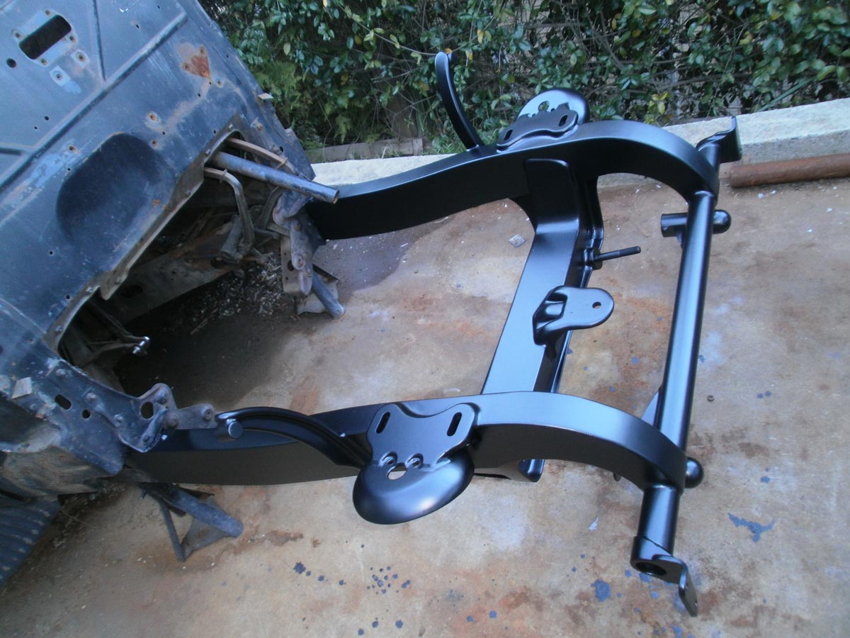

    So, armed with this knowledge I cut off the frame at the firewall, bought a bunch of flat steel plate and proceeded to scratch build a new front frame.
    here are some photos. . . more description and photos of the finished frame in a minute

    First I swept the rails up from the firewall in a nice arc. The rails are made just like the flthd 31 tech . . four pieces of flat steel for each cut into curves, clamped and welded together to create a contoured piece. I love the curve of a ’32 rail but I won’t be building a highboy anytime soon so at least I can know this nice shape is under the fenders on my custom. The new rails are internally fishplated to the stock frame at the firewall. . . it's a little tricky but it can be done.
    One thing I hate about MII’s is that “hat” design that sticks up above the rails, so I swept the frame up high enough to allow the upper arms to connect to a steel plate that sits right at the top of the rail. Those dog-bone shaped plates are ½” steel cut with a 4” grinder. I don’t have a plasma cutter but with this one project I could have bought one with what I spent on 4” disks. In front of the crossmember the frame curves down to pick-up the strut rods, bumper brackets, and hold what looks like a spreader bar but is also a sway bar sleeve. For the crossmember itself there are no straight lines and it’s made the same way out of plate cut into curves and welded up. The shock supports and sway bar arms are made with plate and bent round rod that outlines the edges and gives them dimension like a cast part has.
    Anyway, dig it or not. . . It’s a fendered car so it really only matters to me . . . and it was fun to build.

    Beautiful work.

    Wow dude, the fab work is fantastic, one of the nicest IFS ive ever seen. honest.

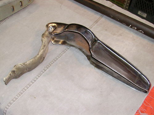

    I said the rear frame was next but this little side project was on the back burner for a long time and it just came together-
    tail-lights
    I like seeing the fenders in 30's cars without tail-lights. . . and the olds
    has this nice peak that matches at the trailing edge of both the front and rear
    fenders. . . tail-lights kind of take away from that. About 5 years ago I started searching for bumper guards to mount the lights in.
    The bumper on this car is a nice thin shape so most guards look too heavy. Then I came
    across a 30's Packard fold down center guard off of a sedan (folds down to open
    the sedan trunk. It's a weird clunky shape but with a little trimming. . . and welding.
    . . and more trimming . . . and welding. . .I thinned it up, filled in the back side and added
    a round knob shape to the top. Oh . . . and then I had to find a matching one and do it again. All of this shaping was done by beating the crap out of thick pieces of steel on an anvil. I cut out the centers for taillights and went on the hunt for some glass lenses that fit. . . so for a long time I was going around and tapping on lenses on every old car I saw and eventually found 60's mini cooper lenses that fit just right. I shaped and polished them to the best of my ability and then went looking for a chrome shop.
