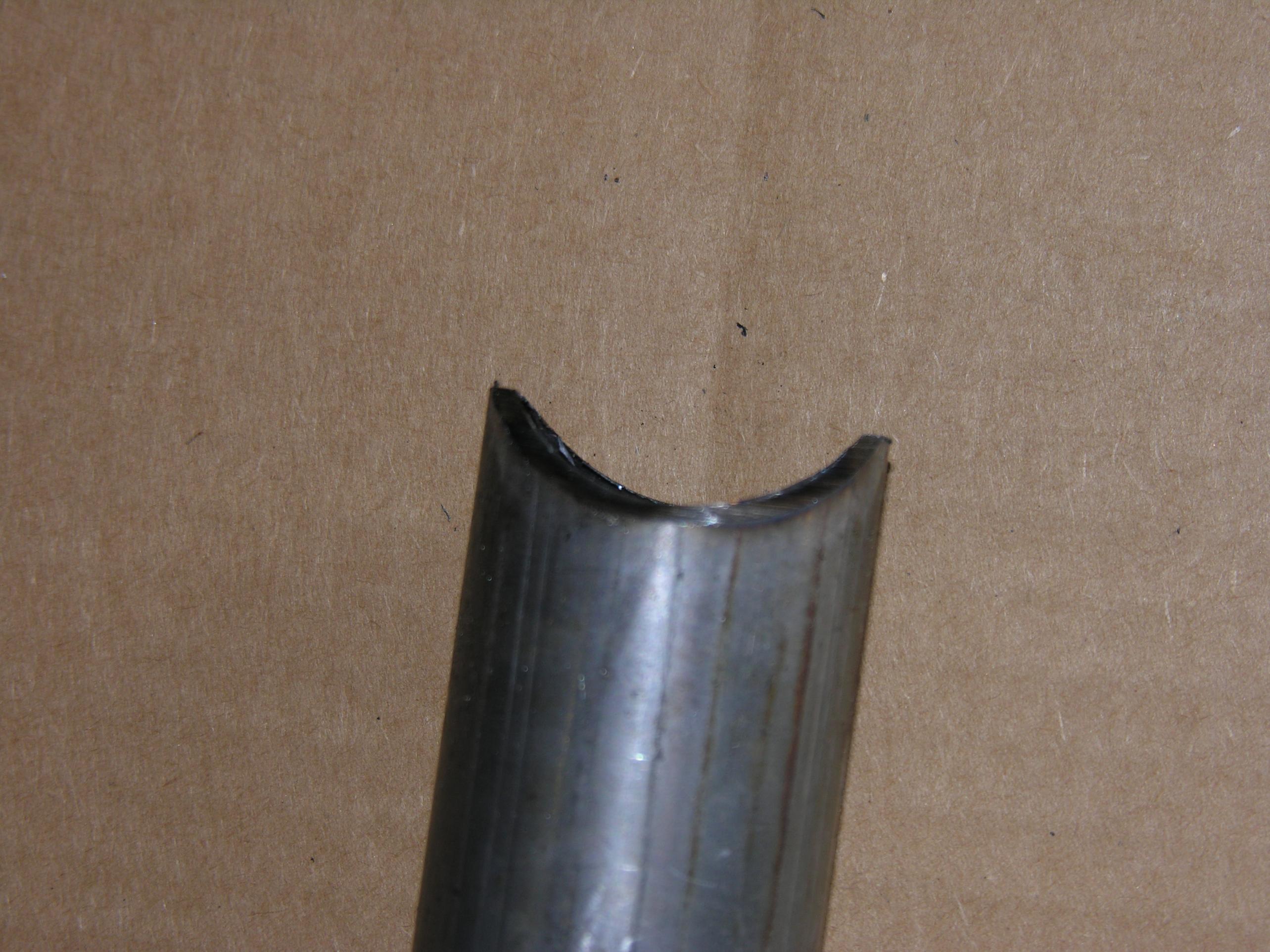

    This is a trick that I have been using for more than 30 years and thought it would be a nice X Mass gift to all my fellow Gear Heads. You don't need any special tools to make a perfect fit to weld 2 pieces of round tubing. All it takes is 2 straight cuts at about a 45 degree angle leaving a little less than 1/3 of the center square on the end. I know it sounds strange but it does work. here is a picture to show what I an trying to explain. I made the cuts with my band saw.
  2. wizardfab
    Joined: Sep 15, 2006
    Posts: 27
    wizardfab
    Same tube side view.

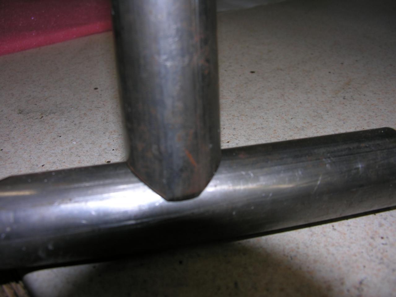

    this is the fit, don't have time to weld now but will soon

    It also works for tubes that are not 90 degrees to each other. Once you understand it you can experiment with the angels to make it fit. I used a disc sander for this one, took less than 1 min

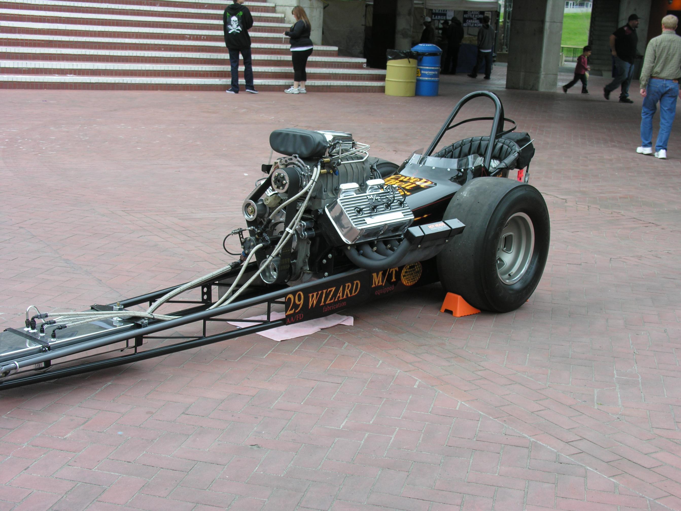

    Wow are you talking about the Don Long that built top fuel cars? The reason I ask is that we have a 1969 Don Long car that we saved and take to a lot of shows so people can hear it roar.
