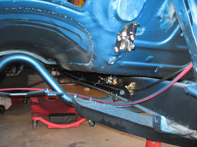

"Fabricated" MAP sensor bracket. Had a pc. of 16 ga. scrap that was about the right size, drilled mounting holes and welded nuts on back side. Welded bracket to center dash brace.
Screwed MAP sensor to bracket:
MAP sensor replaces mass air flow sensor from original setup. Says to mount higher than engine. Note vacuum port facing down.
