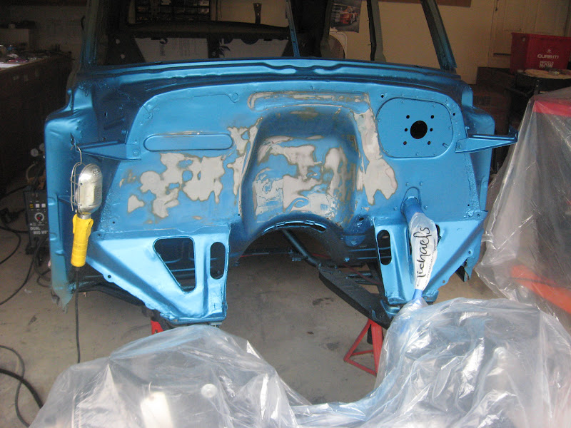

It's like watching paint dry . . . but this is the state of things. Re-worked the cowl (sand, bondo, sand, paint) yet again, then yet again. My paint & body skills are pathetic. But dagnabbit, I'm learning.
Paint & Body 101 at The School of Hard Knocks. (The professor doesn't seem to know much):

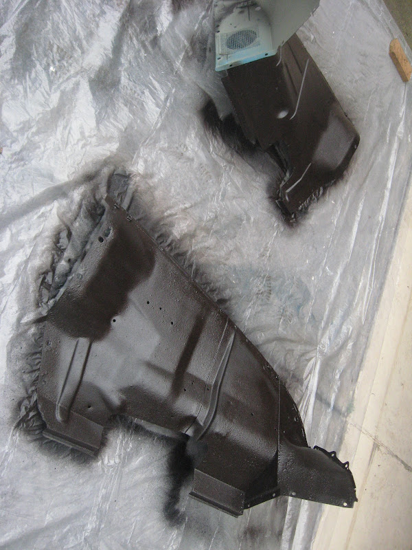

Sprayed Rubberized Undercoating on tire side of inner front fenders. Had used Eastwood on underside of body floor. Ran out and found some 3M at the local parts store (1 can). It was good and black just like the Eastwood. Ran out, all I could find was Duplicolor. It is brownish and has bubbles, very disappointing. Stick with Eastwood or 3M.
