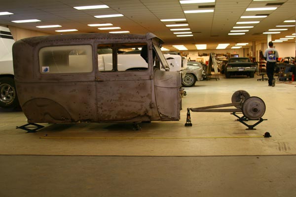

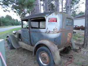

    Hello My name is Curt Lout I was a student at Hot Rod Institute in Rapid City South Dakota. Here are some photos for the 29 Model A sedan build in progress. I found the car on craigslist in Wisconsin so i named her "Rusty Cheese

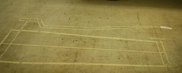

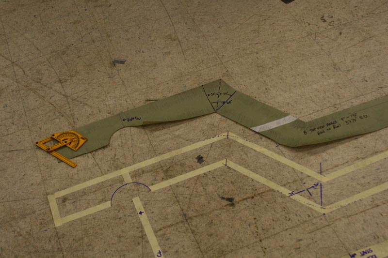

  5. Rusty Cheese
    Joined: Oct 11, 2010
    Posts: 336
    Rusty Cheese
    Frame design in progress

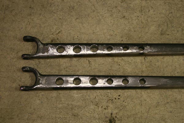

  6. Rusty Cheese
    Posts: 336

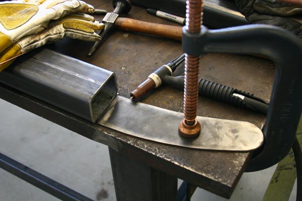

    Rusty Cheese

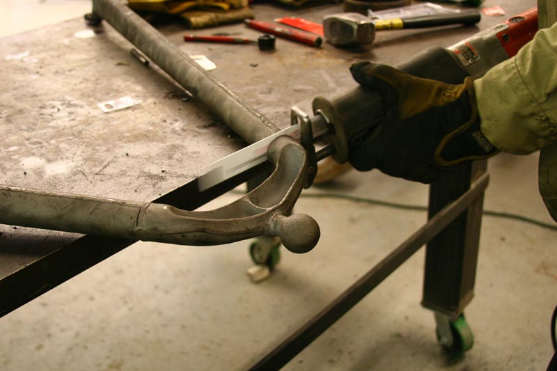

    Splitting the wishbones

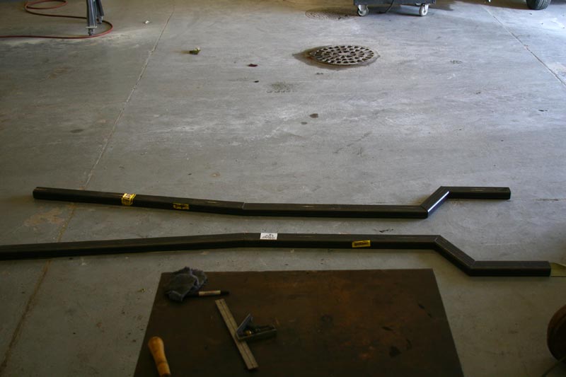

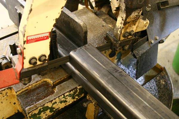

    Rusty Cheese
    Got the the rails cut, ready for the frame bench...

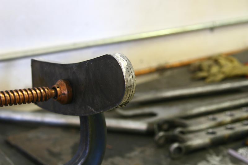

    Frame horns, design and cut-out.

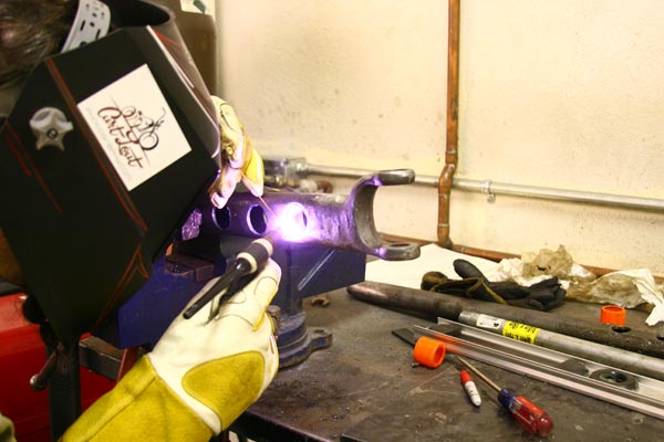

  9. Rusty Cheese
    Posts: 336
    Rusty Cheese
    Welding up the frame horns.

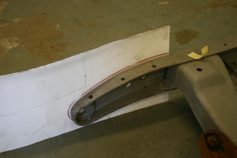

  23. Rusty Cheese
    Posts: 336
    Rusty Cheese

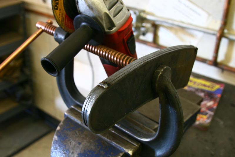

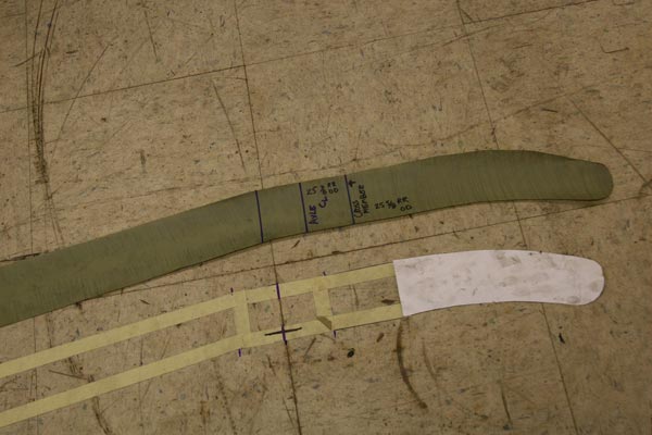

    Frame Horn Fun.
    I used the stock frame horn for a pattern.
  24. Rusty Cheese
    Posts: 336

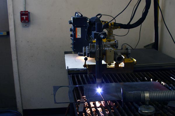

    Rusty Cheese

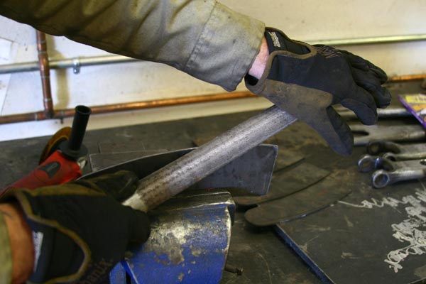

    Plasma cut then knocked off the slag.
  25. Rusty Cheese
    Posts: 336
    Rusty Cheese
    Tack weld them all together so i can grind them all the same. Finished off with a little bit of filing.
  26. Rusty Cheese
    Posts: 336

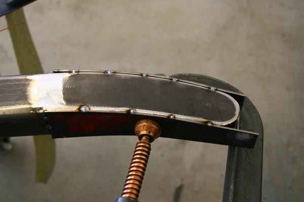

    Rusty Cheese

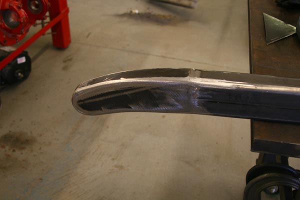

    Next I TIG welded the first horn, then flipped it over so the they were both the same and TIG the other rail.
  27. looking good

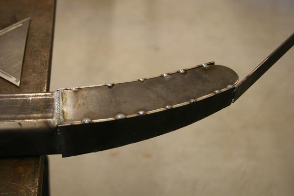

  28. Rusty Cheese
    Posts: 336
    Rusty Cheese
    Strap on the top and bottom were tacked into place. The curve was tacked, heated red hot and bent around. Kinda hard to run a torch and take photos at the same time...
    You can also see how the horns were pinched.
    One down and one more to go...
