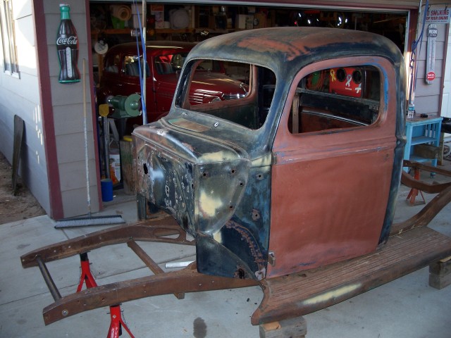

    I have been working on this pickup project off and on for a couple years. I just recently decided to get a rolling frame before the snow falls. Here are some catch up photos of what I have done so far. Please don't post until I have a chance to post a few of my photos.
    I'm doing this project with out a complete truck to start on. Here is the beginning by buying a good cab.
    This is another cab I bought for the doors.
    Here is a 39 car frame I picked up. Not bad but will need some work to repair a little side rail rust.
    Instead of the stock dash I cut the old out and fit a 40 car Deluxe dash to the cab.
    40 steering column I had chromed.
