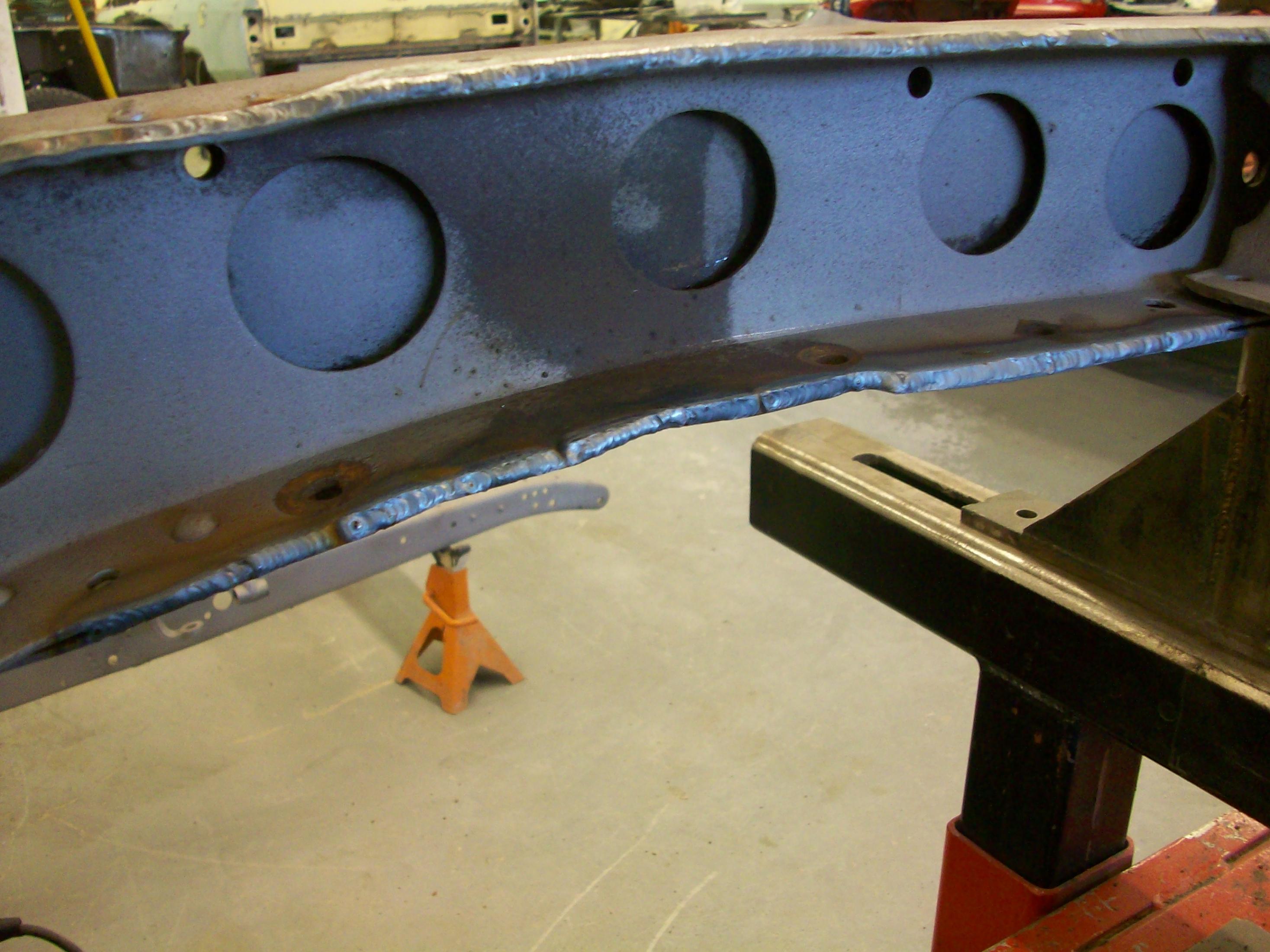

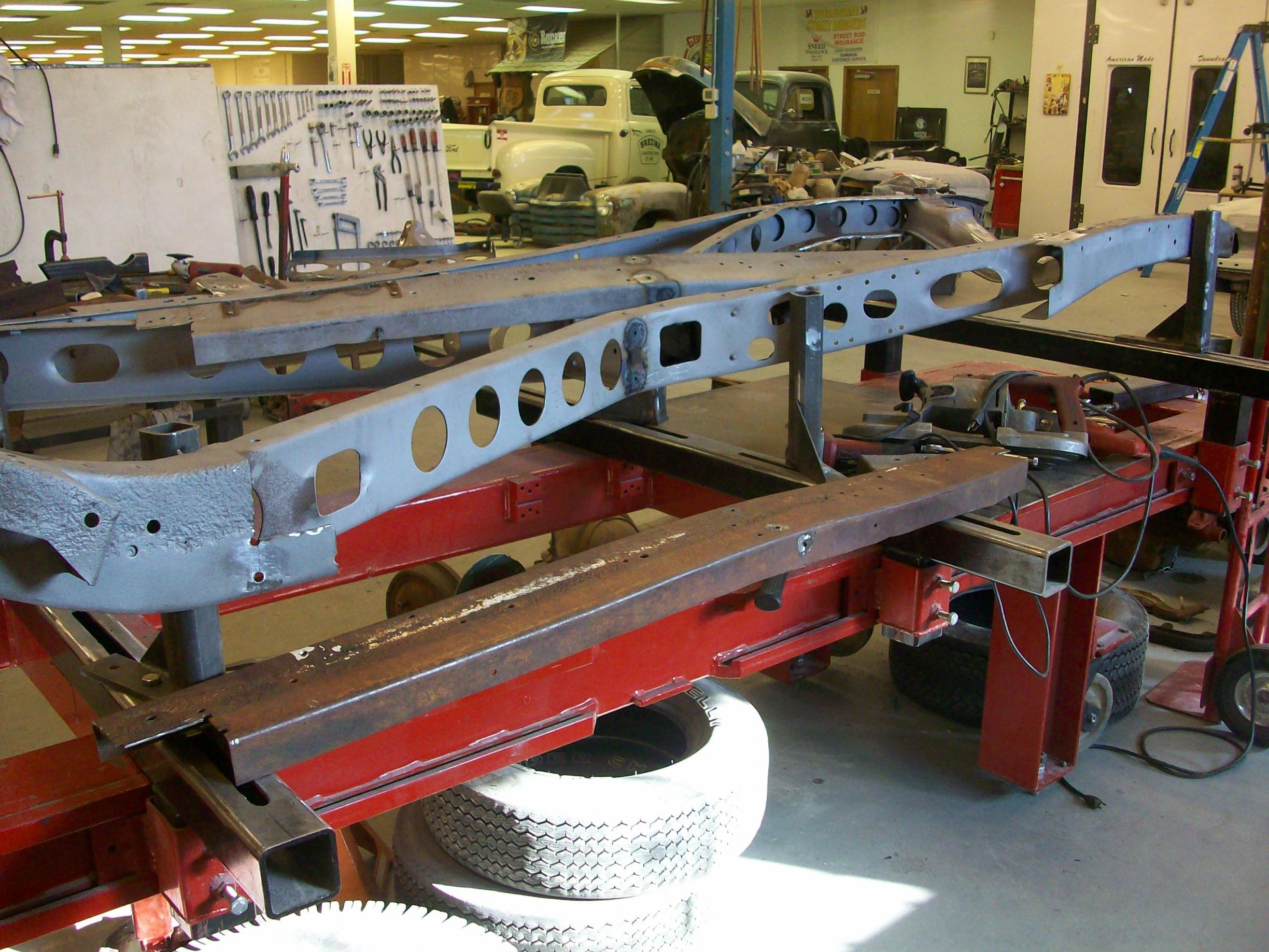

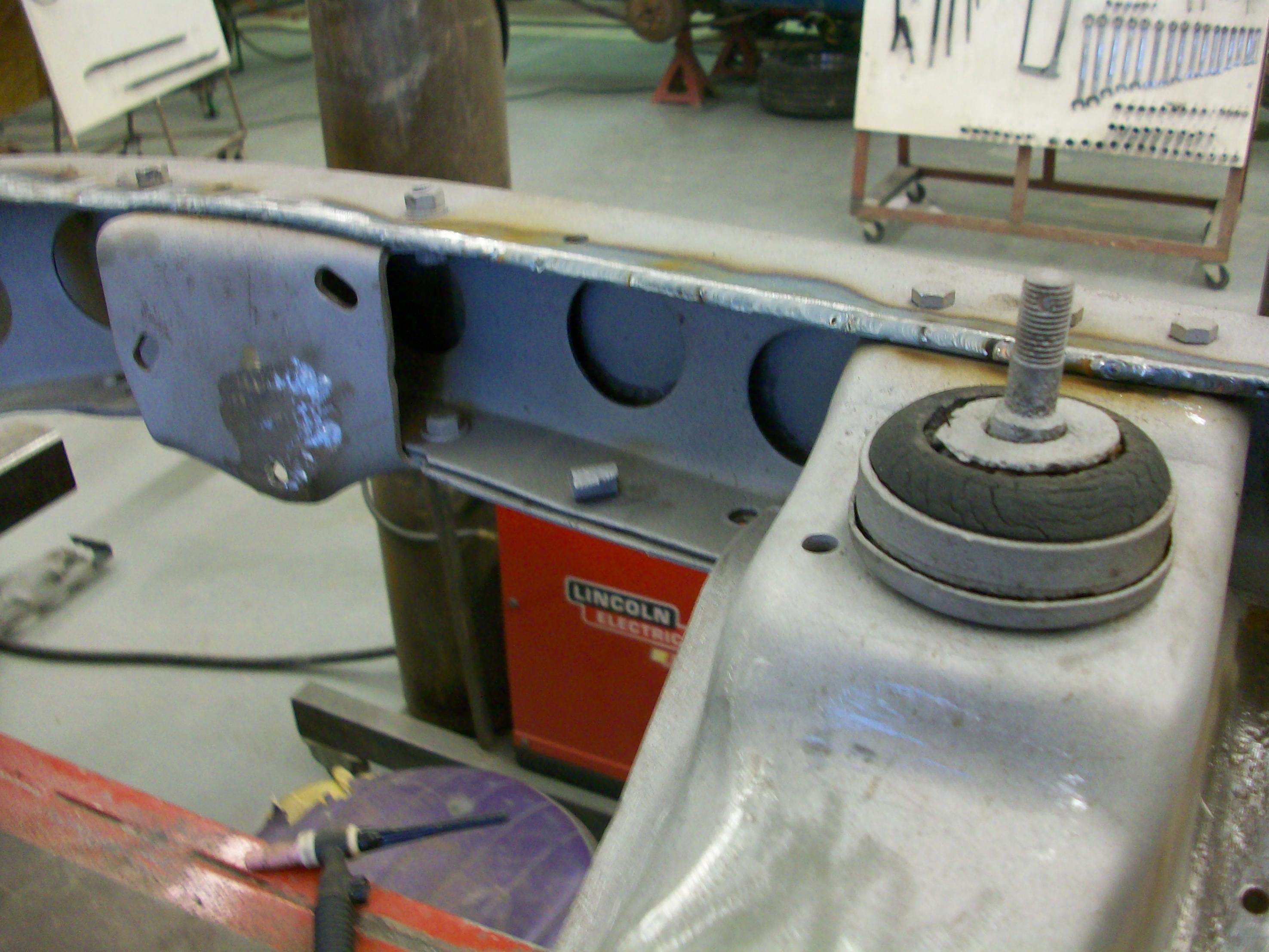

    Some of you may remember when I posted the story of how I got this car which was here http://www.jalopyjournal.com/forum/showthread.php?t=400929. Now I have started on the car. I am going to school at the Hot Rod Institute in Rapid City South Dakota. I first got the frame sandblasted. Then I got it up on the frame table close to the ride height I would like to have. First thing I did was patch the front crossmember. Then I started to weld the frame rails together where the X-member meats up with the rails. Thats where I'm at at this point.

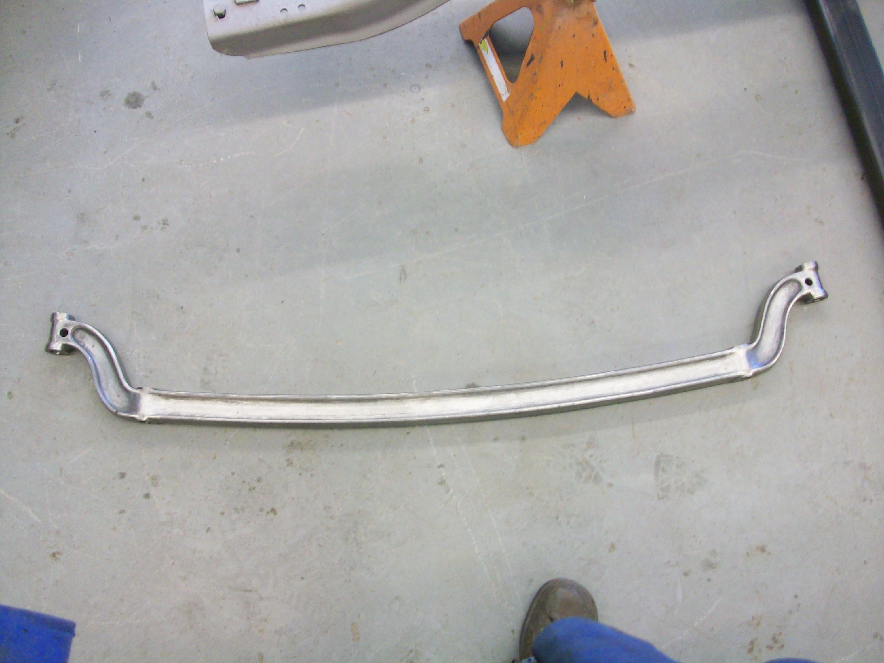

    Today I got the new axle milled to fit the original wishbone. I welded up the u-bolts for the front spring. I also TIG welded more of the frame.

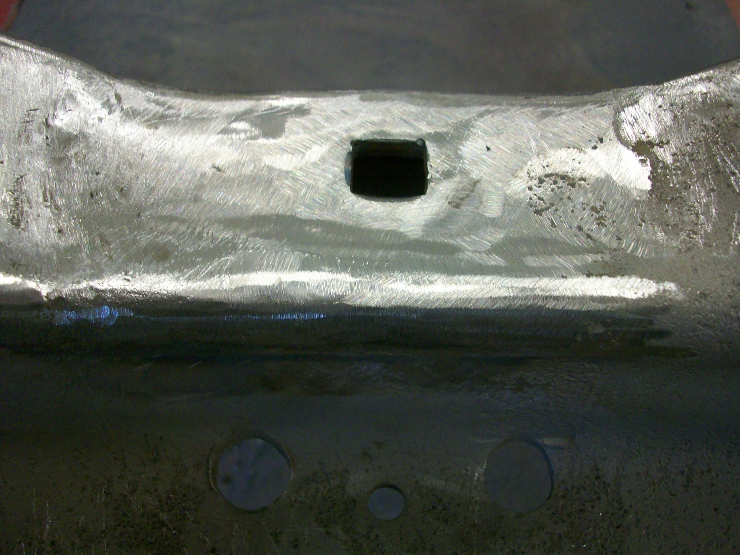

    This morning I got the front crossmember welded in and I started to smooth the axle

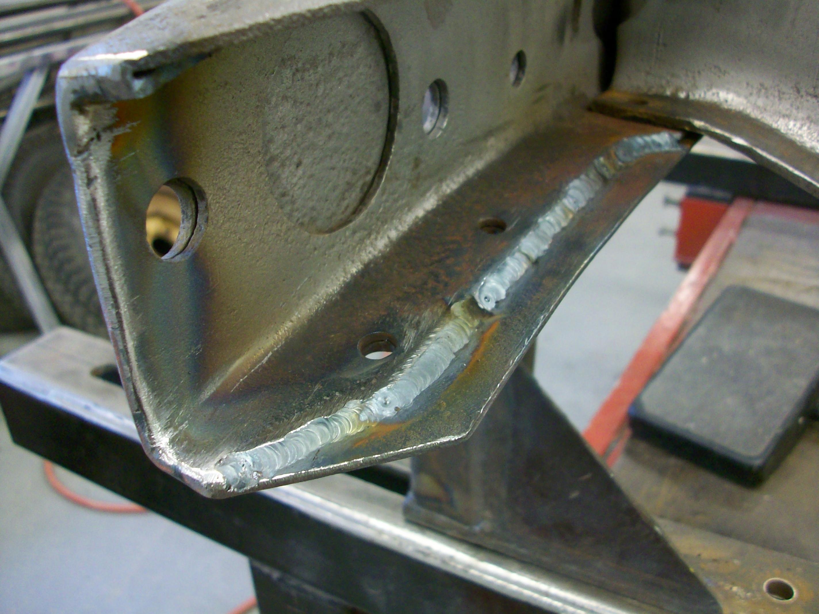

  15. not judging... but why are you welding all the seams?
    just seems like alot of work that doesnt need to be done
    tk
  16. Fomocokid
    Joined: Aug 1, 2009
    Posts: 564
    Fomocokid
    from Rapid City
    It doesn't need to be done but if I have it all sandblasted and I'm doing the whole car anyways I might as well do it. All that is holding it together is 75 year old rivets and we all know that over time rivets can slop out which in this case can cause the frame to flex. In my opinion a suspension works its best when the frame is as solid as possible, which will allow the suspension to do what it was designed to do.

    I finished smoothing out the axle this afternoon. It was a lot of work, but I think it was worth it

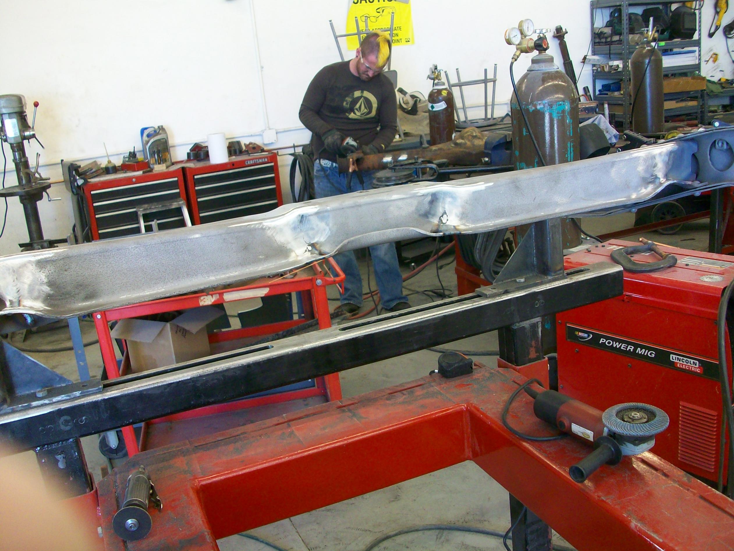

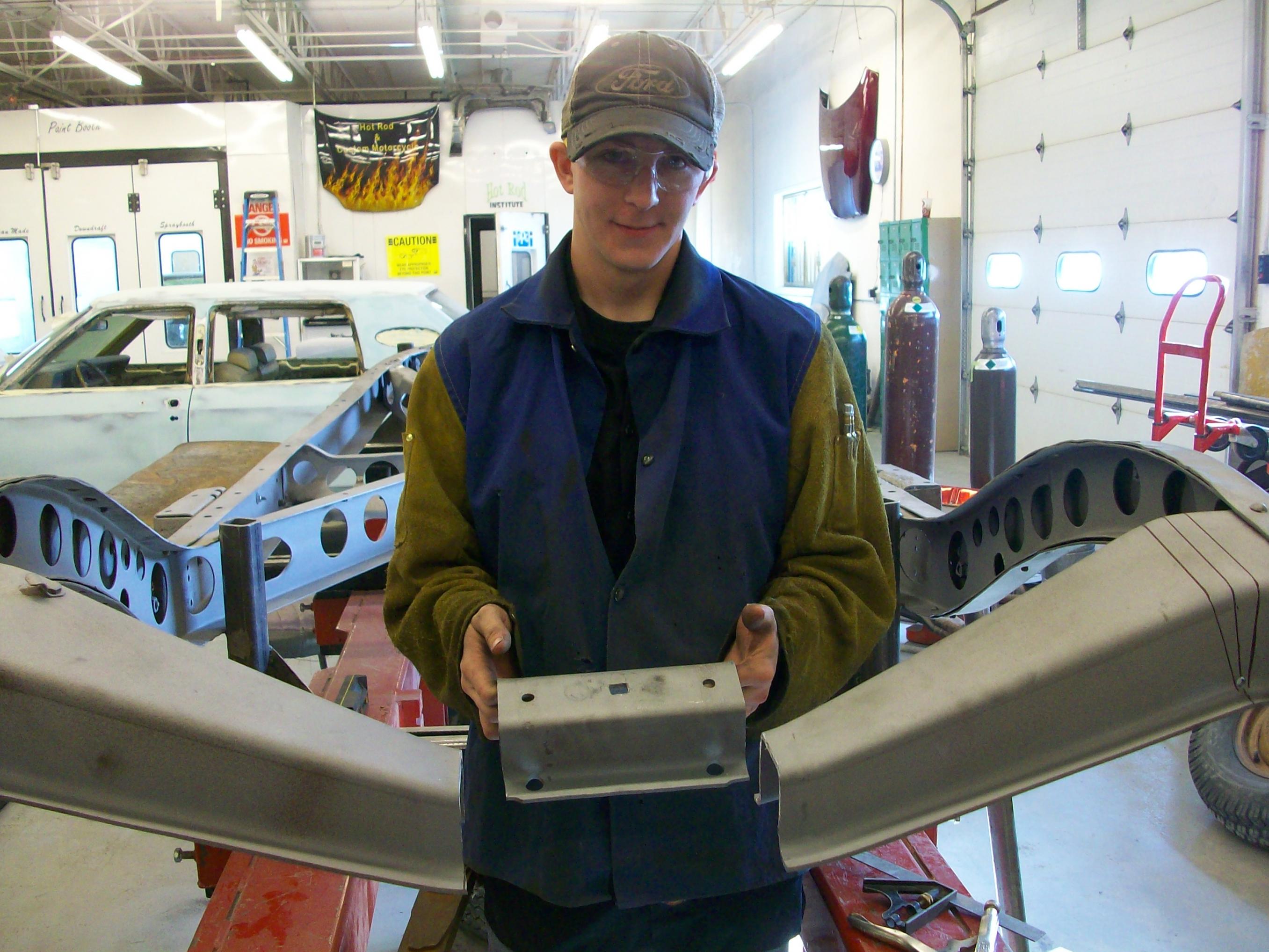

    I didn't get a chance on Friday to post an update but here is what I did. I cut the rear crossmember apart so that I could raise it up. That is me in one of the pics right after I made the first cuts.
    mgtstumpy likes this.

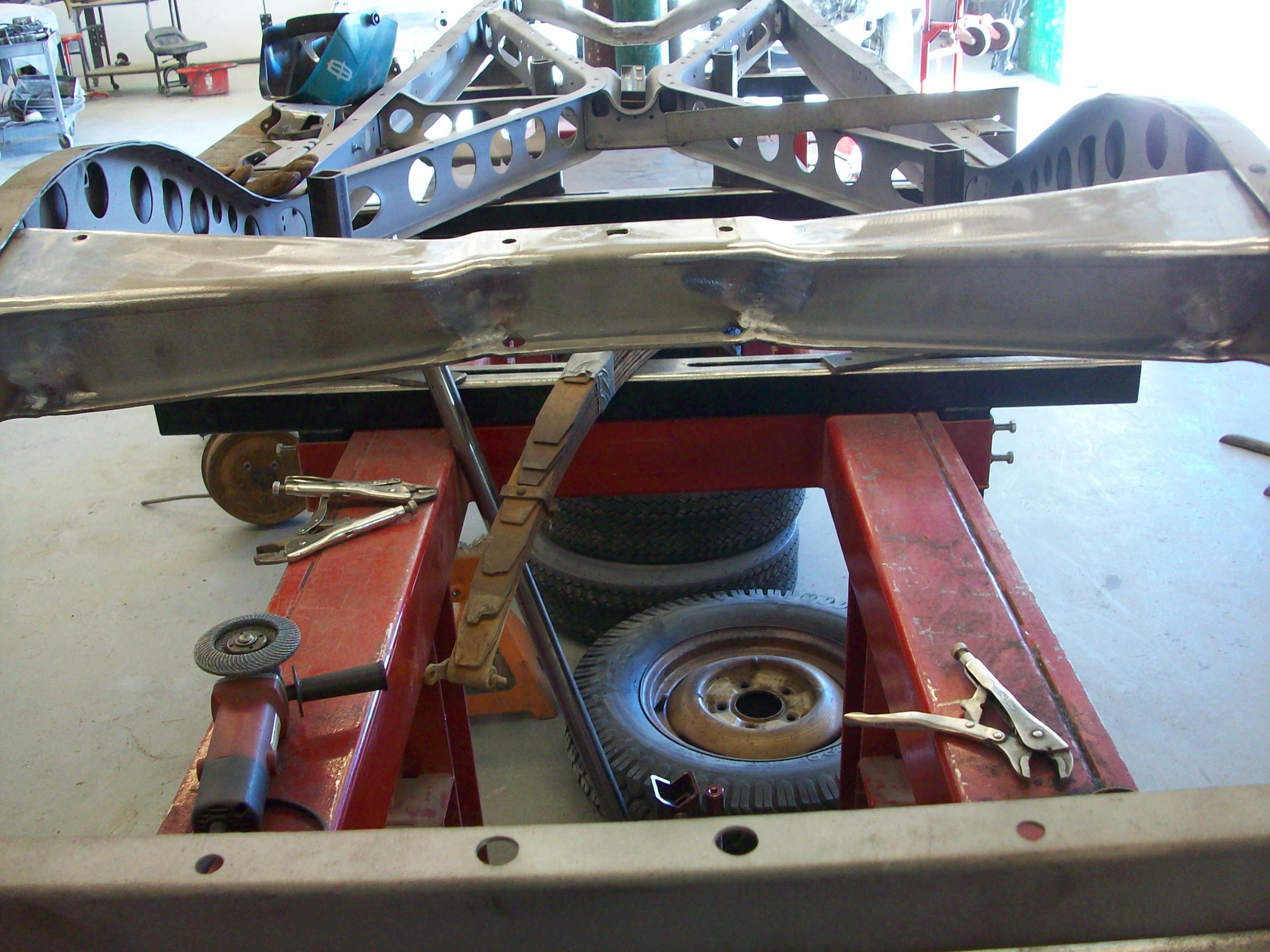

    Today I finished the crossmember and started to weld up the seams on the rear frame rails

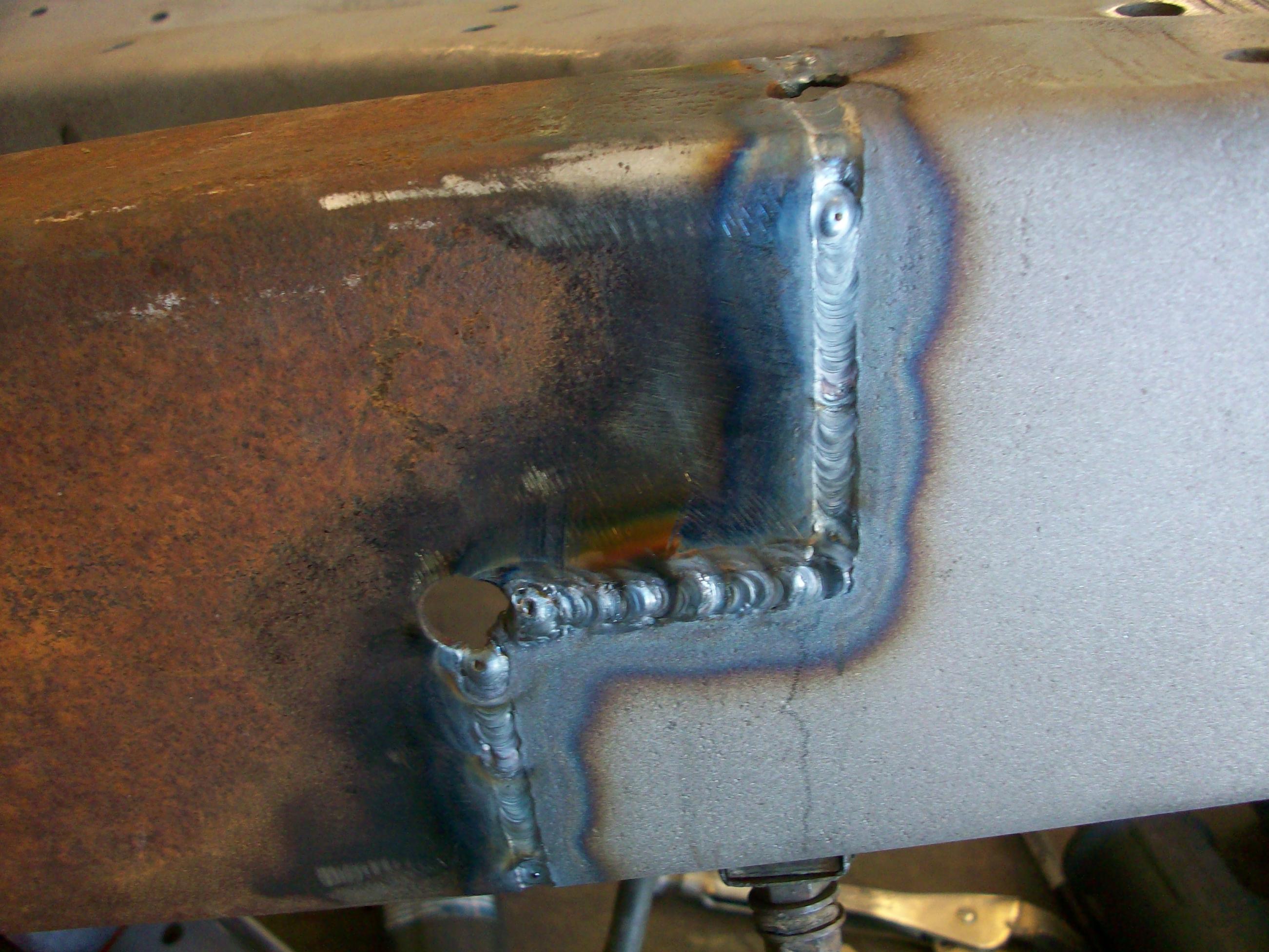

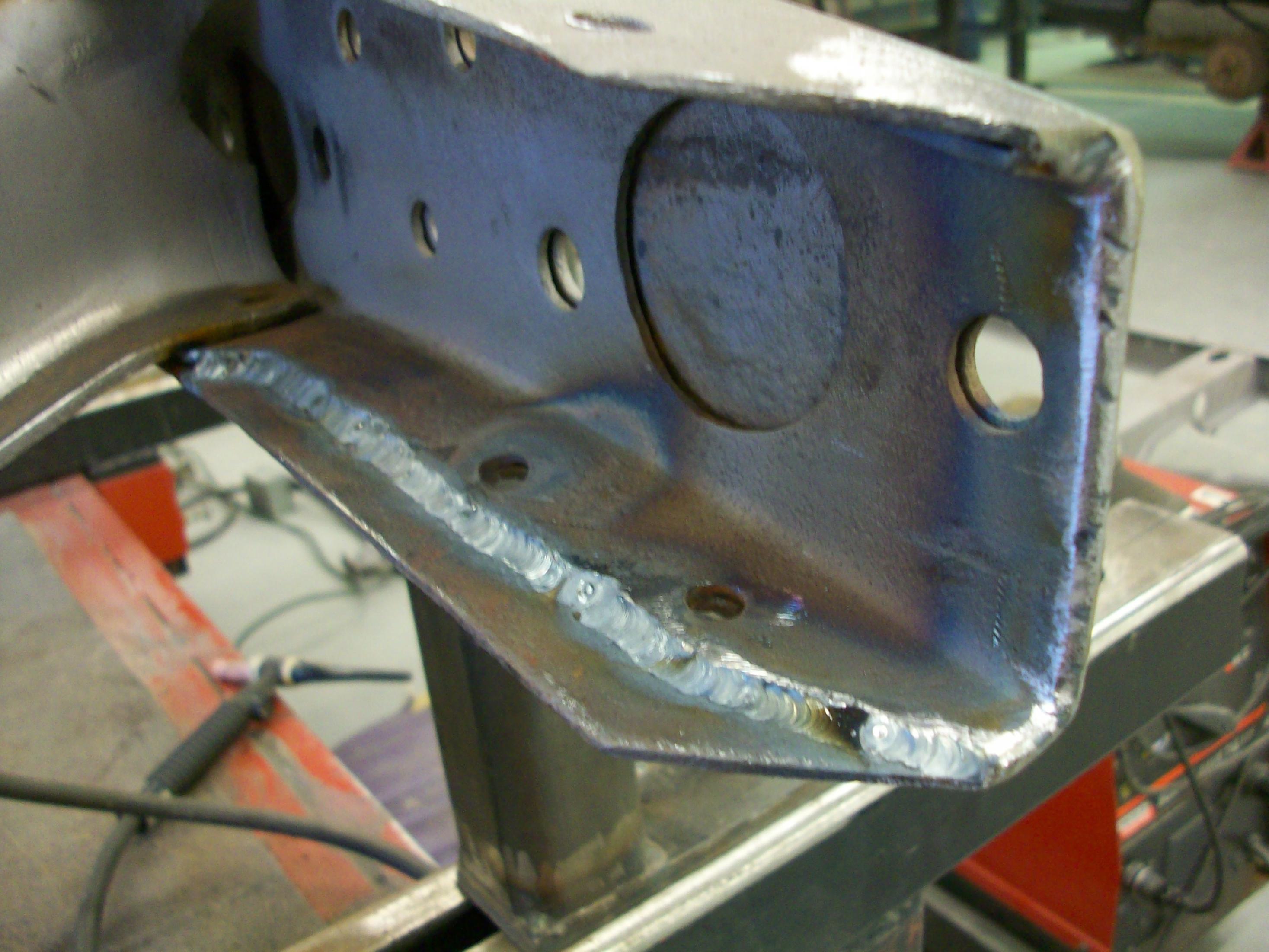

    Today I fixed the frame rail that was rusty. I had another frame that the only decent parts on were the parts that I needed to replace. I cut the piece out with a jog in it to make it more structurally sound when finished. I also had to put another patch in further back. I did a root pass with a TIG and anything that needed to be filled was done with MIG over the top.
    I am very happy that I have a solid frame rail now that is still all Henry Steel.
