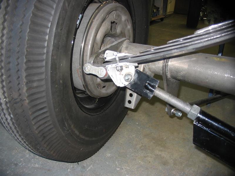

  5. I built a Spring Spreader for my Model A Spring, it works well and is safe.
    HemiDeuce.
