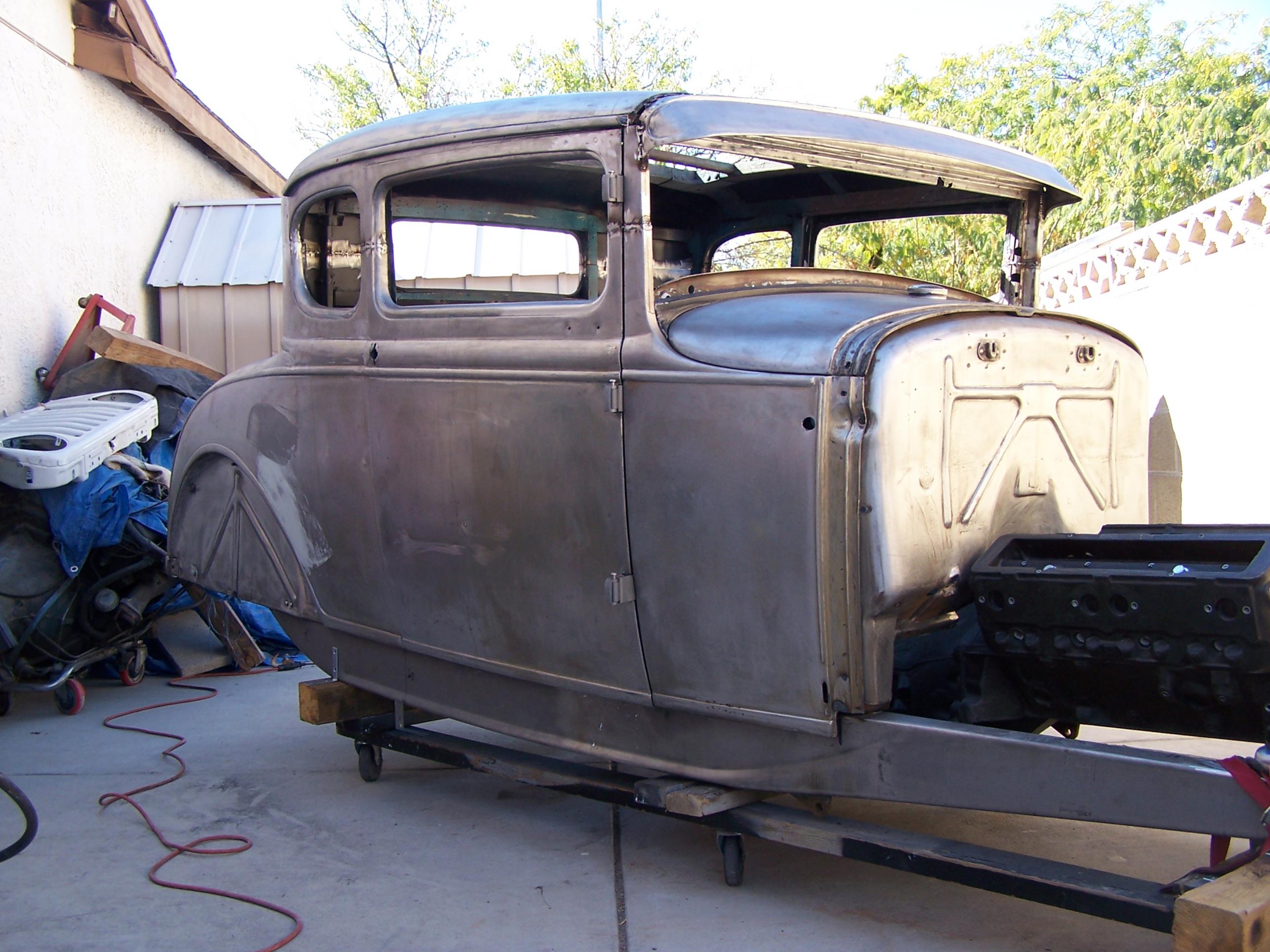

    Chris is building this frame for me and thanks for all the responses so far.
    The picture of the coupe on the frame I found on-line somewhere, can't remember where but this is exactly how I want the channel to look, especially right at the firewall. Most everything on paper deals with the 28-29's which are a little different. We're working on the pinch dimensions now and will post these as well.
