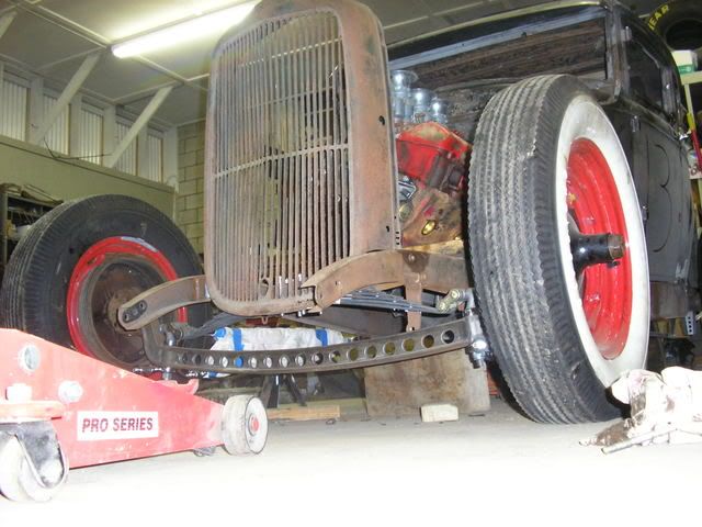

    So far its a 30' 5 window 32' rails 63' 409 w/ 6x2's.
    here is what i started out with
    i made up some braces so that noting moves
    few more pics from the chop
    up front is a C.E 47in dropped and drilled axel with hairpins.

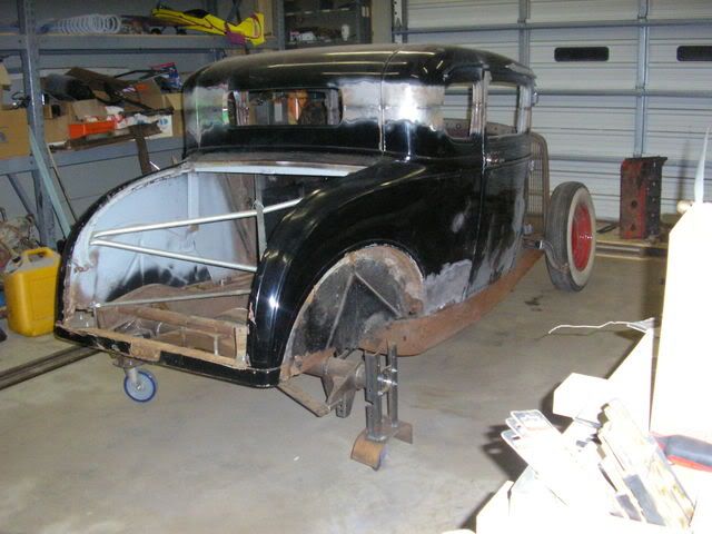

    i started lookin at the sub rail construction and have a few ideas, also i cut out the rear rumble pan and other floor boards.
    to make sure that my rumble lid fits back in, i made up some 3/4 tubing braces to hold the quarters in place.

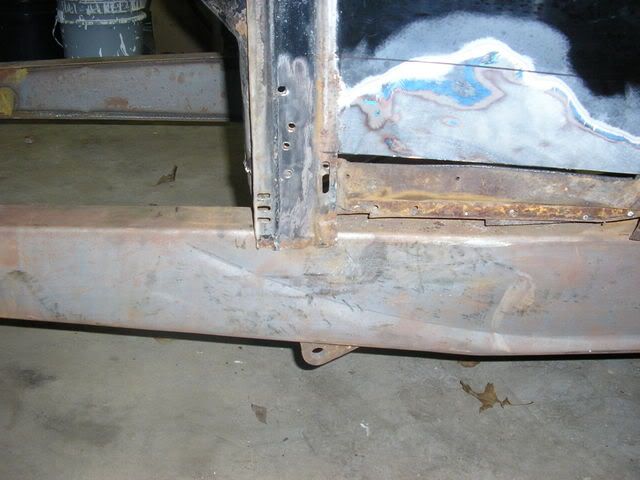

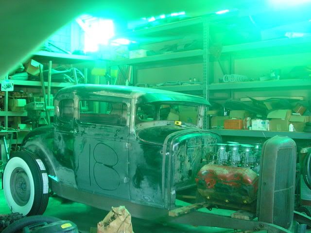

    right now im workin on patch panels and "channeling" the cowl to eliminate the dreadful gap with A on 32' rails
    here is how i channeled the cowl of my 30
    First i cut out the support
    with that out of the way, i could drop the cowl over the frame the necessary 3/4 of an inch to hide the gap.
    The so-cal frame i have is not as narrow as i would have liked in the cowl area, there is a gap between the firewall and cowl sides.
    so i pie cut the supports to make it look right
    I welded all of that up and used the origional support to make the new foot.
    i think it came out ok

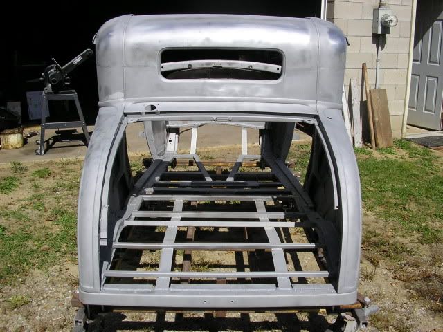

    Decided to tackle the rear subrails today. I needed new sub rails because i used a 32 chassis.
    First i started with 1x2 box tubing around 36'' long
    I made cuts spaced 1" apart.
    The more cuts you make, the smaller the gap of each= easier to weld
    clamped it in place [​IMG]
    Then made cuts 1/2 inch apart on the opposite side
    finished product(except for welding)

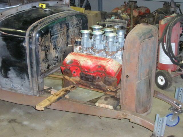

    Got the motor back from being pressure tested and it checked out. I threw it on some 2x4 to get a rough idea of height, i think this is where it will end up. Now i have to cut the firewall to make it fit.
    I cut the firewall and pushed the engine back a little. It might end up further back once i get my water pump.

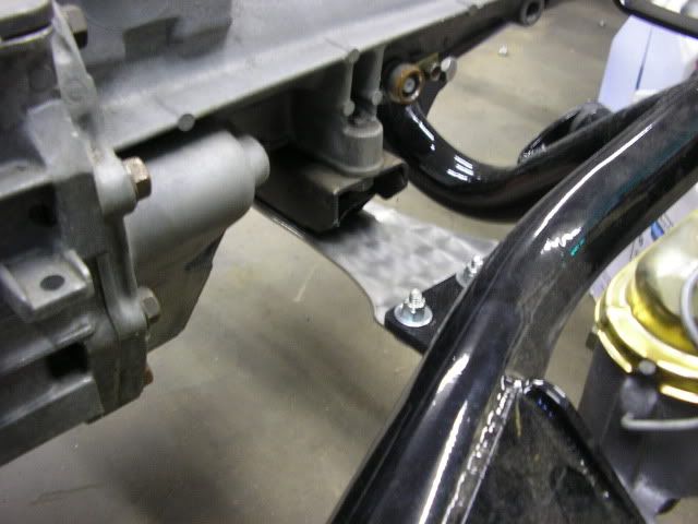

    i decided to tackle to motor mounts. I think they should stand up to the 409, but we will see. Most of the plate is 3/8 and the rest is 1/4. i wanted the motor to sit kind of high so that complicated a few things, but they are coming out pretty good so far. I still need to weld them, and add a wrap-around gusset on the bottom plate.

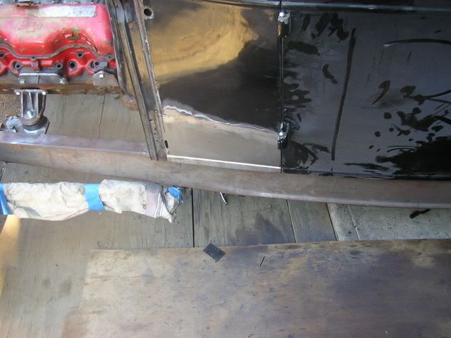

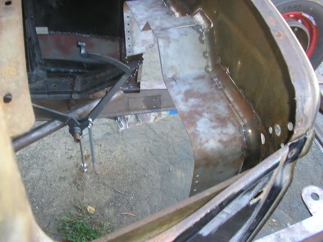

    Worked on putting a new patch panel in the driver cowl.. It came out alright for my first one i think.

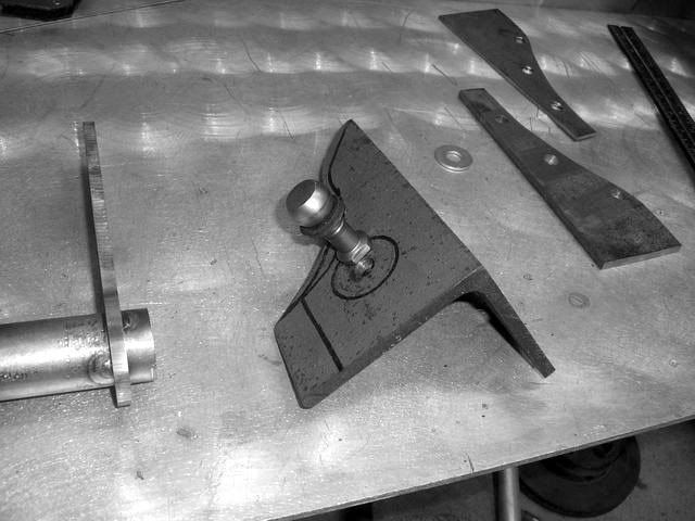

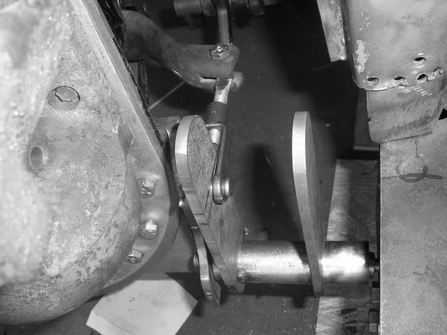

    I had a few options for clutch linkage on my hot rod. I like the simplicity of mechanical linkage, and it was pretty cheap.
    I started out with a DOM tube with a 7/8 id and a wall of 1/8. Then i made two Arms out of 1/4 flat stock. I used 2 GM Clutch Pivot balls for each end.
    One pivot will bolt through a 3/8 plate, attached to the boxed frame.
    On the other end, i pick up off of three bolt on the blow proof bell housing. [​IMG]
    This is what it looks like outside of the frame.
    And Inside
    I used a corvette clutch fork, and a clevis for the fork side. The threaded rod to the clutch for is only for mockup, it will get a real rod later
    And on the pedal side, i used two Heim Joints. This is only a mock up for now, for the real deal, it will get a 7/16 tube and larger heim joints.

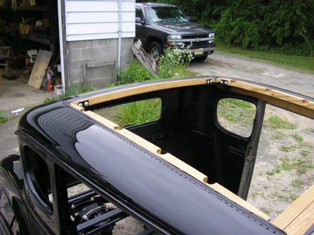

    got my wood kit test fit now im gonna stain it to give it a cool look im gonna run without an insert for a while...
    and i cut in my tail lights...
    got the wood all stained and put in...

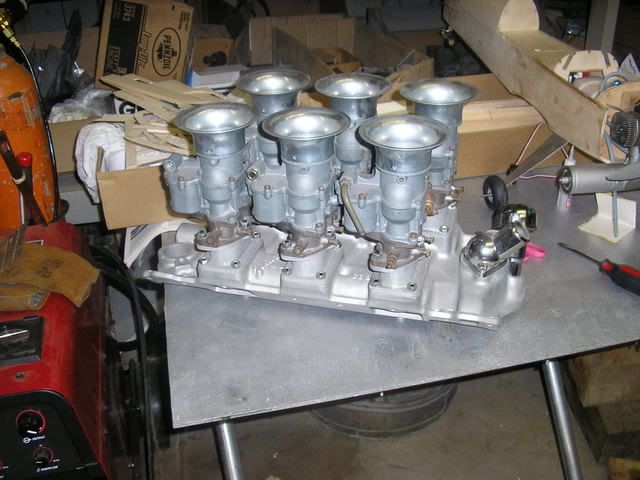

    i Got my carbs from UncleMax...and they look great. Brake lines are done...almost ready to start it up

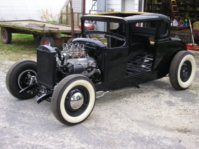

    I picked up the body and am still blown away by how nice it is. Bill is an outstanding painter... Ill let the pictures do the talking
