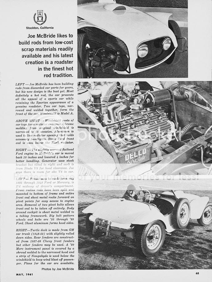

    From Hot Rod May 1961.

    Not quite right. I wasn't as clear as I could have been. The shop teacher died . The car in the thread and the car in the Science and Mechanics / Hot Rod mag are all the same car. But the guy who restored it and curently owns it is the guy who built the 3rd car in the photo of the shop class. He still owns that car. IE, he now owns 2 of the 3 that were built in his shop class. Double cool! ...PS,I don't think he knows about the Hot Rod article as he had left the area by then..

    Nice job on mag scan. This place IS amazing.
