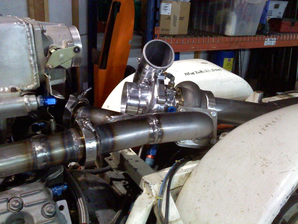

    Tech Editor

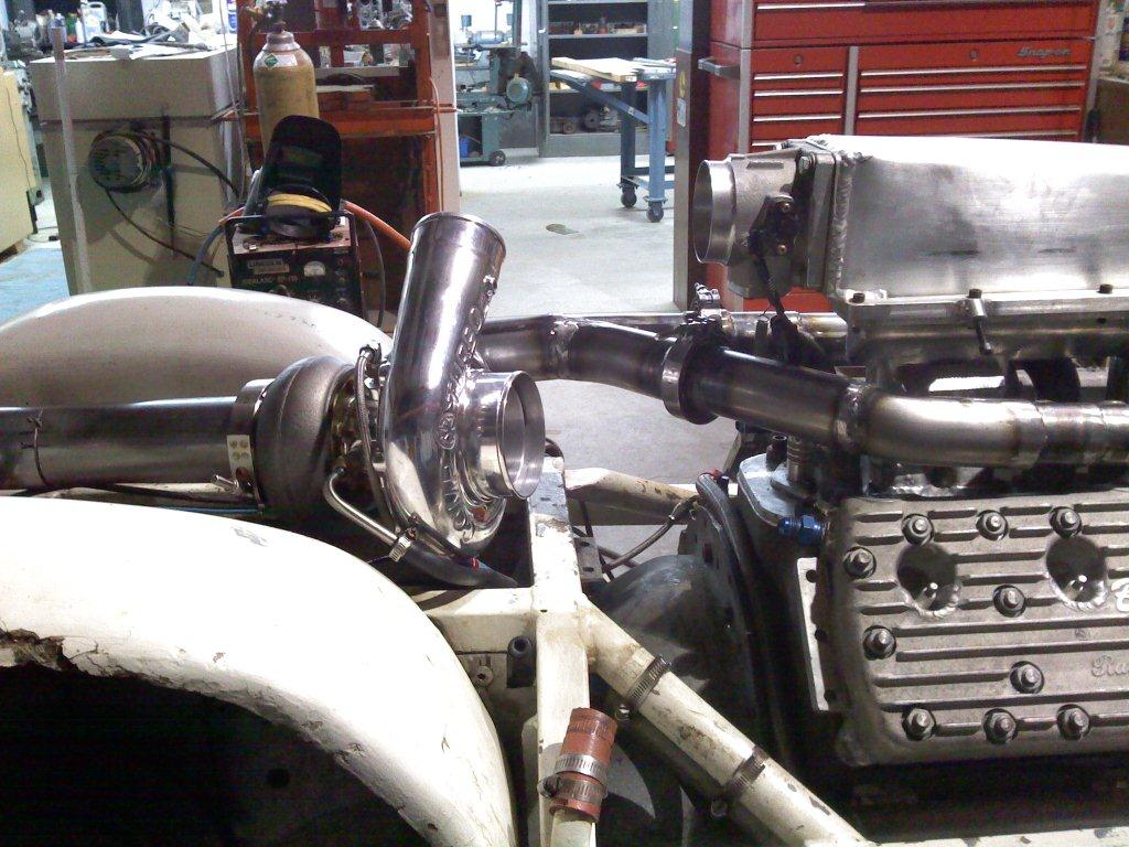

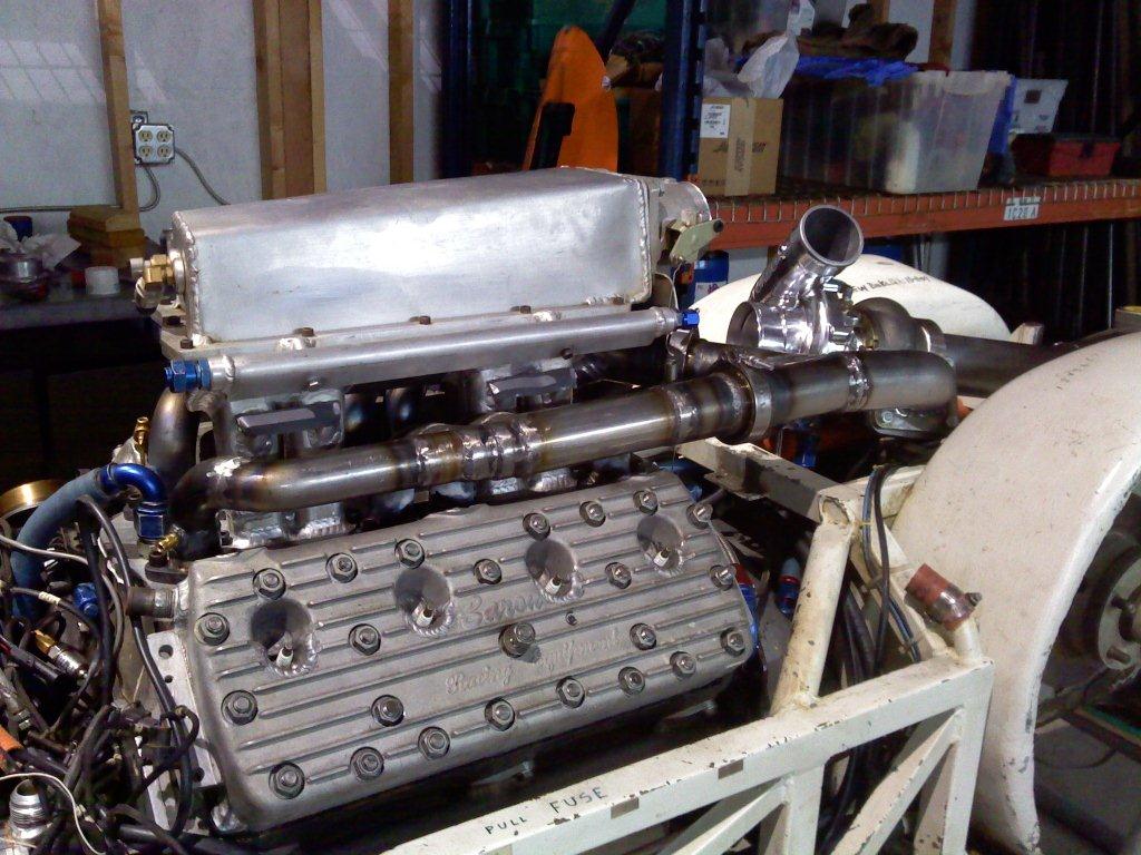

  12. RichFox
    Joined: Dec 3, 2006
    Posts: 10,020
    RichFox
    Ron Mains Vortec or Procharger flathead got him in the 3 club. (I know, Dan) So if you like those snail shell looking things hanging on your motor maybe thats what you should look at.
  13. RichFox
    Joined: Dec 3, 2006
    Posts: 10,020
    RichFox
    Some spy shots that came my way. Keep in mind this flathead went 280 without the turbo. RM watch out.

  28. Dan Warner
    Joined: Oct 25, 2004
    Posts: 557
    Dan Warner
    from so cal
    I hang with the car pictured in Rich's post #14.
    We qualified at 307 on Ron Main's 302 record but broke a piston. Repaired it in time for return runs, but shut off early. Requalified at 309 but, broke the same piston. Jimmy decided to pull the pin on Speedweek. The car is number one in El Mirage points and must continue in order to win the championship.
    DW
