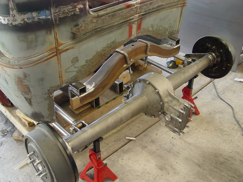

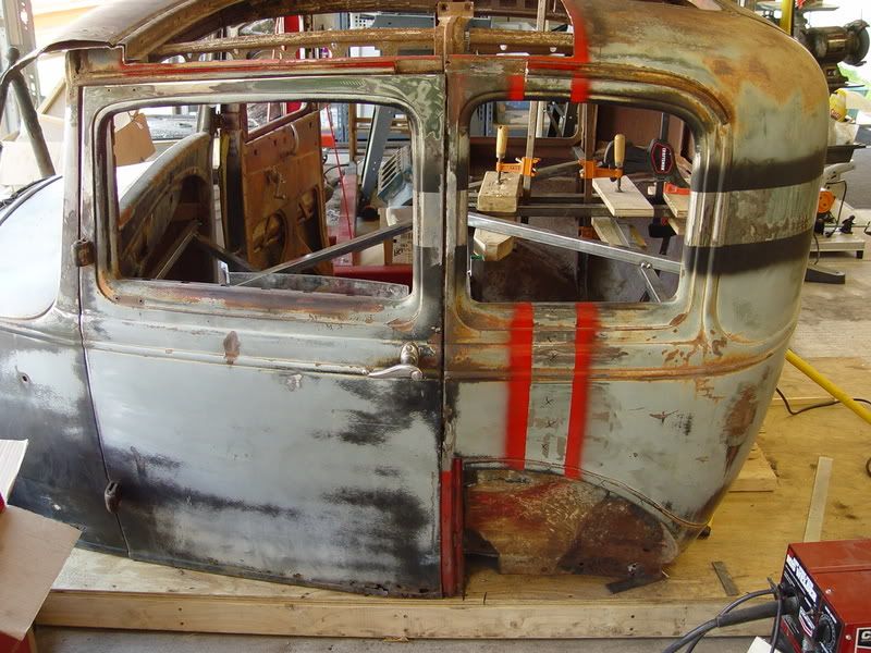

    So things have seriously been crazy since my last real update. Been doing a ton of welding, grinding, smoothing, a BUTT LOAD of hand filing, etc. etc....
    Work slowed down quite a bit over the holidays. Was ill for a little bit and still recovering from that. Also did a road trip across the country over the holidays and did some other traveling as well. It's been crazy and it's kept things from progressing as quickly as I like. But life stuff has to be handled before work can continue...
    As you can see from the fist post, the car is compeltely blown apart. Been getting the frame ready for prep and primer. Trying to get this car to a rolling state again so I can reassemble it and get the remaining parts I need to make it a drivable car. I'm close guys! Really close! All it takes is money and time, right!?? :eek:
    Here's what I've been working on...
    The frame is ready!
    The rear axle is ready...
    The split bones are ready...
    The radiator mount is completed...
    I even drilled the axle...
    At this point it's just a matter of getting paint supplies, cleaning up a few more parts, doing some prep work, little filler here and there to vistually smooth out a few things, and laying down some primer.
    The body is FAR from being complete and ready for final prep work, but it's all about getting the chassis completed and ready for the road. Then the body will come after that.
