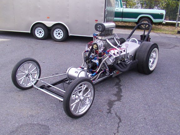

    SPE. Ours I moved the radius rod mount from the top of the frame rail to the center between because of the body. It also has the little link from the axle to the torsion bar. Lippy [​IMG]

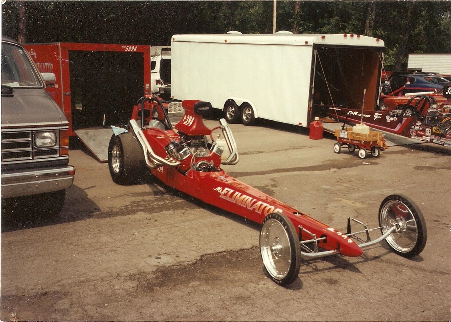

    Here's a good one
