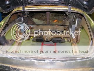

What are your plans for the rear inner fenders?

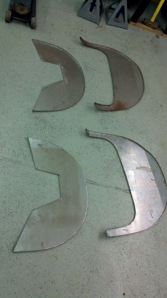

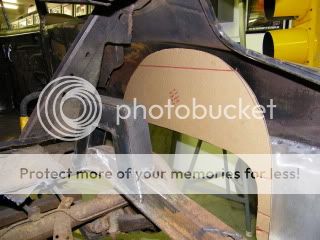

Thanks for kind words guy's. my plan for inner wells is to make them I made a templates out of cardboard to mock it up. then I made a plywood buck to sandwich the metal then did releaf cuts so I could bend the edge over. I'll post some pics.
