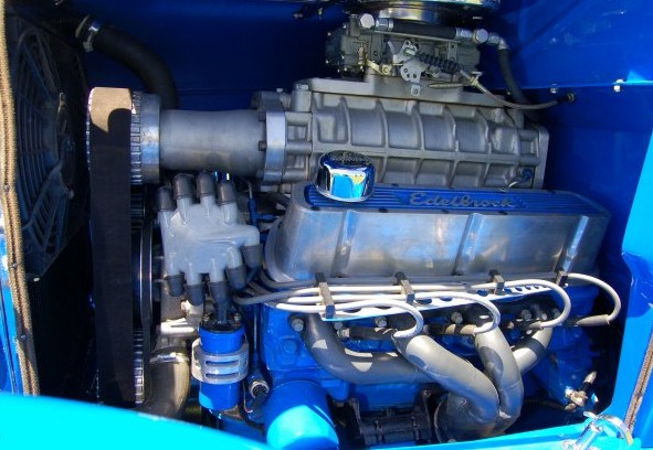

Here's one on a SBF in a friends 28 coupe with angle drive distributor.
www.hotrodfeatures.com/Feature0305.htm
