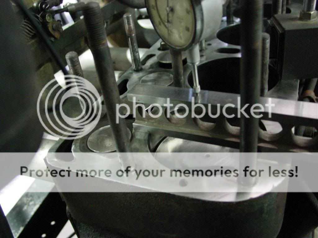

    checking piston popup...roughly speaking anyway.
    deck number zeroed
    popup number of .024" (center of piston above the deck)
    checking net valve lift...it's a big one...HEHE not much over .300
