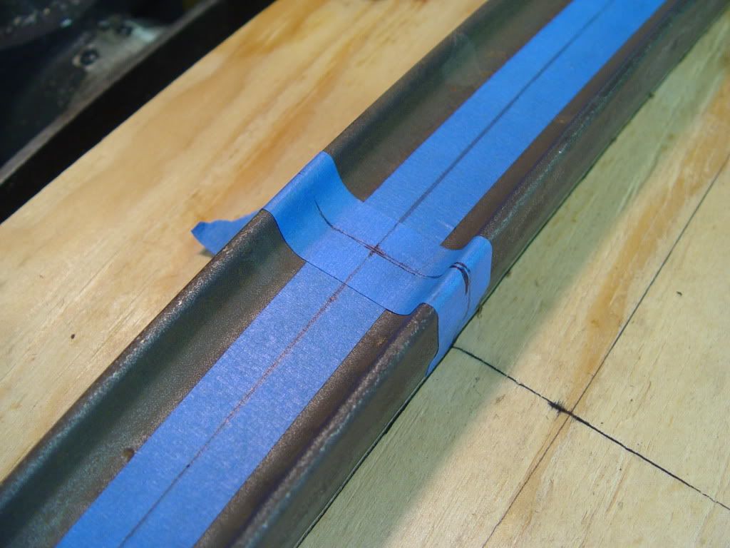

Finding the center of the web is sort of tricky because of the shape of the cross section. There is no place to really measure from that is an absolute perfect edge. I made a guide based on what I saw another HAMBer do and applied. I used some sheetmetal template paper that I had. It's basically heavy construction paper. You could also transfer this templaye to a wood or plastic material to get real accurate, but keep in mind that the hole saw will "walk" slightly anyway, so there's only so much you can do unless you decide to do this with a mill, or something more accurate.
The template... It's very important that the knife be pink or it won't work right.
I folded the paper in half so I could get it perfectly symmetrical and opened it up from time to time to check the fit. Just kept trimming until I got the right fit. The fold line becomes the center line, so it's important that it be a nice, vivid fold.
Next I taped a washer to the bottom to keep the bottom edge from folding under as I ran it down the axle web. This edge must stay true or your center line will be all over the place.
Then I flipped it over and drew the center line
Check the fit and measure if you're not sure, just to be safe

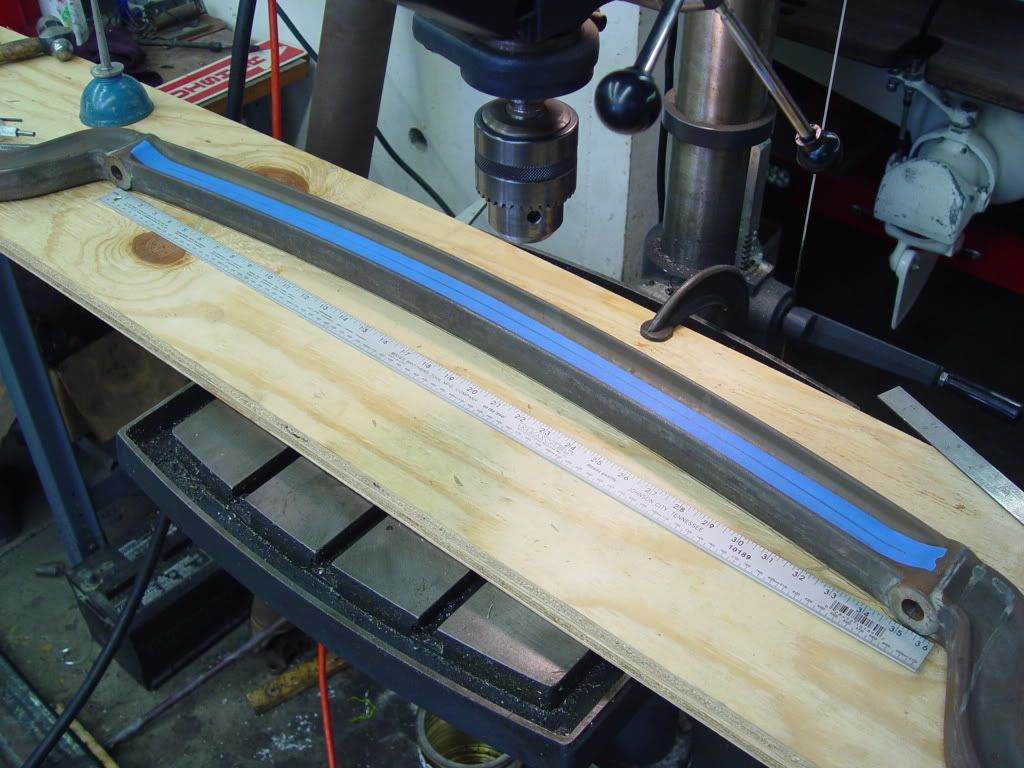

Next the center line was marked on the axle. I decided to use a good sticky masking tape instead of blue Dykem spray because I had it, but the spray could be used as well.
Draw the line!

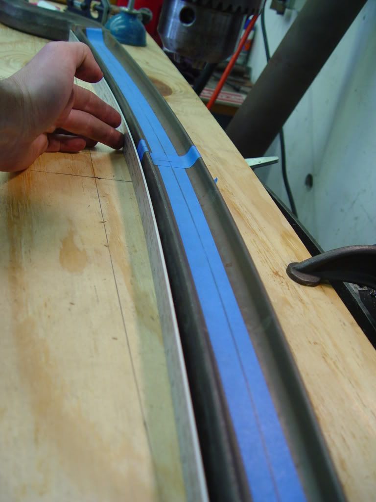

At this point, it's a good idea to check the line to make sure it really is on center. Run the template over the line to check it. Flip it around just to make sure you've been consistant. Make adjustments to the template and/or line, if needed. You only get ONE SHOT at this. Better to screw it up and fix it now.
The most difficult part of this whole thing is laying out the center marks for each hole. You want them in the center of the web, and you want them equally spaced. Obviously if you have an odd number, you want to start at the center. So how on EARTH do you find the center of a curved axle that basically has very little to referance from? Guess?? Hmm... There's a bunch of ways, but I'll show you how I found mine.
I used the plywood table top to draw and trace all the geometry on. I used the inner-most perch/wishbone holes that straddle the beam that was going to be drilled. First I found the center of the holes and measured down to the table and marked it.

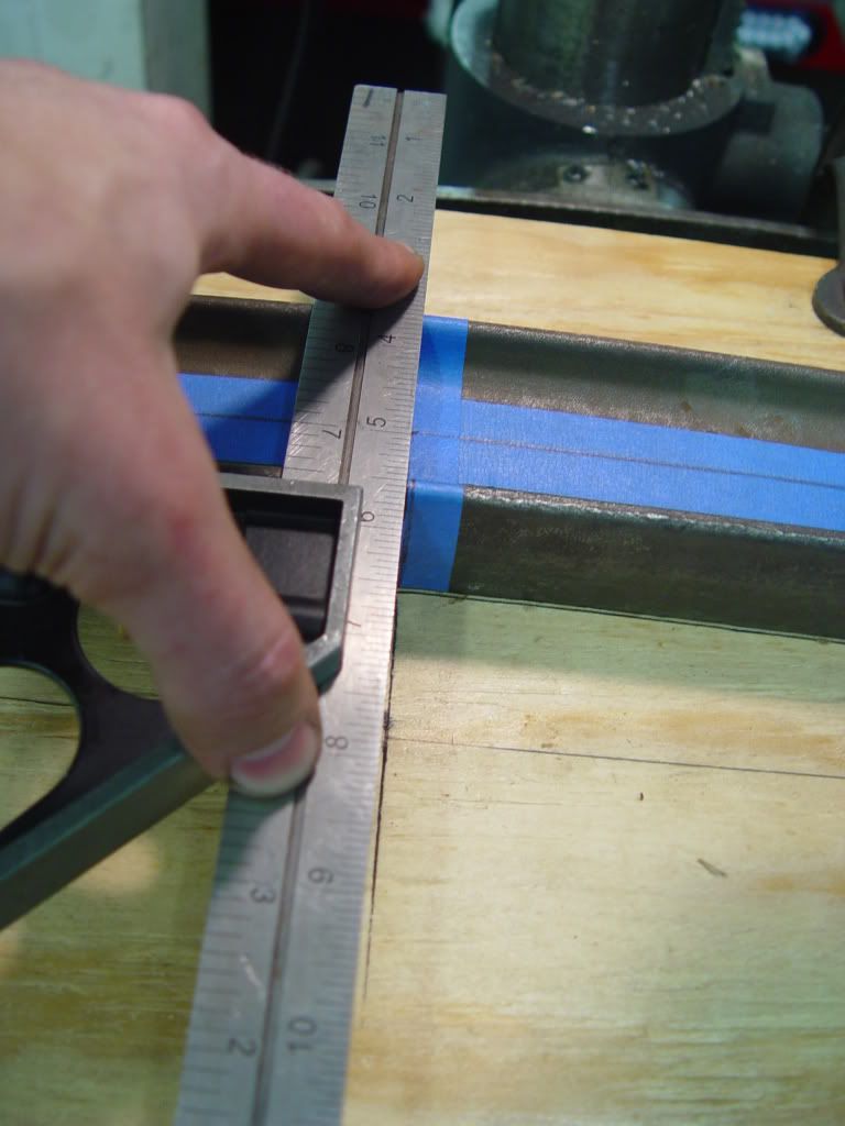

Use a straight edge/ruler/yard stick, draw a line between the to hole centers and find the center of the line.
Use a square to transfer the center to the axle

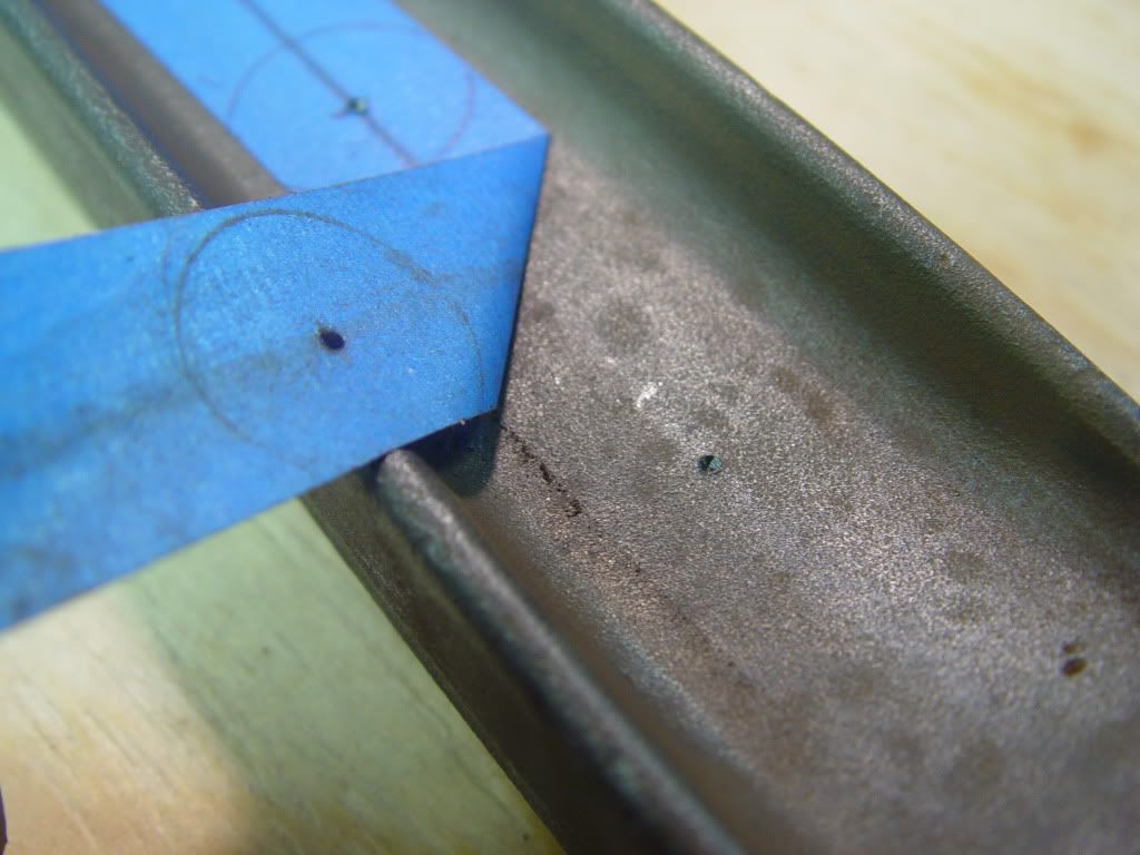

This is where the flexible measuring stick comes in handy. After transferring the mark to the axle (again using some real sticky masking tape) it was easy to check the mark.
So why didn't I do this first? Because I needed a line to transfer the mark up and over the top using the square.
Okay! Now there's a starting place. The marks can be setup for the centers of each hole.
Here's the mark.
I used a small flexible ruler to layout the holes center to center.
I just happened to have a washer that was 1" in diameter so I used it to trace the holes and check my layout.
Now reality sets in. Check EVERYTHING! Make adjustments! No going back now! It's hammer and punch time!
Check the layout again to be safe and transfer the centers to the axle webbing.
Peel the tape and your centers will be obvious
