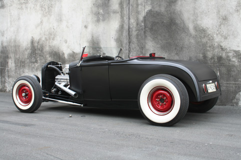

    A lot of the inspiration came from my buddy Josh's '29 roadster. but, i liked the '30/31 body style so i had to get one!!
    The next inspire'er was Bill Stelles '30 ford 5 window (2009 hotrod of the year). mostly for the frame. i really like the look of deuce rails kicked up in the front.
    And next, i have no idea where i found this pic but i did and i'm so glad i did. This flat black roadster is perfect in my eyes.:eek:

    Very nice. I like the roadster also- the coupe is just a tad too swoopy for me, but the lines are right on. Are you going with a '32 grill shell? That black roadster looks pretty killer, and in your color combo would look even more badass. Good luck with your build! I know I'll be checking in periodically...

    I wish you knew more about it too. The T windshield is different! But it's a good thing....
    Just noticed the 28/9 quarter panels on it too. Odd combination of parts, but I really like that roadster!

    I believe that black '30 roadster was built by rocket speed down in new zealand.
    try their website, they might have more pics/info.
    www.rocketspeedequipment.com

    www.rocketspeedequipment.com Ive never heard of these fellas. the stuff on the site is awesome!! thanks for the link, Kiwifruit.
