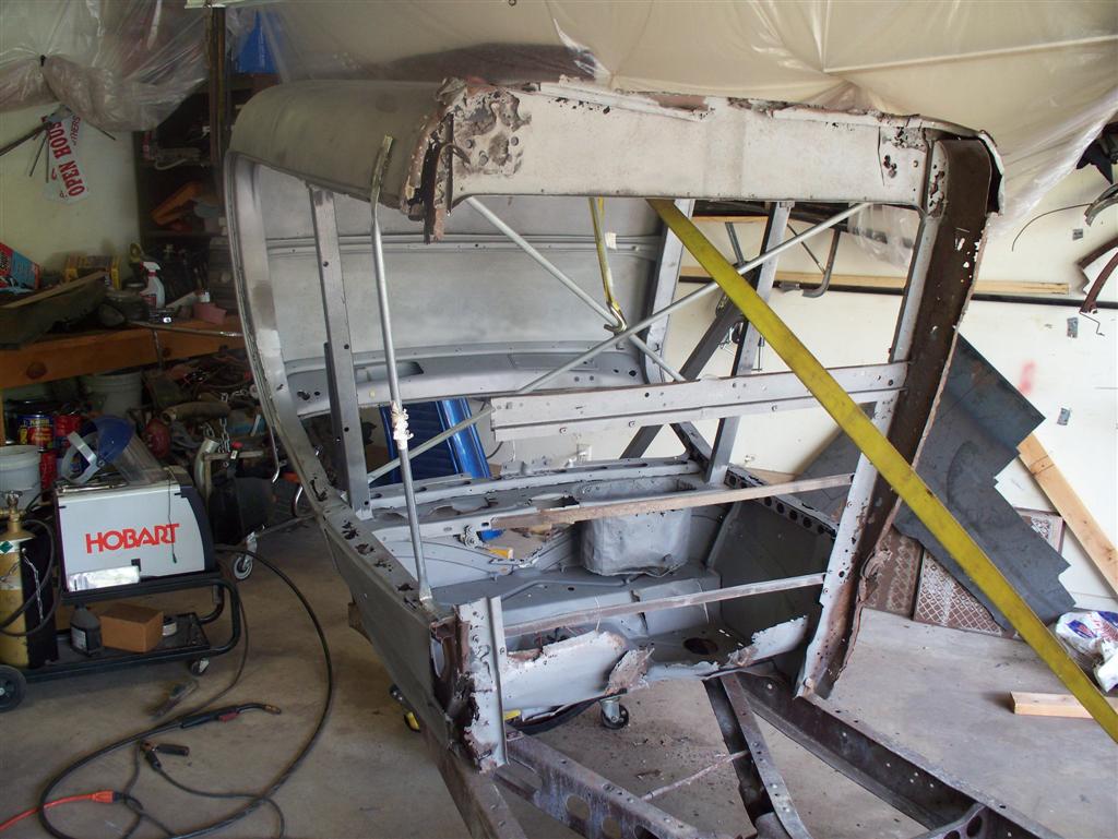

    Before the cab went to Chris I braced it up really good, it stayed square throughout the process, i knew that when I started to cut out pieces of it, it had to stay straight.
    The floors were gone so what I ended up doing was using what was there as patterns to make a new pieces. I cut pieced out one at a time and using cardboard templates made a new one out of 16 gauge sheetmetal.

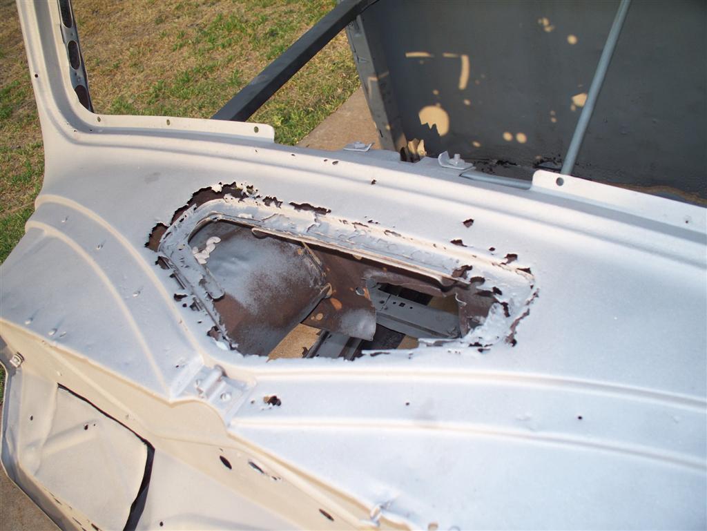

    53choptop
    Cowl vent patch

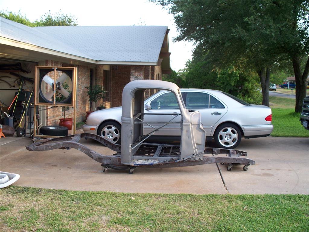

    This is the stage I am at right now. I want to make sure everything lines up on the frame before I hit the suspension. Several things were shortened/extended to make the whole thing fit on the car frame that assuming it fits would be a mistake.
    I have since stripped the bed of the paint and filler, the bedsides were decent, but this thing had so much bondo on it that it didn't even need. The only plus about that is that it protected the sheetmetal....at least that what i keep telling myself.
