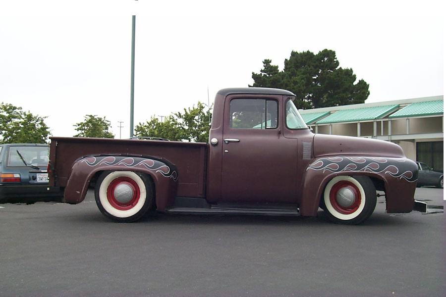

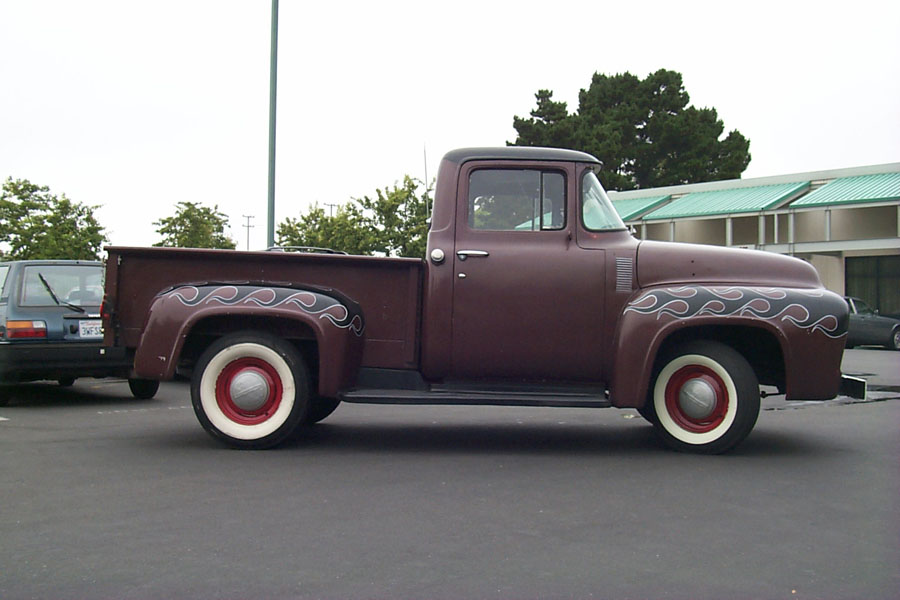

    I had a '56 Ford truck about 10 years ago (hence the red wheels and goofy flames), which had 15" wheels. I went for the "big and little" look on it, and the rake was kinda cool...
    (Probably 7.00 x 15s on the rear and 6.00 x 15s on the front.)

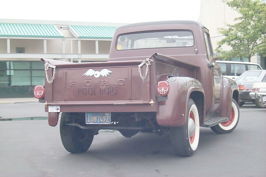

  7. mine with 6.50-16s with stock caps and some smooth trim rings. They fill out the wheel wells nice, but they're damn skinny when looking at them from the back. The other pic with the thin whites (old G78-15s) and caps is more to my liking.

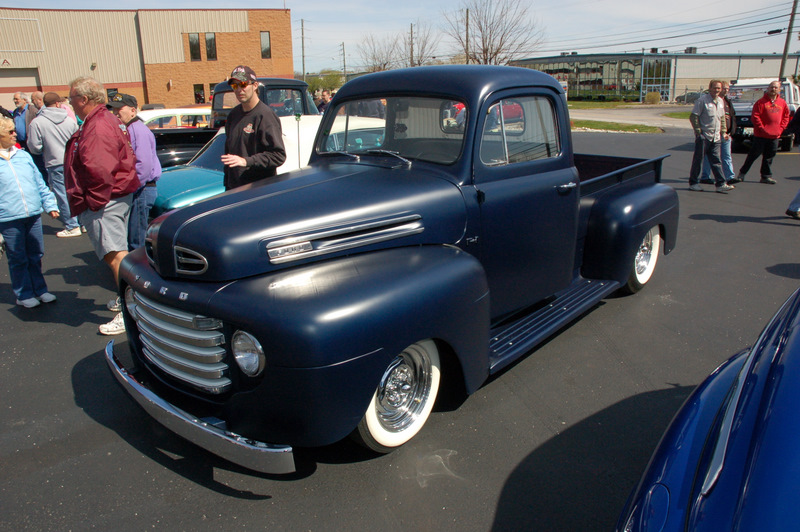

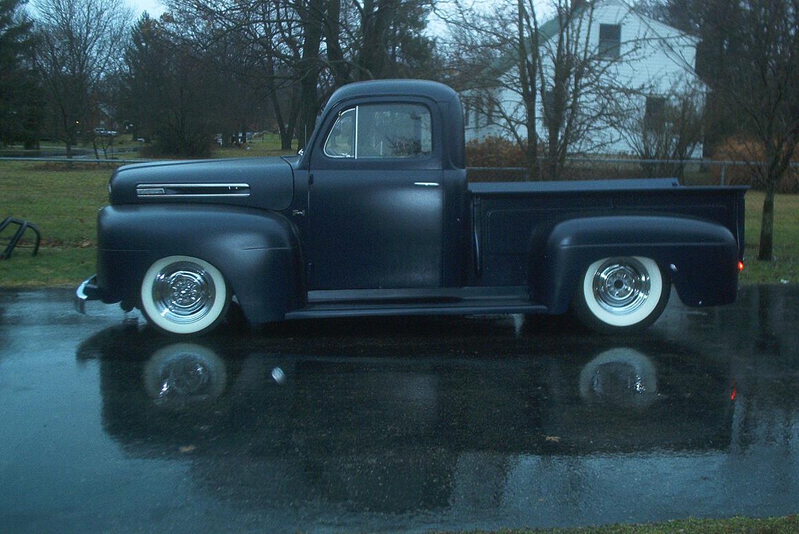

    I found this on the Classic Trucks website - it's one of my favorite trucks. Stance is perfect!
    Front tires: Diamond Back Classics WW, 205/70R15
    Rear tires: Diamond Back Classis WW, 235/70R15

    That, to my eyes, in at least some ways looks like the best stance out of everything I have seen in this thread so far. The way the top edges of both the front and the rear fender well openings line up just slightly above the top of the wide whitewalls looks absolutely perfect to me. It also appears to leave enough ground clearance to actually drive the car on normal roads without worrying too much about scraping over speed bumps or crashing body, frame or whatever into the pavement when negotiating pot holes and driveway entrances.
    Personally, I also appreciate the fact that the owner wasn't afraid to use radial tires. It may not be period correct or traditional, but if you are going to drive the thing regularly and for any sort of distances the improved traction radials provide for braking wins out for me. Yeah, I know that isn't generally accepted view here, but on a vehicle that I actually intended to drive more than to and from the local weekly cruise night parking lot I, for one, would prefer the extra margin of safety provided by radials over the period correctness or tradition of bias plies.
    If the wider aspect ratio of the 70 series tires seen above looks a bit wrong to you on a truck of that vintage (and I can certainly see where folks might feel that way about those tires as I'm thinking exactly the same thing) there's always tires like the Coker Classic Radials which are available in some of the same tire sizes as the bias-ply tires folks here favor and with the same wide whitewalls. Frankly, tires like those Coker Classic Radials seem like the perfect solution for a guy like me who wants both the traditional look of the old bias plies and the safety of modern radials.
    So, for me, the combination of something like the 600R16 Coker Classic 3" whitewalls up front, and the 700R16 Coker Classic 3.5" whitewalls in back (yeah, I like the 16 inchers) might be the way to go. The tire sizes might need to be taken up or down just slightly to make the look and the stance just right, but care should be taken to make sure that the tires are large enough to carry the loads they'll be subjected to on a truck like that, especially if the truck will actually be used for hauling now and then.
    Safety first and all that.
