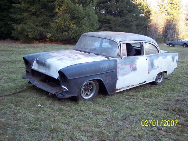

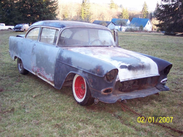

This is the 55 I got back in late July of 09...I thought I would just slap a straight axle under it and an engine then worry about the rest. I WAS WRONG!

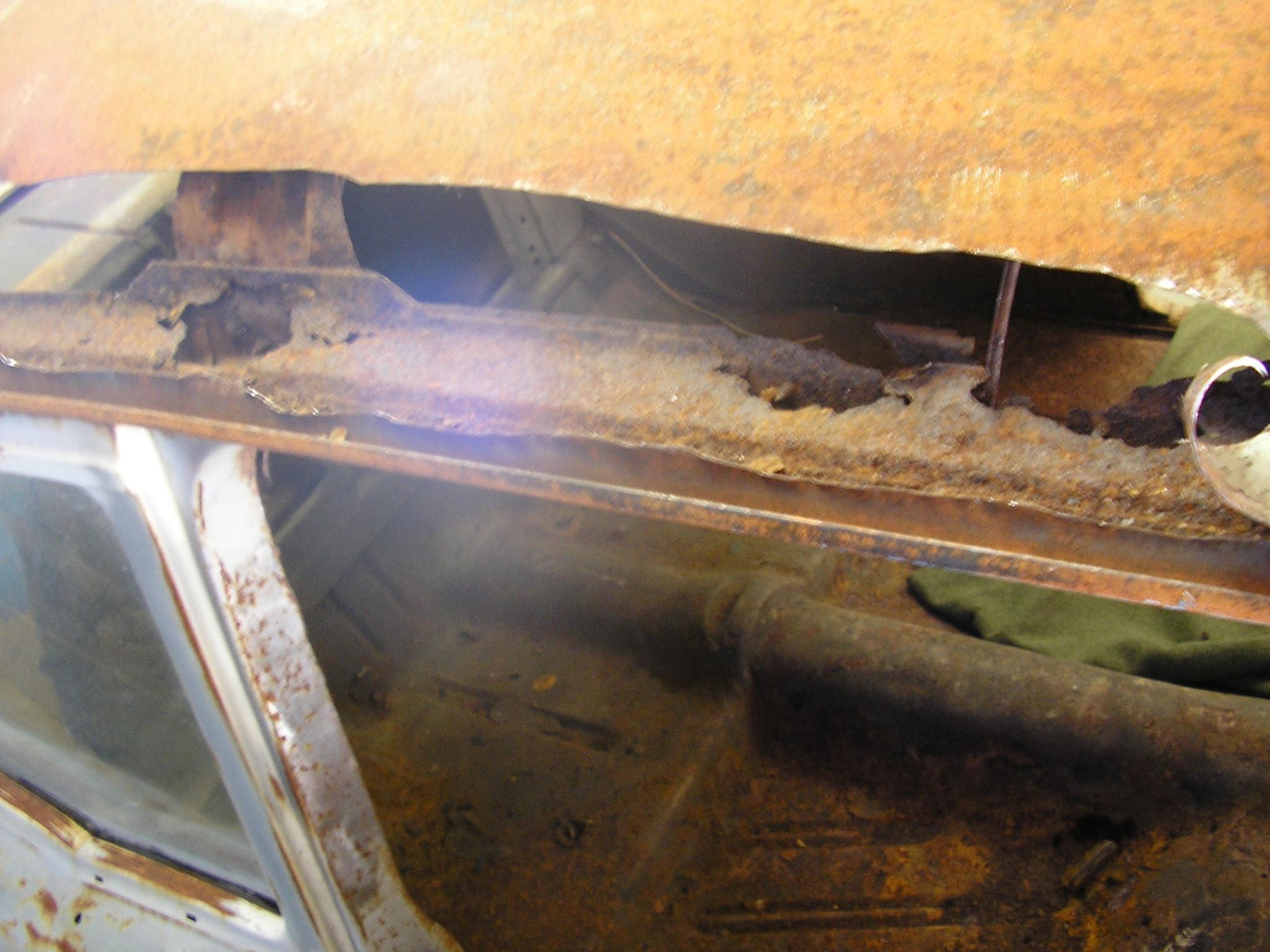

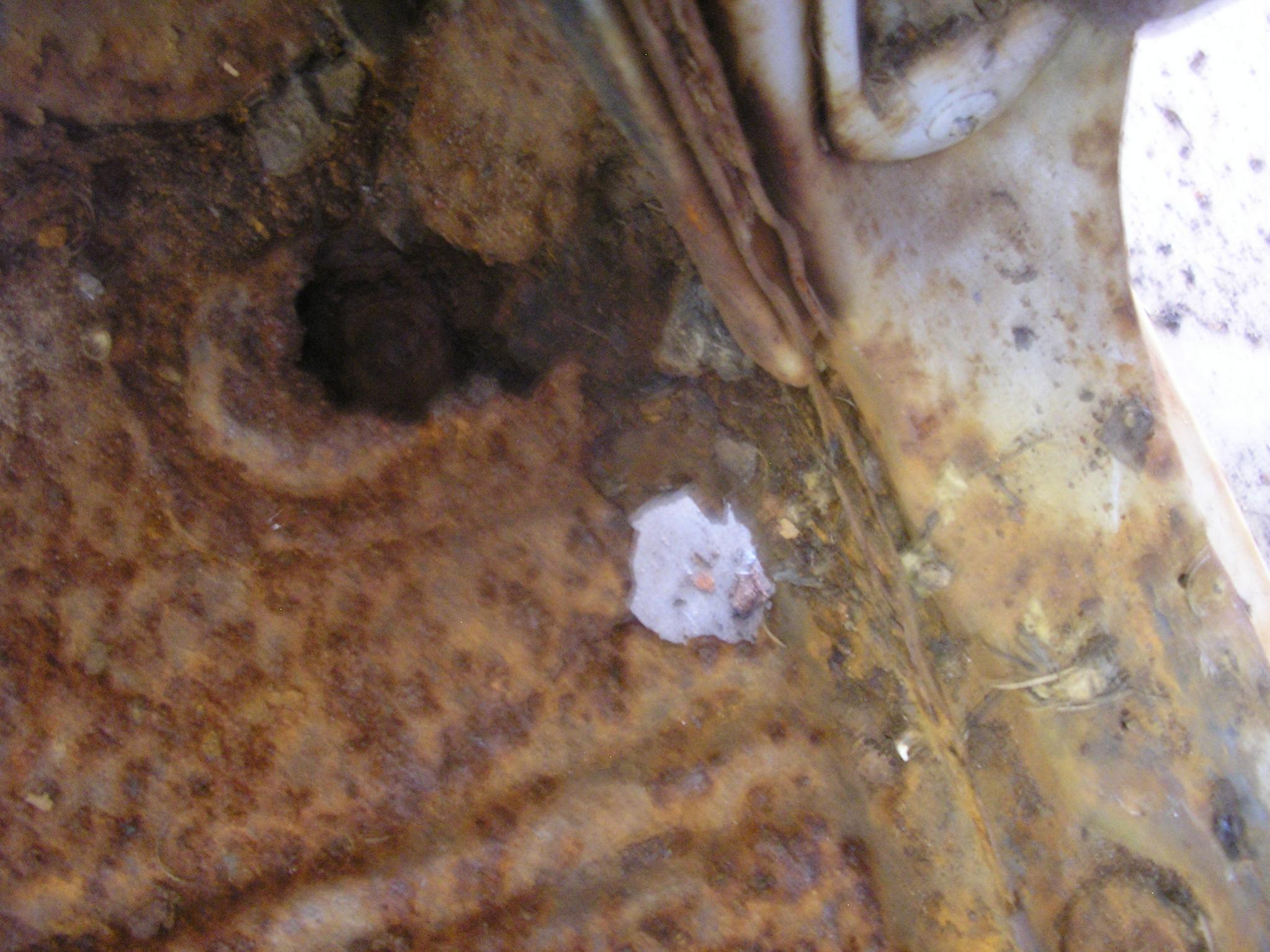

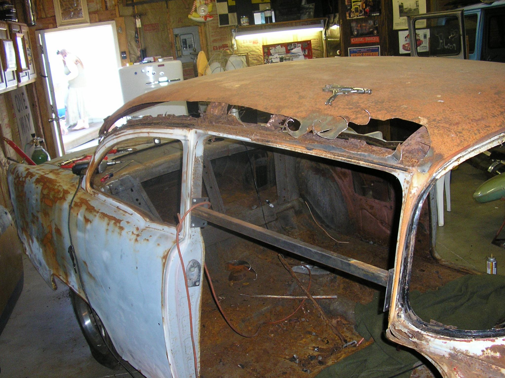

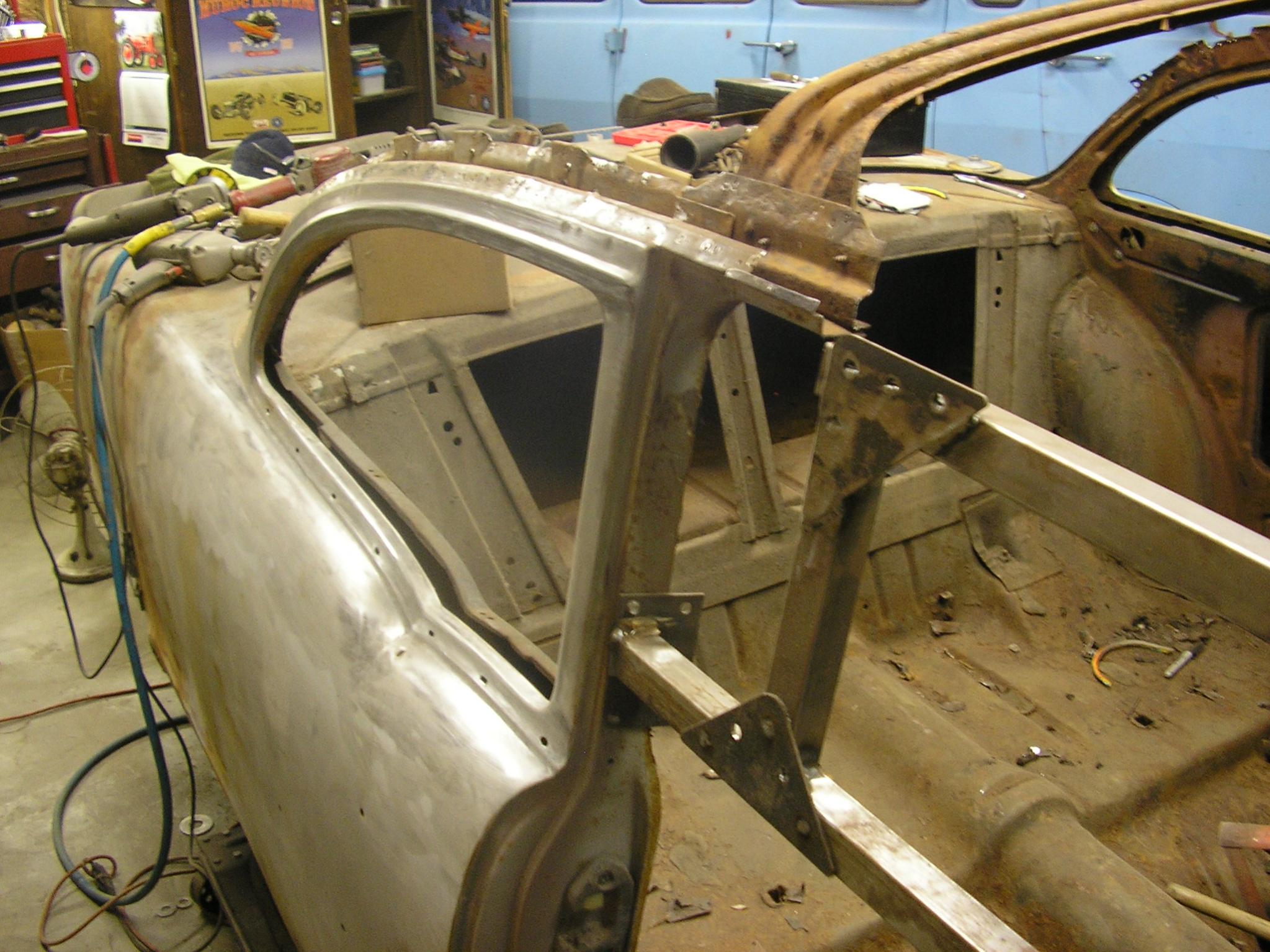

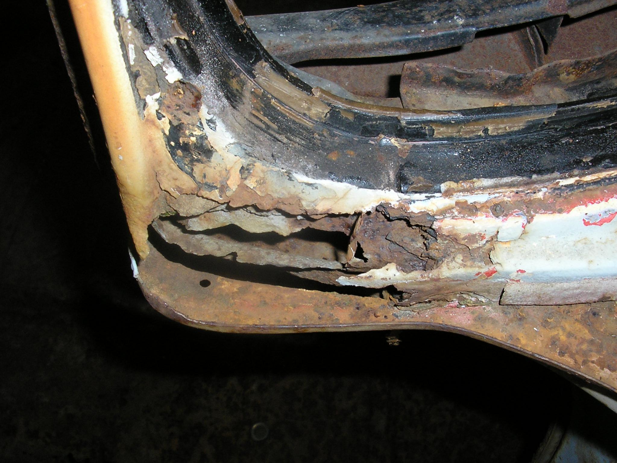

So, I got to looking at this "gem" and realized what a rusty piece of shit it was. The top and cowl were dust...if you used a pressure washer, the car would have dissolved!!! I decided the only way to fix it is to cut it in half!

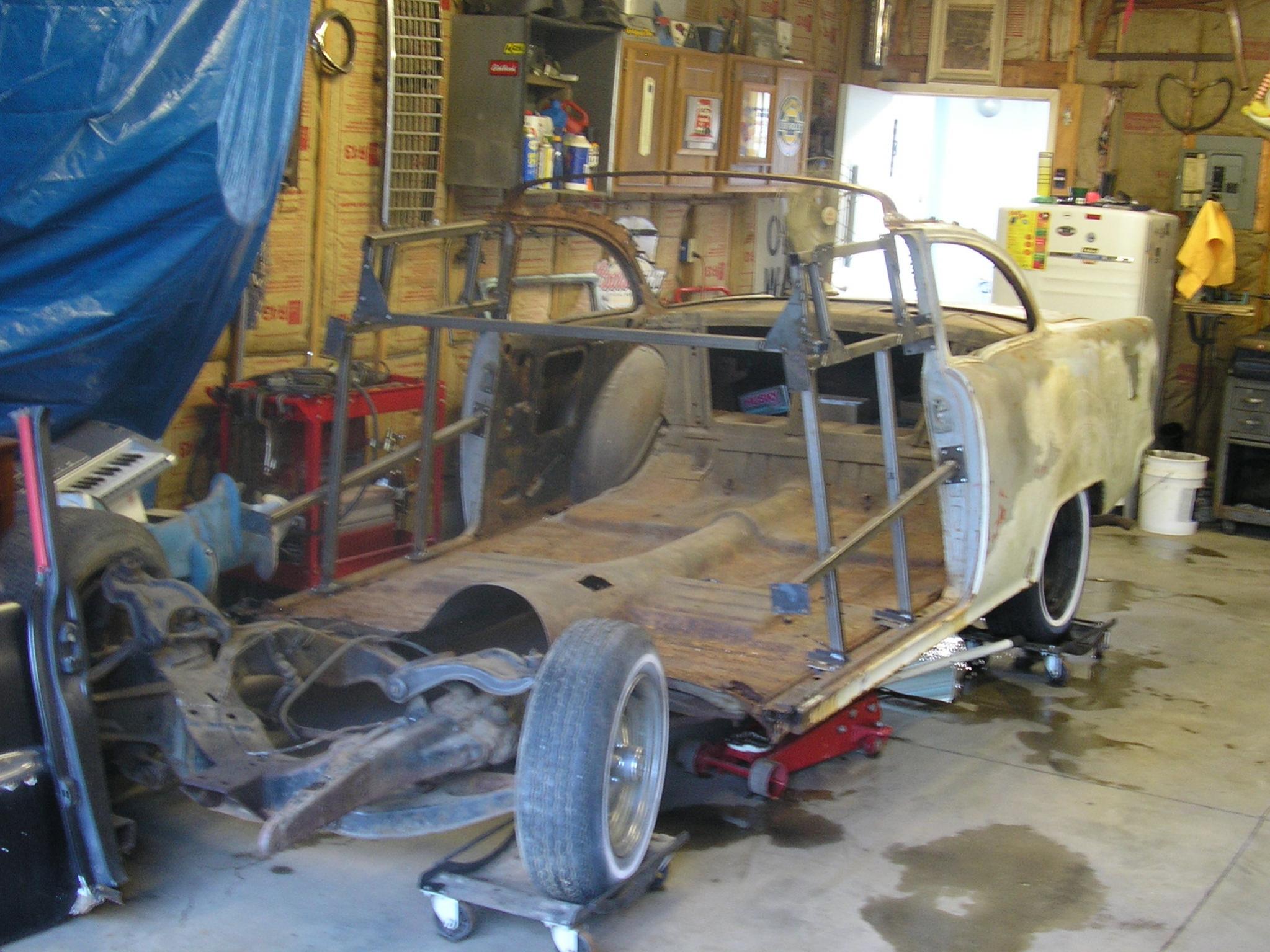

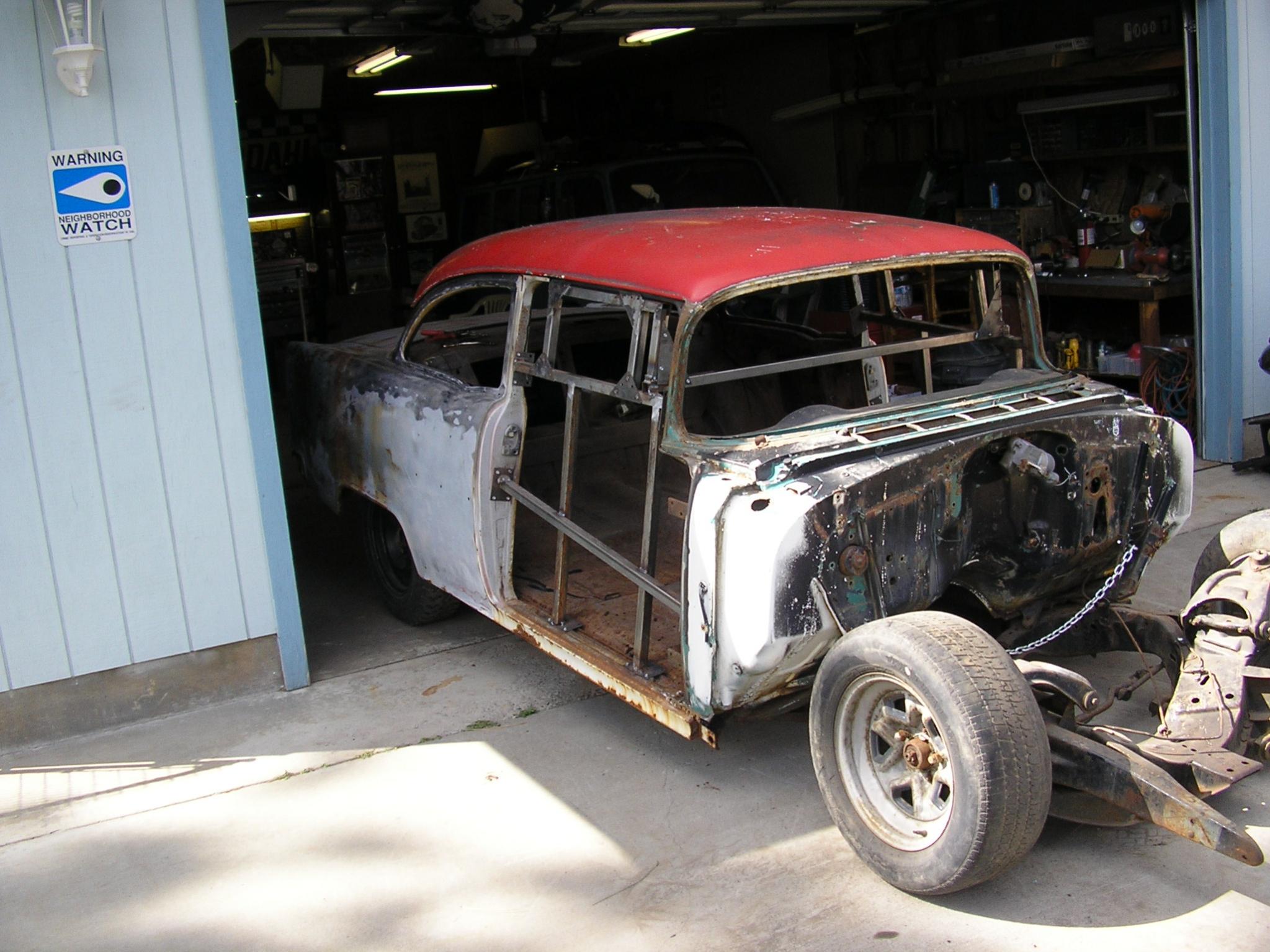

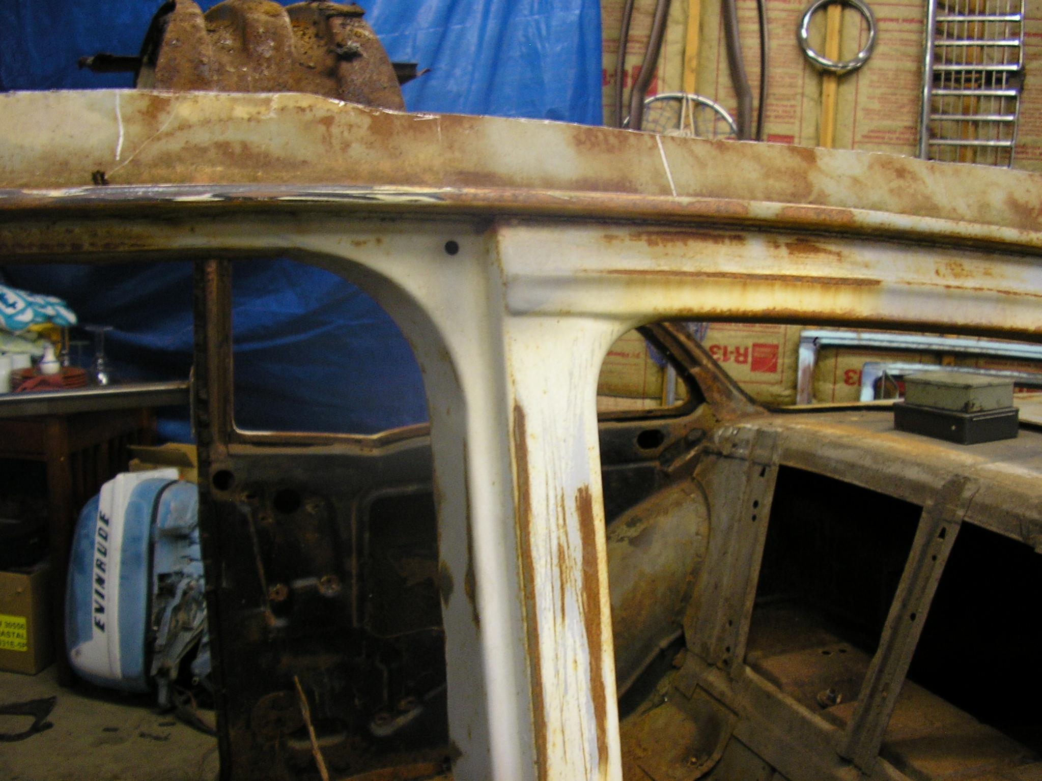

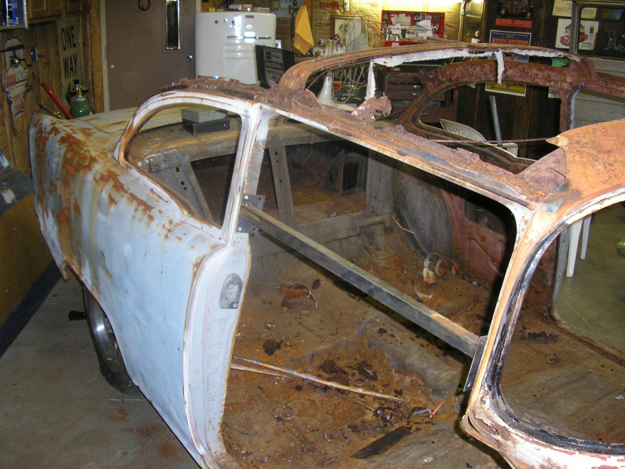

What I had left to work with was this!!!

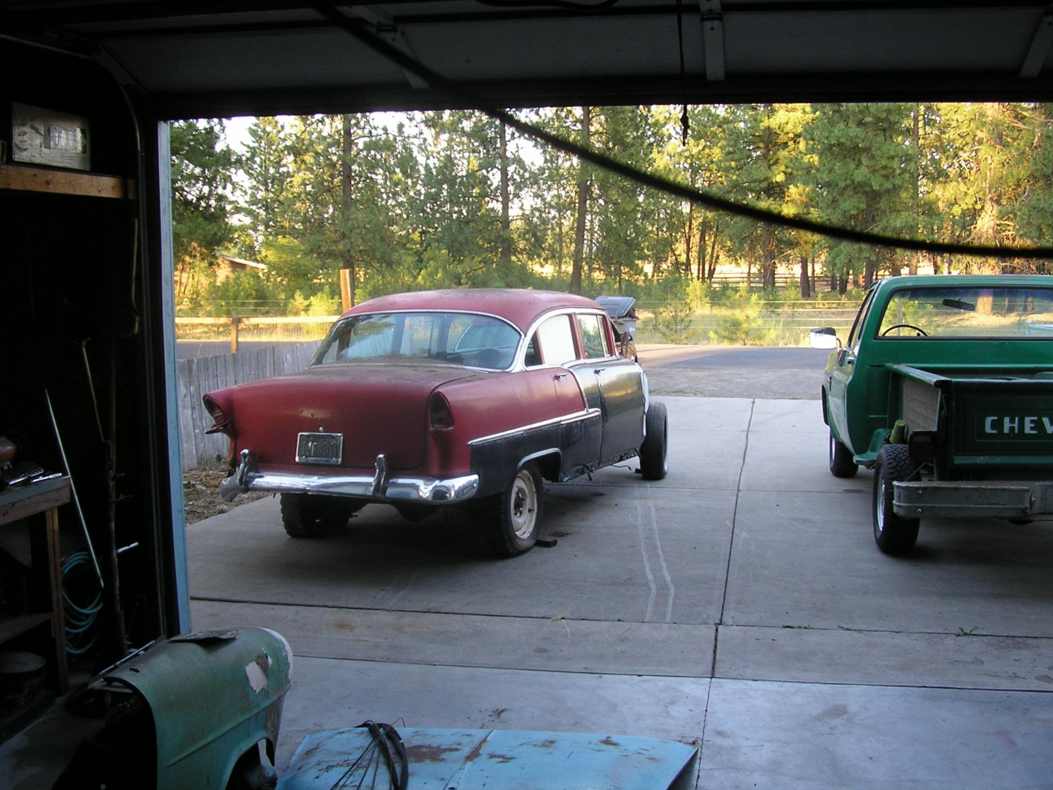

So I found a 4 door parts car...

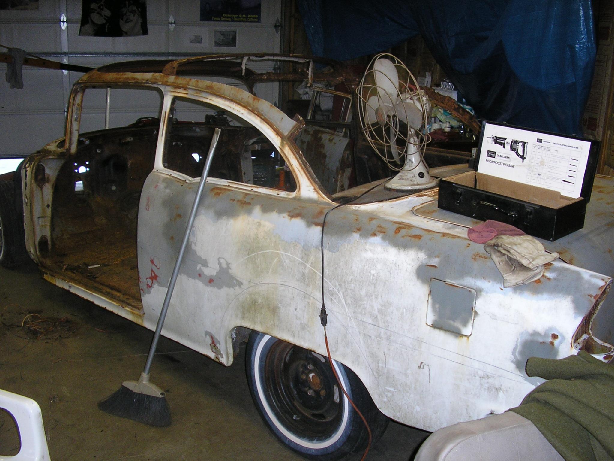

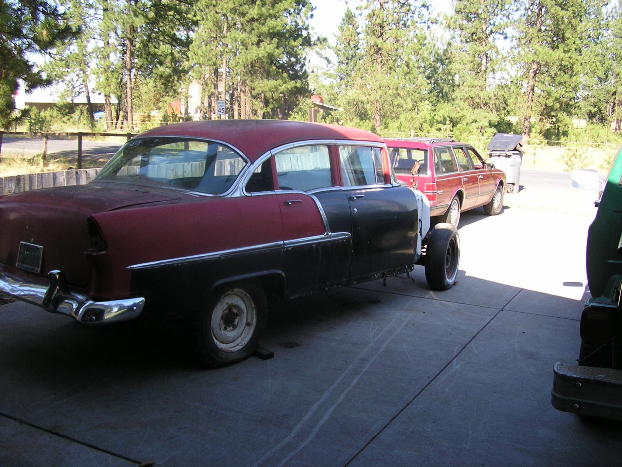

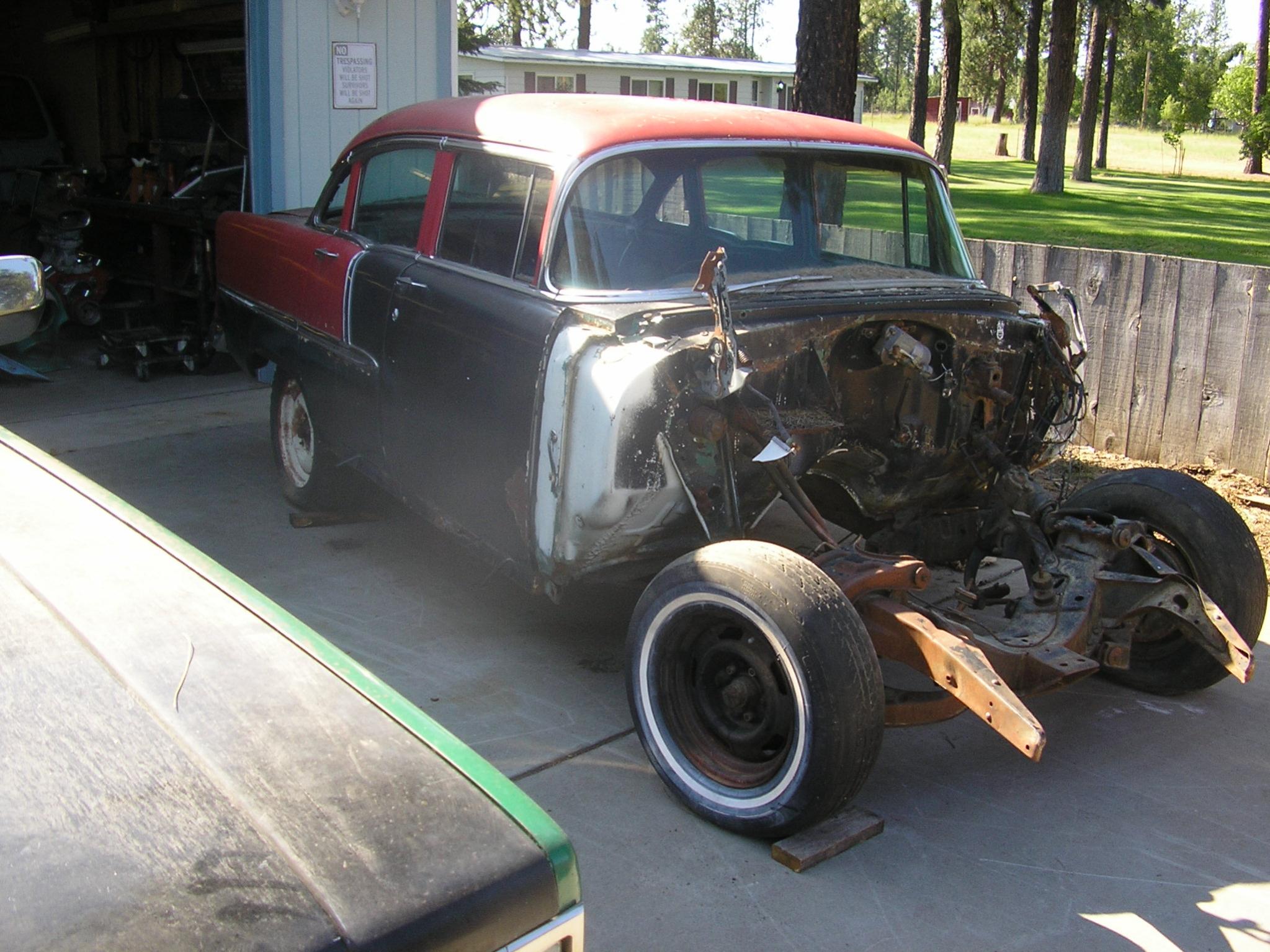

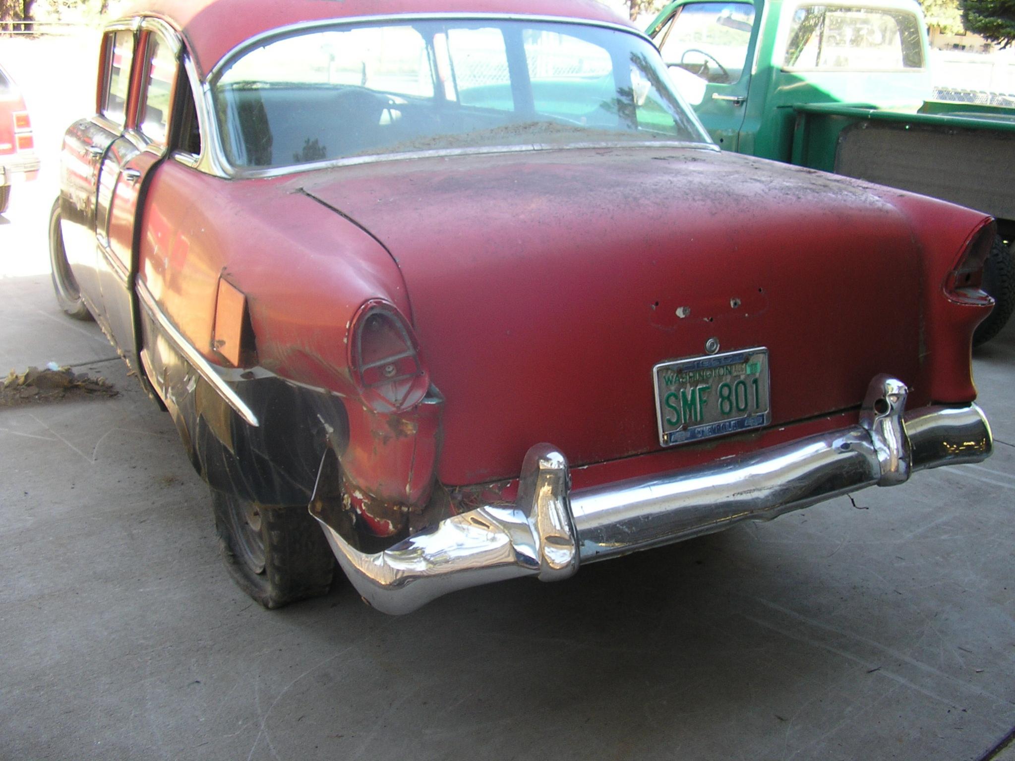

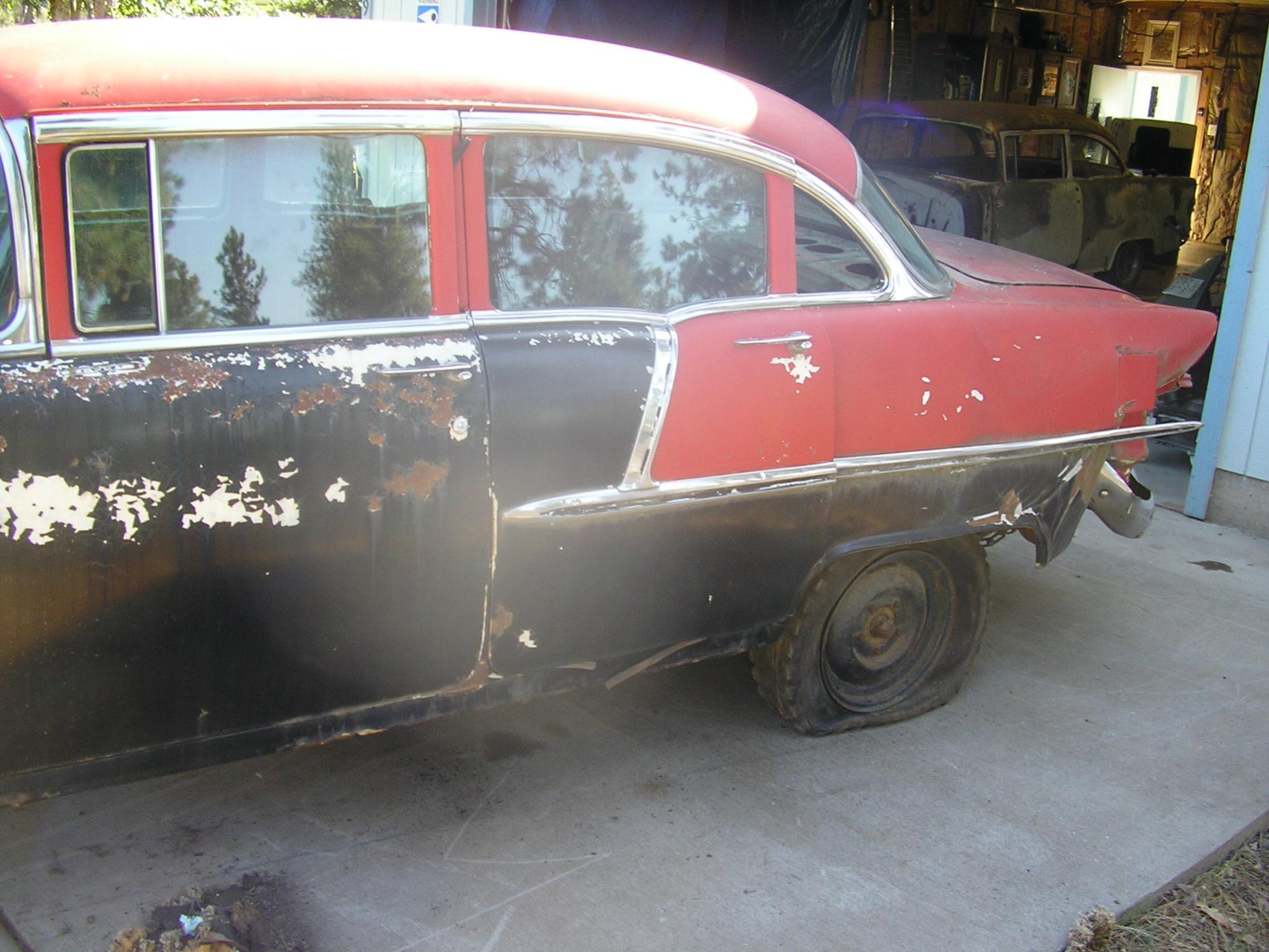

Here is the doner. 1955 Belair 4 door sedan! Had rusty floors and rockers, but the cowl, windshield posts and top are very nice!

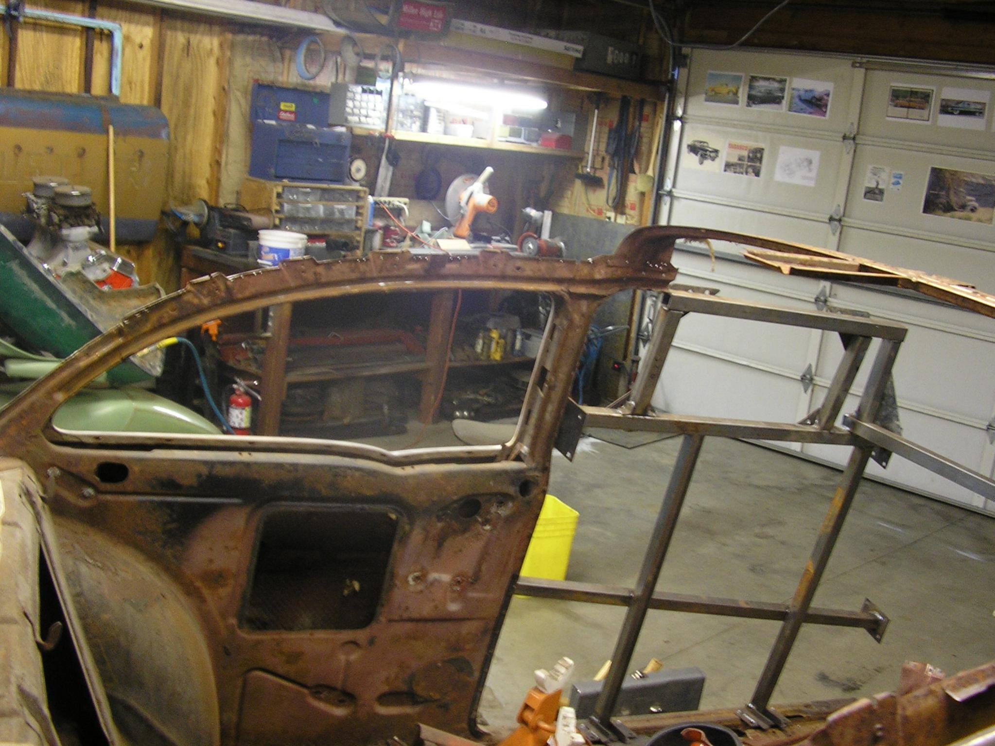

I cut the 4 door apart and drilled out what seemed like a 1000 spotwelds.

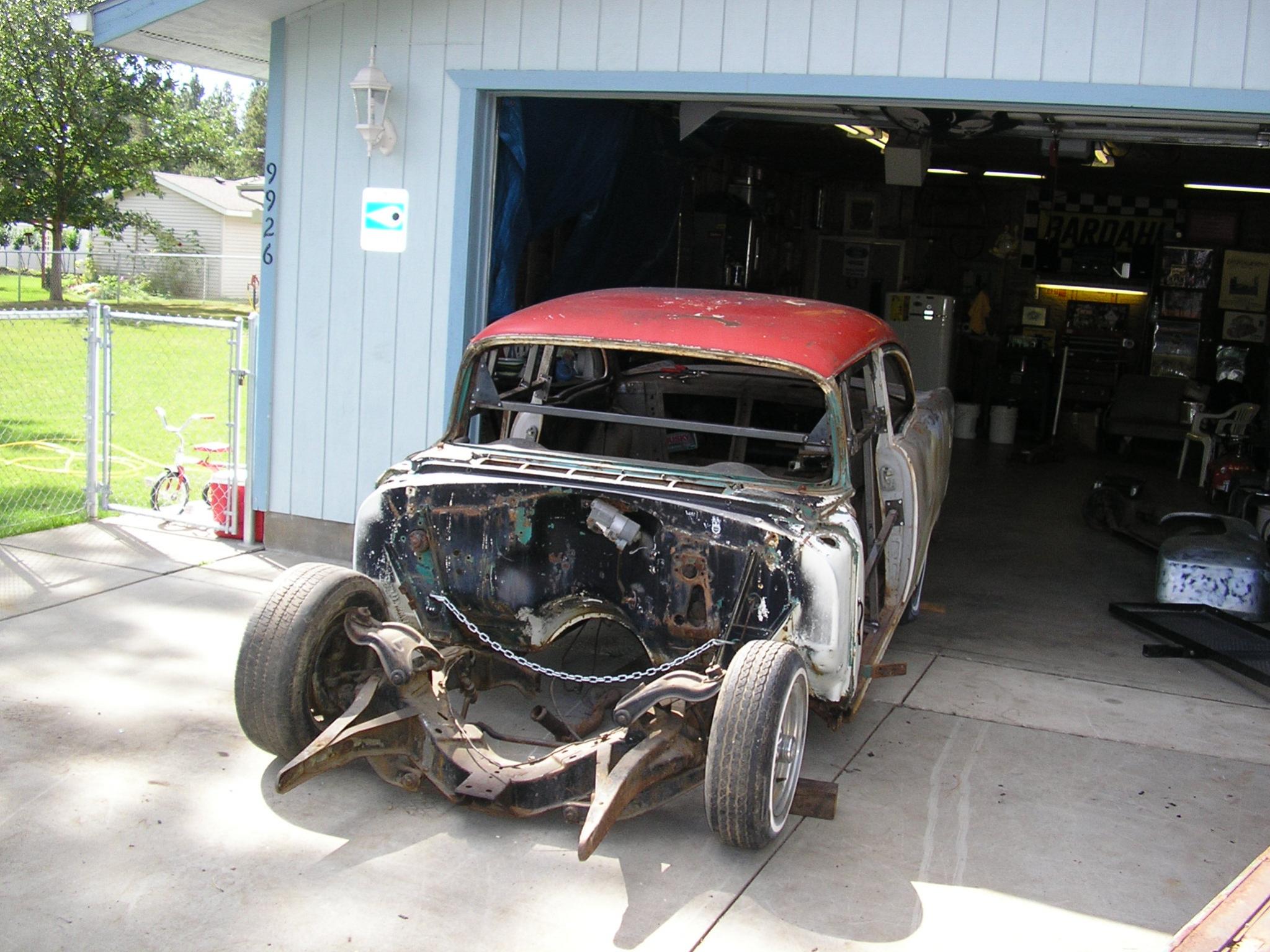

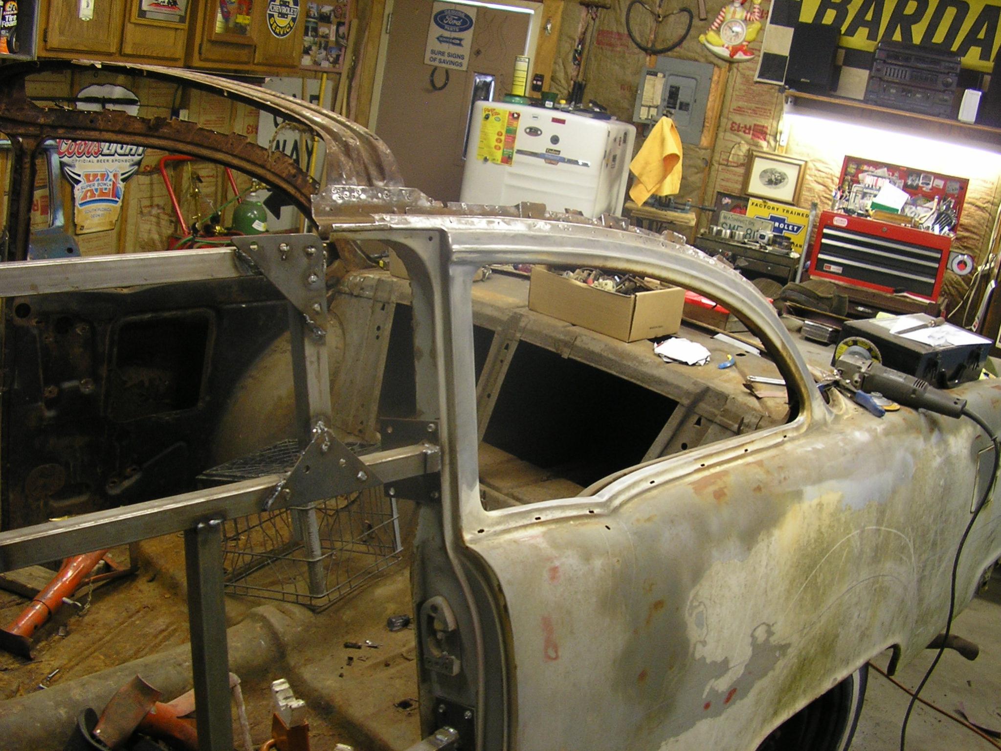

So I guess I will get to the point. I had a very productive Labor day and this what resulted! All that is left to do now is floors, rockers,trunk, and quarter panels...then I can start building my gasser!!!

That cars in about the same shape as my wagon when I started - but from the bottom up. My roof is alright, but everything else is rusted. Yours is looking good!
I so far have cut basically the lower 6" out of the car and am in the process of replacing it. Then I get to delve into the cowl. I am dreading that.

The car looks great, thanks for posting pics. Do you have any other pics of where you cut the spot welds, or where your welds are that connect the donor roof to the 2 door sedan upper window pillars? Because I'm collecting info on how my '57 Chevy 2 door conversion is going to go down, and this is all very helpful to me, since that area of seam separation and welding are the same.
The best part about using a donor car is that when you part the rest of the car out, you can usually get everything you wanted for free. I've parted out three cars already for my '57 project and I've come out ahead on every one so far. If you haven't already, cut out your extra left-over dash, and be sure to cut around all of the original weld seams. Those dashes have good resale value if you cut them out without cutting off any of the sheetmetal of the original dash stamping. I've gotten $265 for each of the two that I've had so far. Just thought I'd mention that.

Would it have been easier to fuse the 2 dr. quarters/quarter window sections onto the 4 dr. body (seeing as how both cars need rockers/floors anyway?
At any rate, we should all be sending you beer for all this hard work we're witnessing.

The 4 door had been wrecked...left rear quarter tail lamp was smeared across the trunk lid. I figured it was best to save what was left of the 2 door. I have heard some people on various sites say"converting a 4 door is not the same as having a real 2 door". I call BS. If you take your time and find the 2 door patches...I cannot see any difference. Its okay to take all the dash parts, windshield, hood trunk lid, bumpers , fenders from a 4 door, but not the top and floors...seems kind of hypocritical. I guess I did not receive the"cut-off memo"!!!

Nitro thanks for your post when I saw the pictures of top looking like you took a can opener to it. I had my doubts where you were going. But then you got my attention nice save. Keep up the good work and the post. Ron
Here what I started with

ID:	873843Started cutting pieces from the very rusty pair of doors that came with the matching body...atleast it was a set!
I plan to use the inners to repair these gutted old gasser doors. I want windows that roll up and wing vents, so between the two, should work out well!

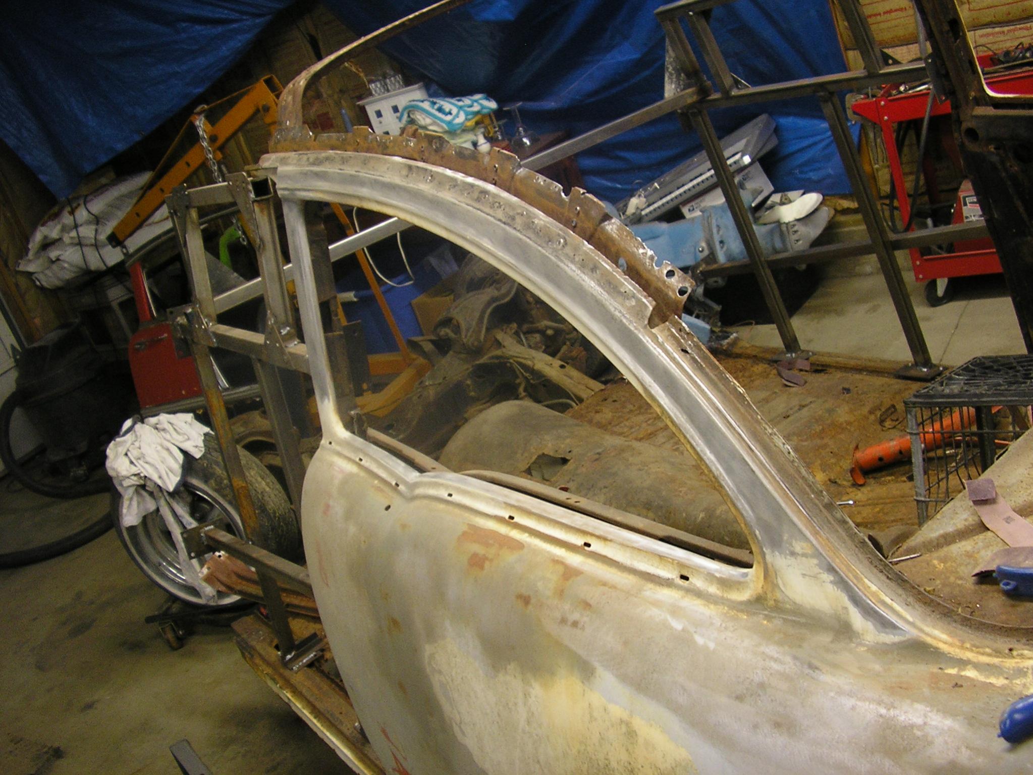

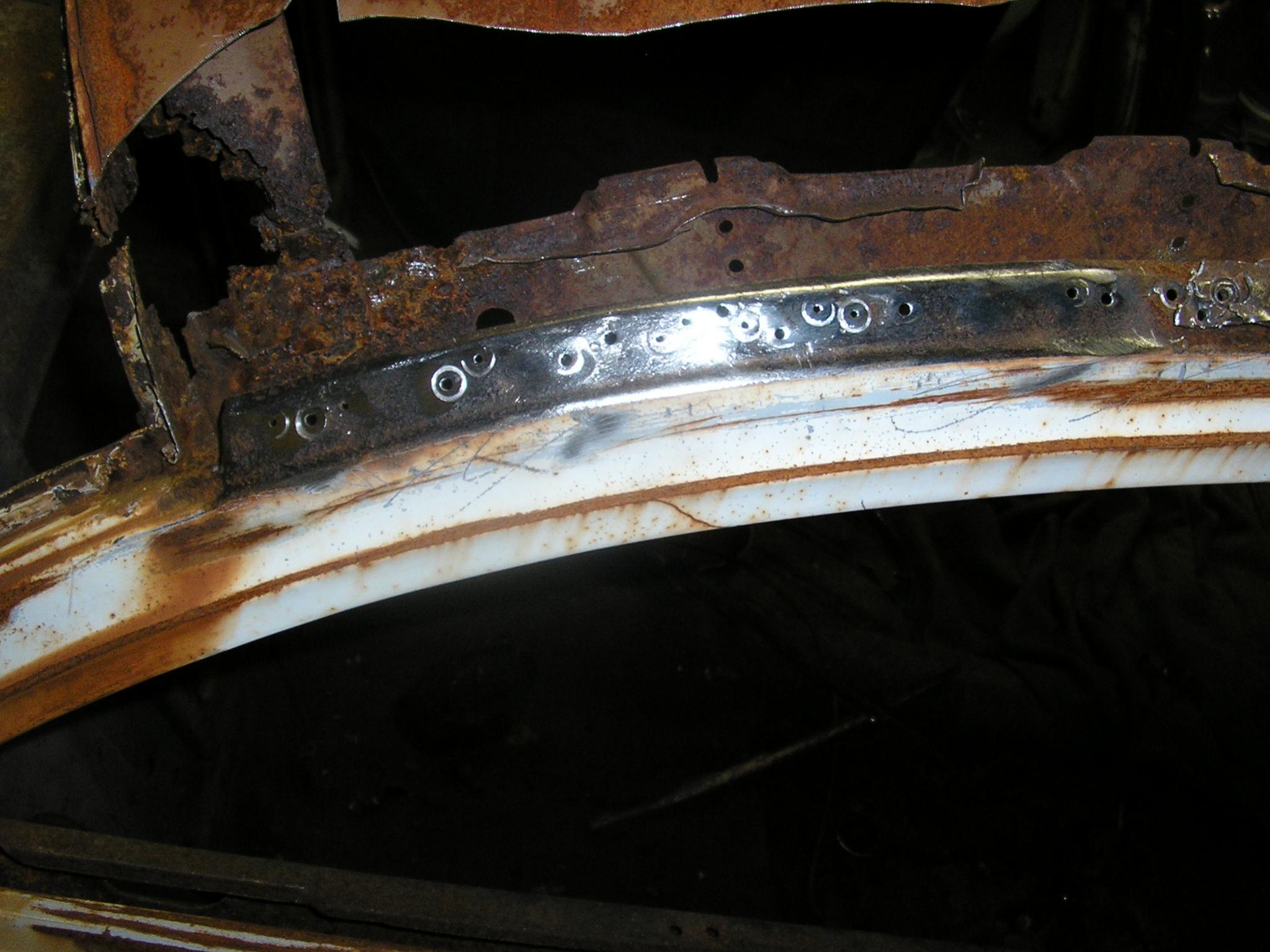

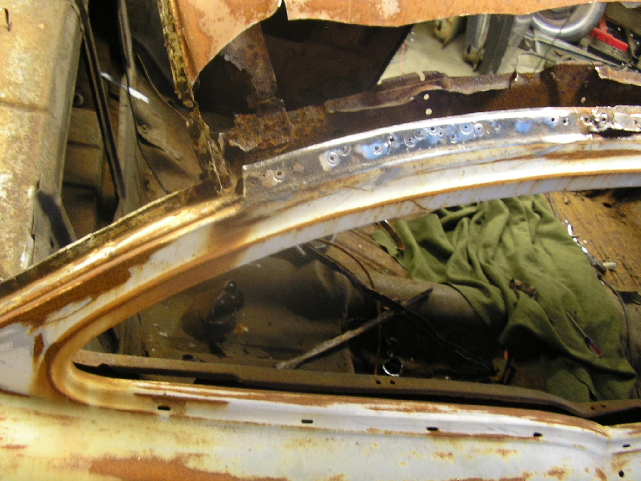

For those who want to know how these panels fit here you go. The fit is great...not GM perfect with respect to parts of the stamping, but better than rusty crap. If anything, the stamping is a bit too crisp on the belt line and a bit too faint in the door jamb area. Overall fitment so far is excellent though. I was not happy when I opened the boxes as the pass panel had been crushed in shipping...also was not thrilled by the drivers panel pictured until I hung it earlier tonight. I tend to be a perfectionist, so I can be my own worst enemy. These panels are well worth the $ and are much better than quilting a rusty panel together. GAME ON!

Here are pictures of progress at the rear package tray. Used more sections from the 4 door doaner car. Also pictures of the gas door structure (does not come with the new quarter. Last, some fitment work around the drip rail area.

Here are some pictures of the rear deck final fitting, the new contour to the front fender wheel opening and if you look closely, you can see the 55-56 Chevy wagon folding rear seat mocked into place.
