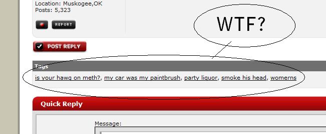

    WTF is up with these keywords?
      27.4 KB
