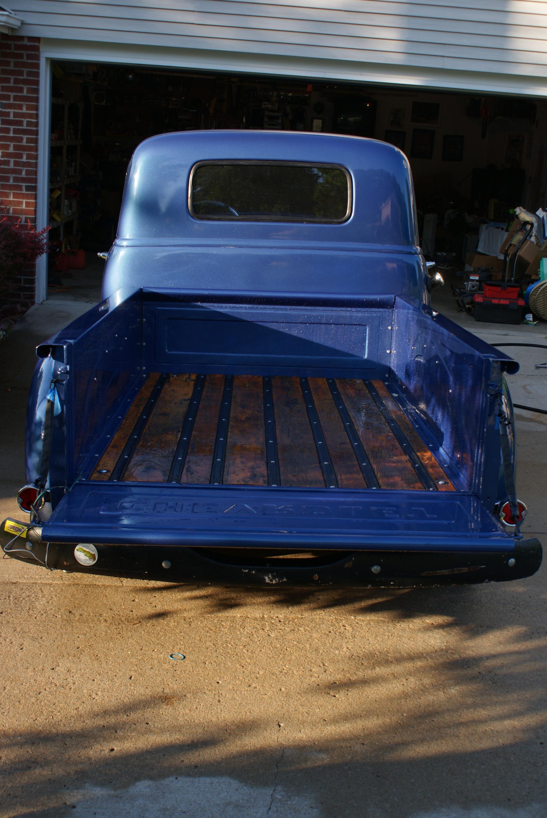

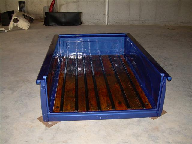

Default What to use to refinish wood in truck bed
I am not wanting it to look like the surface to a bowling lane but would like to classically(not a word i know) refinish the wood to get it looking better and able to hold up to some weather.
Click image for larger version
offline   Reply With Quote
