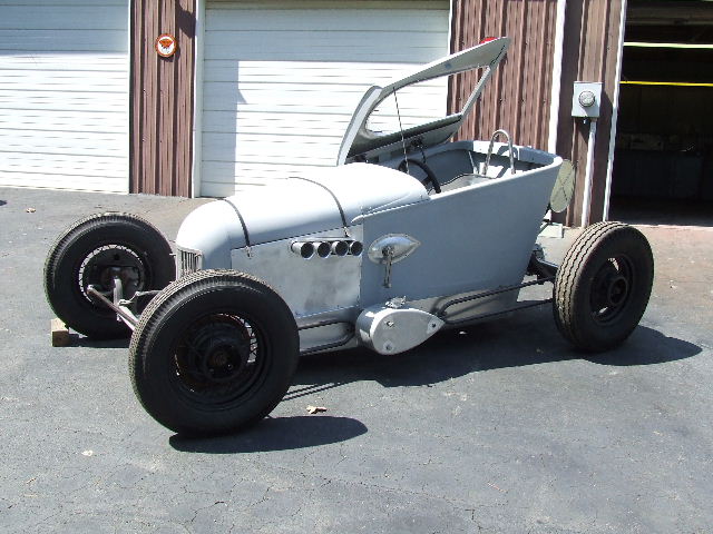

    Here's the final roll out of the car before I strip it down for finishing.

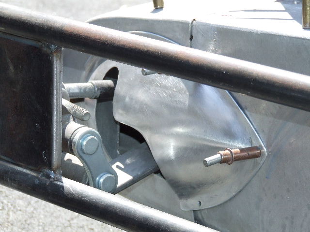

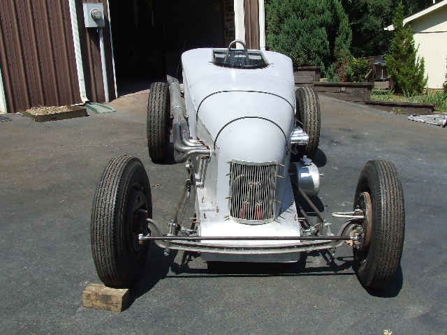

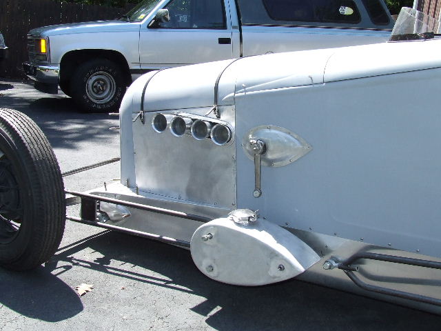

    Got a lot of the detail stuff off the list, such as primering the body panels and blocking it out, made the rear panel for the body, made fairings around where the front spring exits the belly pan and took care of most of the body panel fitment. Also finished making the headers after fussing with them several times. Now all I have to do is final weld them.

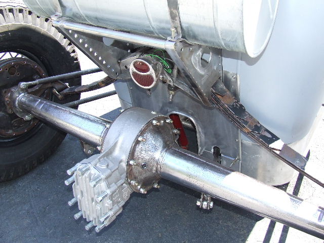

    Also got my Spadaro QC unit. The belly pan has to get sent out to get the louvers punched and and I have a solid day of welding the chassis.

  6. Unreal!!! That's one of the best cars I've seen on here. Tons of originality and innovation. Looks like you have levered shocks mounted behind nose piece. Love the cockpit cover too.

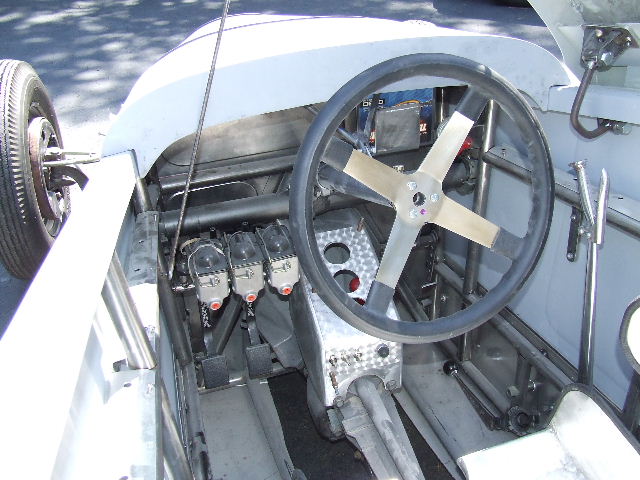

    Love the car but how do you use the brake and clutch together?

    As far as the pedal deal, I have a similar set in my other modified, it just requires a little fast and creative foot work, plus use of the hand brake if needed.

    There is no dash, so to speak, just what I call a pod; that mounts to the trans...the tach will be mounted on the steering column.
    The quickchange is the Spadaro/Winters unit.

    Neat car I was wondering what is the 3 masterclinder's for.

    Thanks John. M/Cs are for front/rear brakes and clutch slave cylinder.
