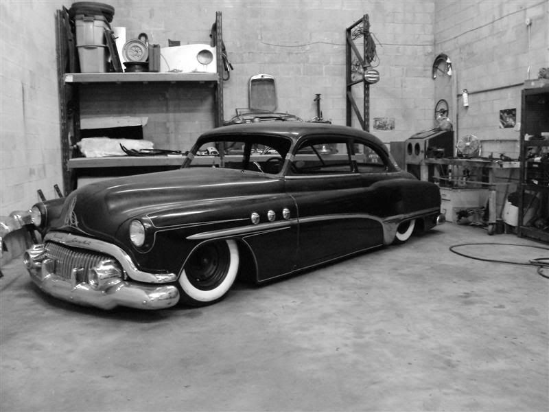

    so, getting right into things. for the moment i have only taped off 2 vertical inches. chances are that i will end up doing 3 vertical inches. i want to take my time and sleep on it. make sure it looks right. plan to keep the back window intact, only tilted and slide it forward some. i have been told that 3" is the max to reuse the stock rear glass.
    a measly 2 vertical inches = 2 1/2" of A-post taped off...
    some of the planed cuts, roughly taped off...
    wish me luck!

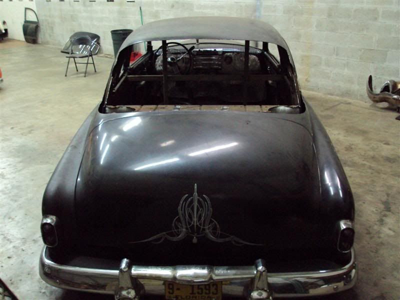

    every cut possible i made with a hand held hack saw. my friends ask why? i said cause i want this moment to last...
    cutting wheel was used too, made the long roof cut and other rear window cuts with it...
    i had mixed emotions when i finally saw my car topless. did i make a mistake, nah it will be even better...

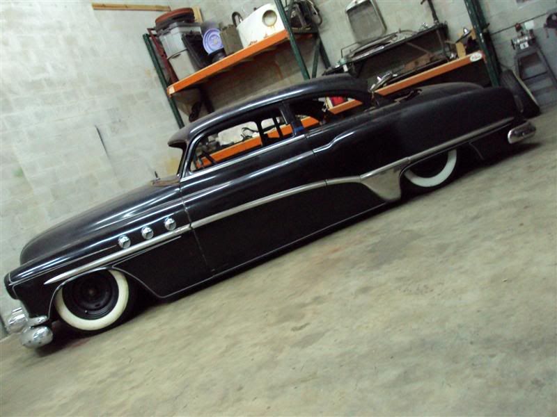

    slept on it last night and decided that 2 vertical inches is all it needs. so the A pillars are almost fully welded back together as of last night...
    think the proportions are just right of window opening to body mass. its how the factory should have built this car...
    another shot...
    so, tonight i move on to the B pillars. they will be moved back and welded in to support the roof center. then the radius at the rear quarter windows will be installed. that will give me enough to work with the back window position and tilt.

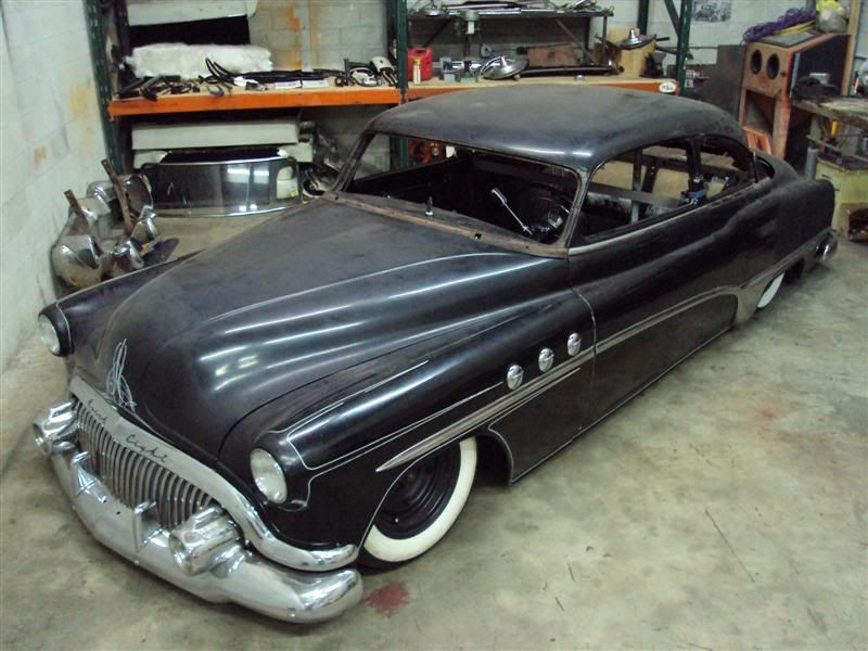

    thanks everyone, its quite surreal to me still at times cause i have owned this car for so many years already. im the 3rd owner! got it with OG paint. so for me to cut my perfectly dry solid car its not easy. but i am enjoying every minute of it and look forward to the many more hours i still need to put in.
    interior view...
    B pillar is moved back & welded in...
    roof is perfectly level & all windows are equal...
    last but not least will be the back glass, it will be the most time consuming part of the job and either make or break the chop...
    had a lot to do today, other stuff that is customer cars and house stuff, i think tomorrow i can dedicate much more time to it. hopefully weld in the rear quarter radius's and perhaps the door tops.
