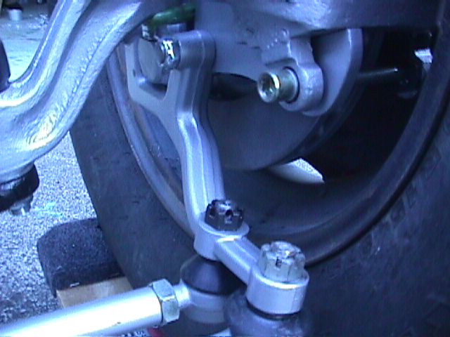

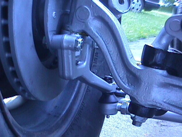

  14. 345 Desoto - the arms look good, but if you get a flat tyre - is the steering set up going to hit the ground before the rim.

  21. BOBEDT - No, the photos make it look like it would, though. They're up plenty high enough...
