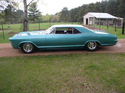

    That was exactly why I was glad I had asked the guys here first. The paint looks to be GM Aquamarine with flake. Not the original Riv color and the car has been chopped, shaved, etc., so not sure when it was originally painted, though I'm guessing the 80's. Overall, the paint is in really decent shape, and I don't want to have to shoot the whole car. I was thinking of either trying to find the same color and repaint the damage, or maybe hit it with some sort of design.
    Again, thanks Chop for the help. Speaking of, here is a pic before the da.n CAT!

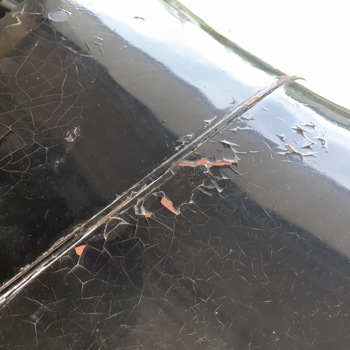

    khead47
    So......what is this ?
