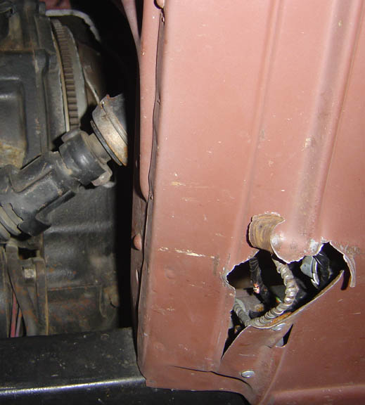

  1. I was showing off the hot rod to a guy who gets me my best salvage parts deals. One of his workers asked how she sounded so I started her up, let her idle a bit, and reved it to 4500. BAM! :-( From one of the chunks of pressure plate it looks like it has been dieing for a while. This was just the last straw.
    The bellhousing is done, as is the pressure plate that let go. A big chunk went through the body and caught the speedometer cable, dimmer switch and a wiring harness. Hard to imagine it causing more damage. I hope the flywheel will be OK but I'm going to wait to find out. I'll tear this mess apart next week. On the upside I was only about fifteen miles from home Sure glad this didn't happen while I was in Texas.
    The bellhousing is going to be the challange. The guy I was showing off for has one but it is on an engine block that's been sitting out forever and is rusted up solid. To get the bell off you need to remove the flywheel which uses nuts that are on the block side. If you can't turn the crank you can't get to the nuts. It's a little Dodge engine but since the block is a hemi I'm afraid he things it's all $$$ Hafta see what he wants for the wole thing, torch out the flywheel, and get the needed bell.
    Oh, well. I always wanted this to be a race car of sorts. Wish it didn't do all these race car things.

  3. I forgot the visual aids. :-(

    oh man.....and you didn't get hurt at all??? you get the lucky-dog award this week! i've heard and read about shit like that happening but never really seen it. man, that pic really shows what can happen....mike

  6. Yep, I came out fine. Making HP with OLD parts has a price. The clutch was a rebuilt truck 11" Borg and Beck.I forget what gauge of steel I used for the floorboard but it held. The shrapnel would have hit it at the angled portion so the glancing blow wouldn't have been as bad as the direct impact on the side. It is far enough forword that my feet never were in jeapardy. I think the kid that wanted to hear it about crapped his pants though! :-D

  11. I will do something about a scattershield. At a minimum I'm going to make a shield that goes over the bell, if not replace the bell with something like a lakewood. Not sure I want to re-engineer the clutch linkage arangement with a different style bell. If I can't get a replacement like I have I won't have a choice.

    hey kerry, i just looked at that pic again. my monitor is going bad so the pics come out real dark on it. i thought i noticed the teeth from the flywheel above the steering column so i copy/pasted that pic into my photo editor and lightened it up some, jesus man, you can see the bell is blasted right away up there, HOT-DAMN !!!....great pic

  14. Yeah, the top of the bell ended up in a bunch of little pieces. I'll be back. This gives me the chance to upgrade the clutch some. Wasn't it in the Hot Rod movie with the hemi powered Willys where he said something like " if it breaks with a four barrel rebuild it with two. If it blows up again supercharge it..." I'm trying to think like that.

  24. No way am I dumping the four speed! To much fun! I'm going through all the options in my mind but the right one involves modifying a blowproof Mopar bell (like a lakewood)to fit the trans, use a countershaft instead of a fork, and modify for the starter.
    Of the parts I recovered outide of the bell are a piece of the pressure plate face about four inches long and a mangled spring. Not sure how much made it long distance. I'm hopeing and praying my Weber steel faced aluminum flywheel is OK.

    As for the Garlits thing I'm not playing with nearly that much horsepower. If you have ever seen the picture of that clutch coming apart, it cut his entire car in two. Not that this little bang isn't dangerous, just on a much smaller level than Big Daddy's.
