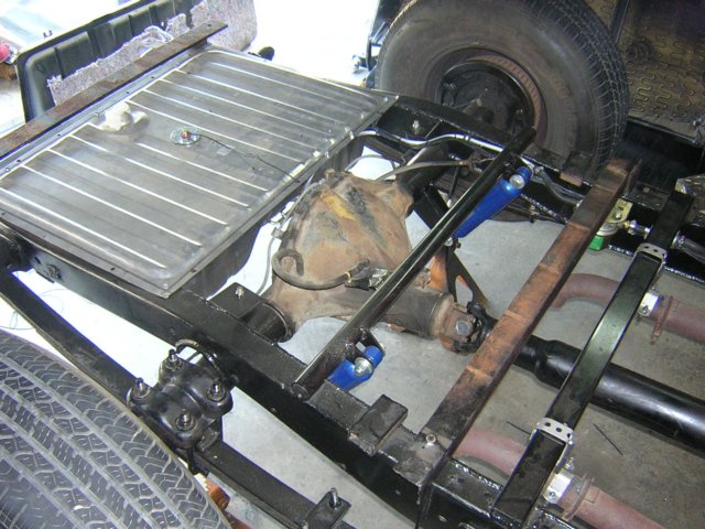

    Killer, what year mustang tank is that? It looks like it GREW there...I like it!! Is that filler neck behind the license plate?
  6. Killer
    Joined: Jul 5, 2001
    Posts: 1,569
    Killer
    mid 60's. you could move the filler anywhere. Usually just poke it up through the bed floor..

    It looks like you cut out the spare tire crossmember completely and then capped the END of the frame...am I right? Does the axle-travel interfere with the tank?

  17. The Paddock has those Mustang tanks with a new sender and gasket for about $125 or $150 brand new. You are looking for a 1966 tank....it has a straighter up filler neck. 65fordguy just did one on his 65-ish Ford truck a couple of weeks ago. Said it was a snap.

    Be sure to layout how your exhaust will be routed before deciding on a tank. If you use the Mustang tank you will probably not have enough room on the sides to route pipes for a rear exit. If you are planning to take it out the side it would be a good option. The first gen camaro tanks (18 gallon) also work well for that exhaust style.
    I do not know if the Blazer tank is too wide.
    I used a 16 gallon universal tank from Tanks, Inc with a bed fill access. I like it.
    Be sure to work out the sending unit ohms before deciding. The Ford sender ohm range is different than the GM sending units.

  26. ...68-72 Nova tanks fit well, and the filler ends up behind a flip-down licence plate mounted in the "dip" in the stock rear bumper. Check Rockauto.com for good prices.
    ...this is a used tank pictured...I'm runnin the exhaust over the rear and down behind the rear tire...

  29. ...on the Nova tank posted above, the bumper hides the tank from the rear, sorry no pics. I hate tanks that hang down too low.
  30. WOW! You guys are fast! Thanks for the info. What are your sources for the Mustang. Nova and S-10 tanks, junk yard OR new on-line? Do any of them have SIDE Fillers? I had seen them when searching months ago, but didn't record the source (duh), now cannot find again. I can't reverse the one in the picture unless I eliminated the drive shaft = great for gas mileage, but way too slow = 0! :D
