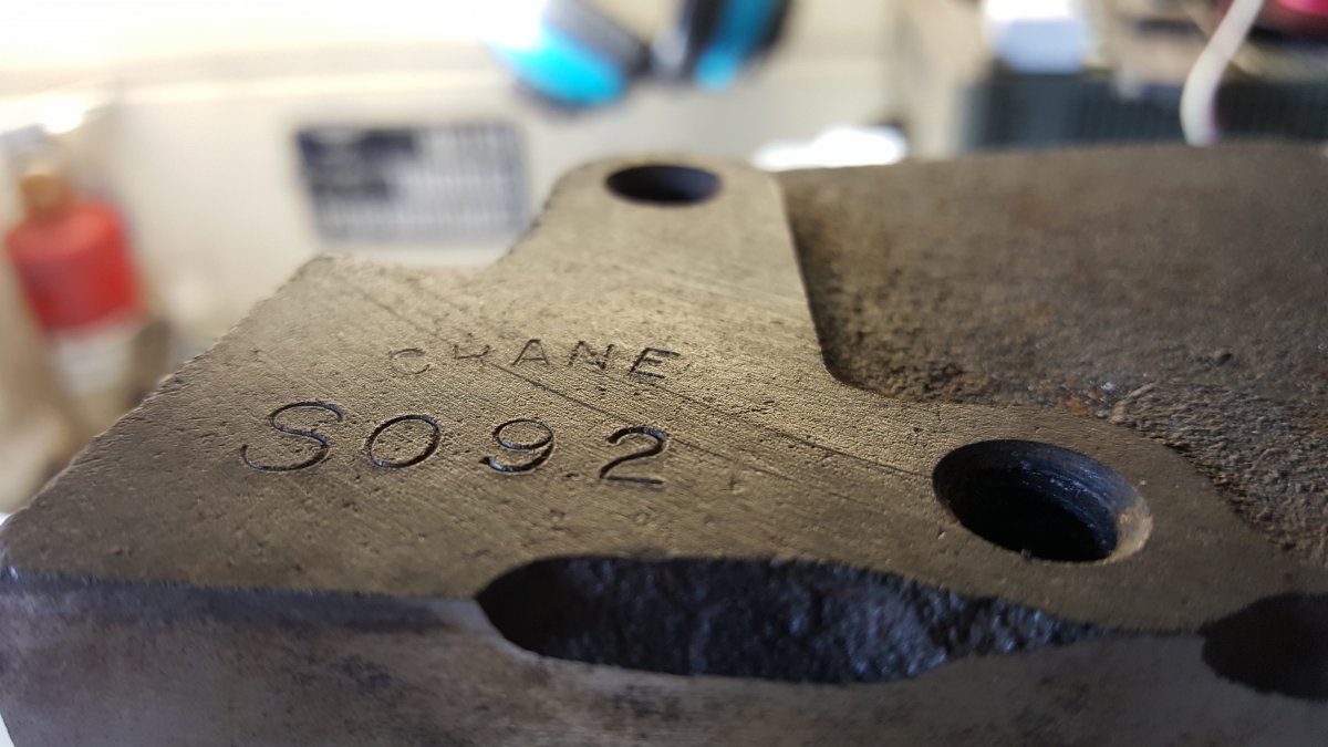

292's have no heat crossover and the last book I have that mentions them as being the hot setup was printed in 1980.
The ones in the books I have all have CRANE stamped in the ends of the heads.

Crane did small block Ford heads also. Yes they were stamped with Crane in a semi circle like a frown. The big tell tale sign from the outside of the Crane heads was the perfectly round exhaust ports. The combustion chambers look like they were done on a milling machine because the radius look to consistant to be done by hand.
