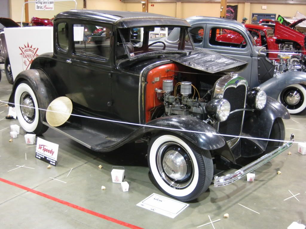

  4. Getting closer on the roadster, going to the Portland swap meet to look for some banger goodys this weekend :D
    Had the coupe in a car show so I had to get it all cleaned/tuned up. She runs great and has awesome power. Seems to do 65 with ease and barley any throttle.

    chris,
    cool rides man....what's been done to your coupe motor?
    andyg
  6. Thanks a lot,
    It's a "B" engine with a counterbalanced crank, lightened flywheel, Winfield SU-1R cam, Dual 81's, header, Winfield 6.1:1 head and a Mallory Distributor. It's mated to a 37-38 Ford three speed and stock "A" rear end. Has all kinds of power compared to the stock stuff. All the stock brakes, engine and tranny are now in my roadster project.

    andyg
    any utube video of the engine running? i would love to here the su-1r cam, etc in action. any port work on the block or any combustion chamber changes to the head? I wasn't impressed with the casting of my winfield 6:1. looks pretty ugly in the chambers. what kind of adaptor did you use for the tranny? i would like to do the same to mine...or maybe put the later gears into my B case.

  8. I don't have any really good video, I just got the thing running/driving really well. My Head looked good, but I have heard of others getting a pretty crummy casting. Valves and chambers are stock, just a "bolt together" engine :D
    I want to build a pretty healthy B sometime, go with inserts and do some port work, but gotta wait until budget allows.

    does it have a nice lope to it? does it sound anything like 4bangertroy's coupe that's on utube search under "banger hill climb"? his name is troy something...jones i think but not sure....from pheonix, az

    chris,
    that last one was for you and by the way....where did you buy that head. i bought mine from red's headers.
    andy
  12. Yeah, it lopes really good, the whole car shakes back and forth at idel. It seems to really build power at higher RPMs, It really takes off once it starts moving. Got the head from Red's as well.

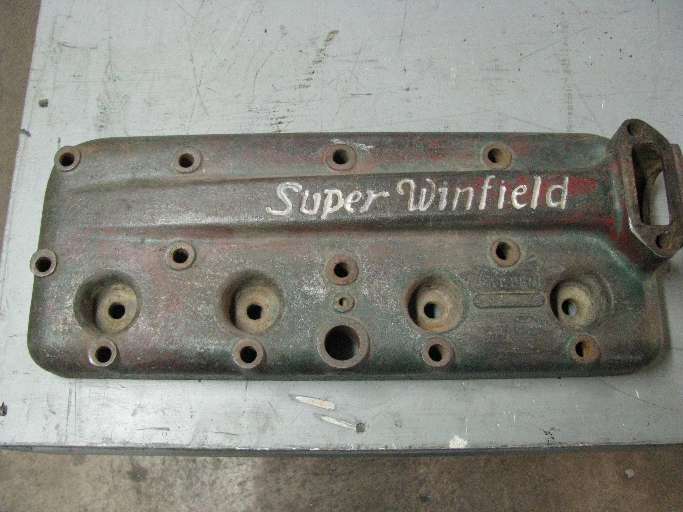

    Hey guys! I need a little helping identifying this head. I would like to Know approximately what the compression ratio is. The combustion chambers are about 1/2" deep near the plug hole. my dad used to think that it is the 'red' or 'sprint' head. thanks

    heres one more

    Not the "red head" which was 7:1 cr. Yours is later and probably 8:1 or more depending on if it's been milled before
  20. Yeah, chambers look pretty shallow
