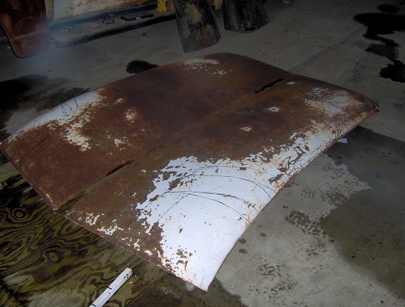

The boat-tail is the dominant feature on one of these cars.
The source of the sheetmetal that will become the boat-tail is where this project gets its name.
A free 50's Cadillac roof! (and misc other parts)
The roof has had the support removed and been split down the middle.
Here is a mock up of one side. If you squint real hard you might see a boat-tail. The windshield ends will be at the rear of the car.
