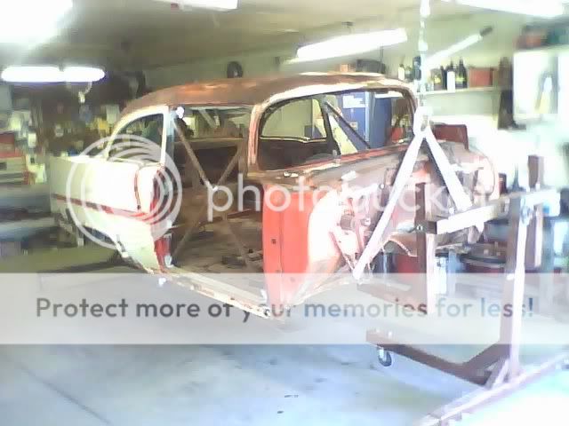

    Hey guys , Imnot a regular poster around here but lurk and read quite a bit. Been planning what im going to tackle next on my 55 and figured id share the scoop with yall. I know gassers seem to be the HIP thing right now , im really not following a fad here ha ha ha, just wanted to do one for a long time now and am finally seeing it come together , Still a fairly young fella at 28 but i bought my first 55 at 15 , just didnt have the funds to do an axle back then . Bought the car off ebay last april , she was falling around the frame rails and in perty rough shape . I really dont have a place to work on stuff when it hits 14 degrees here in central il so i do what i can through the warmer months . Bought the car back in april of last year and my first goal was to get the body off the frame and make sure it had a floor in it by the time the snow fell . I splurged on one of those one piece pans because there was nothin left in the bottom of this thing , braces were totally gone as well as the rockers. So after the new floor i por 15 everything underneath so i dont have rust to wory about anymore. I got lucky on some wheels and a rear end , my brother bought a 67 nova and a guy threw in a garage full of parts , i got to pick out a couple of things for helping my brother with some concrete work , so i grabbed a NICE set of Fenton gyro 3.5 x15's for the front and a 69 camaro 12 bolt posi for the back . I really dont think my brother new he was handing me a 1500 dollar rearend lol, he does now. I ran an ad in the local freebie paper lookin for some "WIDE ALUMINUM SLOTS" just what the ad said , got REALLY lucky and the first call was a fella tellin me he had some 15x11 slots , i asked him if they had a name and he said , " Yeah , they say GIE-RO on the back" lol , so needless to say , i have a set of 15 by 11 fenton gyros out back that much the front and he only wanted a c note for em. In my book , it aint a gasser if it doesnt have an axle , and thats what my vision had sooo i drug a 57 truck out of the sticks , litteraly , spent 2 hours with a machette just clearing a path i could walk down to get to the truck , 2 hours later with a bobcat and it was on my trailer , after some speedway phone calls , i had the axle ready to go in , and a fellow hamber i found over in kincaid il had a flip nose for a steal. So , im getting ready to start in this spring with the next steps , im going to try and get the chasis completely done , steering brakes etc , then im gone get after it with the sand paper and get the satin black laid down , then we will start focusing on that big block with the huffer , or maybe injected , cant decide. Here are some pics from along the way.
    Little vid of my progress so far i put on youtube
    http://www.youtube.com/watch?v=BqOkCZVBjLE
    First got it home
    Floors then
    Out with the old
    In with the new
    The axle donor truck hiding in the timber and my road i built with a machette in 105 degree heat and skeeters ha ha ha
    Got the axle out of the truck built with new king pins , springs and hangers , and i did go for some saftey so i went with discs up front from speedway.
    Nose just sitting on it to get a rough idea on stance
    Radiused the wheel wells one day after work and shoe horned the gyros wrapped in 15x 10w's
    Underneath the car with the new floors
    Inside
    Eliminated the old rear shock mount and used a bar inbetween frame rails , fabbed up this little piece of sheetmetal to cover everything up
    the only pic i have of it with the gyros on the front . The goofy scoop will be leaving , it will be getting a huffer or an injection poking through that hole.
    couple more pics to show stance , i might be redoing the front shackles and bring it down an inch or 2 up front , have not decided yet , wont decide till ive got the full weight of an iron headed big block up there.
