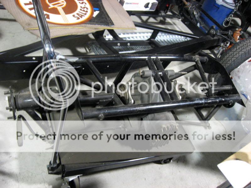

    Don't forget about Shelby Cobras. Although they are generally off topic here (as well as IRS) they do technically fall in the era of topic as well. A well known car that was based around the earlier AC Cobras were the Daytonas.
    This one is a hand built replica based of a a Daytona that we being restored in parallel. The suspension was replicated in the project. IRS with a transverse leaf spring! Very cool!
    Not sure of the make of this 3rd member. T-bird I suspect...
    By the way. This was this guy's first metalshaping project EVER! He's a hobbyist just like we are! Very inspirational!

    Scootermcrad, that is not a Thunderbird center section, I have several and it's not one of them.
    There are 2 basic types of "A-arm"IRS, those that use the halfshaft as the upper a-arm with a lower a-arm (Jaguar, Corvette and I believe the Kugel) and those that have true upper and lower a-arms with a separate half shaft (1989-1997 Thunderbird/Mark VIII, 2002 up Explorer, 1999-2004 Mustang Cobra and I believe the real 427 Cobra's). The Jag/Vette types could conceivably be lighter but if the halfshaft breaks there goes your suspenion.
    The Ford Thunderbird v8/SC and Mark VIII rear axles are strong and based on the 8.8 Mustang rear axle. Lots of parts available for them and they are relatively cheap and easy to find. If you use the "winged" rear cover from an Explorer it makes it easy to mount. The Mark VIII is all aluminum too. They are popular in V8 RX7's and Miata's and are the basis for the IRS option in Factory Five Replica's.
    There are lots of other IRS possiblities out to use parts for a hot rod including Mazda 929 and 1986 up RX7 which have the Ford 5 lug 4 1/2" pattern.

    Yeah, was pretty much just guessing. Any idea what it might be? Can't remember what he said it was out of. If I recall it was something old that had been completely gone through. The website that this car was on has been recently removed and I don't have the guy's email to ask. I don't remember his name, for that matter.
