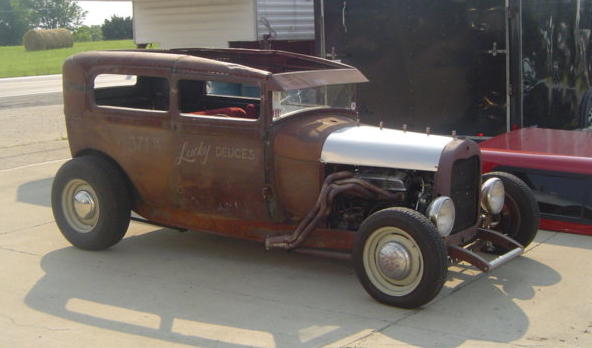

  11. Dreddybear
    Joined: Mar 31, 2007
    Posts: 6,088
    Dreddybear
    Bad Ass!

    for inspiration
  13. rick finch
    Joined: May 26, 2008
    Posts: 3,504
    rick finch
    Bad ass is right!!!!!!!! That thing is killer.:cool:

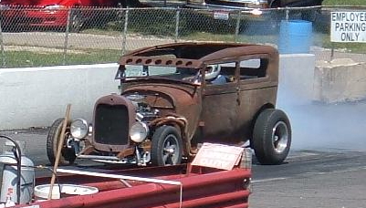

  15. The A-400 is bitchin!
