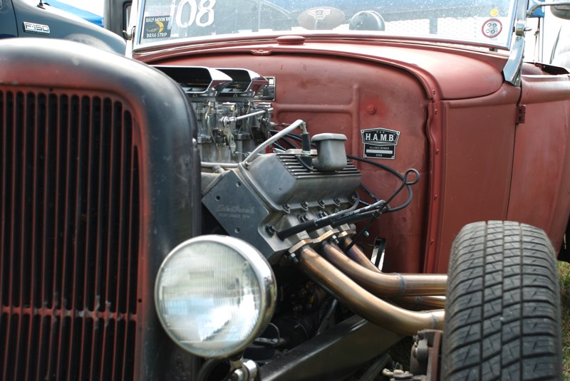

Cam Bearings...???? Never had that problem...
My Roadster with a internally Stock 455 ran a 12.02 @ 110 MPH (traction issues)
With Aluminum Heads and a cam... 11.71 @ 119.96 all below 4,500 rpm (traction issues)
Weighs less than most Small Block Chevy with a mountain of torque!
And done right you can have a "BUILT" 455 inexpensively!
Cons are Header availability... and drilling crank end for manual tranny.
4 speeds and the manual setups can get "Pricey"... run the 350 only if it's in a light car. Or go right to a 200r or 700r4 and you can run a steep 373 rear gear for massive launches and the ability to Idle down the freeway.
And if you're going manual tranny instead of drilling the crank and spending a few hundred reconditioning an "OLD" crank... I'd just buy a "New Eagle Crank" from Rocket Racing for $575 that's ready to run either a manual or automatic!
For REAL WILD Performance... Rocket has the "NEW Forged knife-edged Crank" for $2,100!!!!
I had a set of "C" heads on another 455 and didn't have a noticeable performance difference when I went to Aluminum heads except for the lower temperature!
You can find "C" heads everywhere and totally done up with the Large valves, hardened seats and a Good set of Roller Rockers... you'll get a ton of performance for a fraction of the cost of the Aluminum heads alone!
