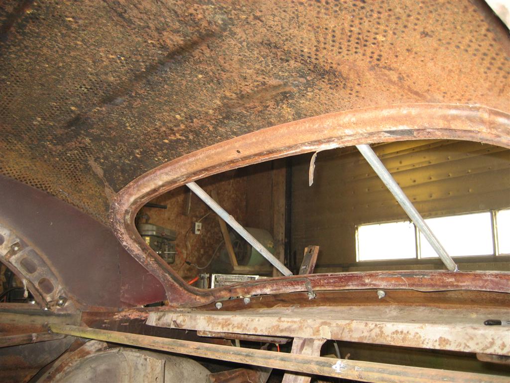

    Well the story goes I got me a free 2 door chev so I decided I'd take 3" out of the side of it and pull 4" off the top
    I'll post updates as I go
    Just got her home

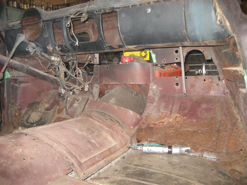

    Nice ratty interior

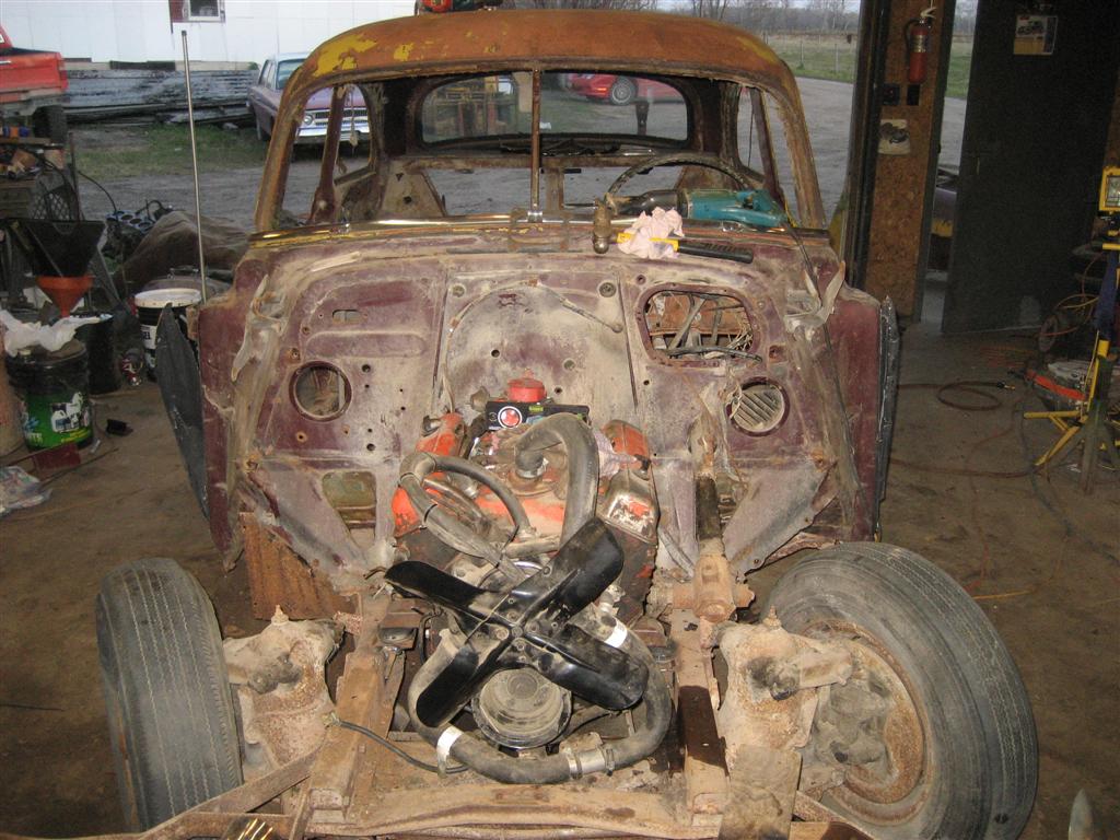

    Strip down time

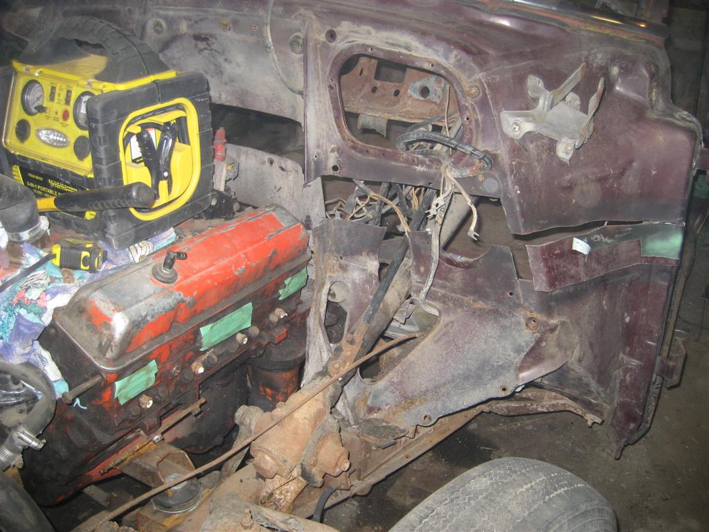

    New power plant chev 350
    Some rust issues have to get those out the way first before I cut her up

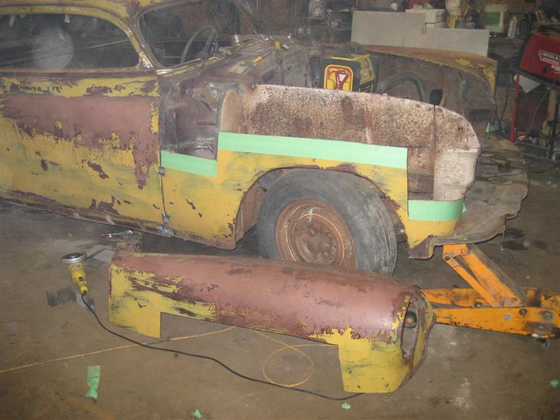

    Getting her marked up for a 3" section

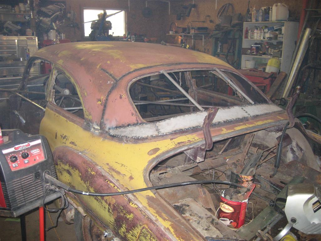

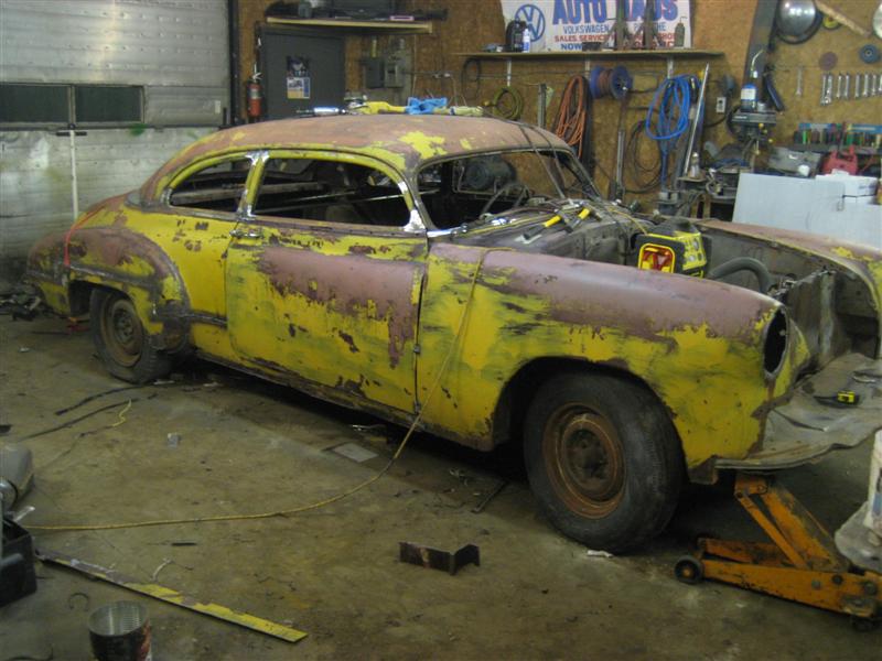

    Snip snip
    Drop her back down
    The start of lots of welding to come
    Now for the chop. Keeping it simple strait 4"

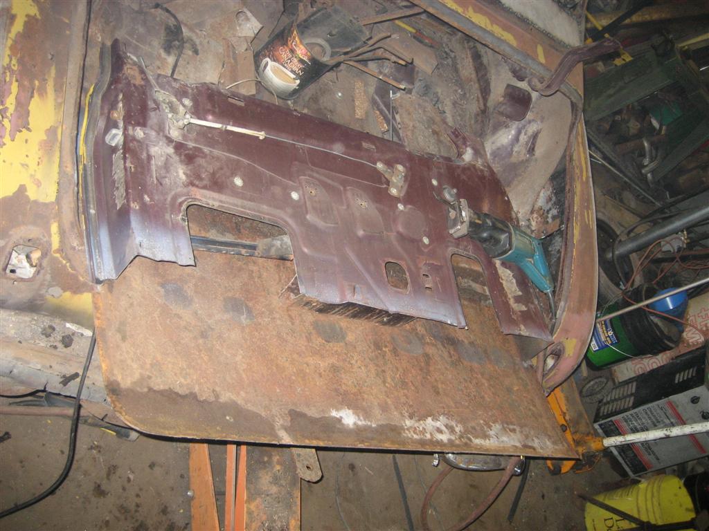

    Now to start on the doors

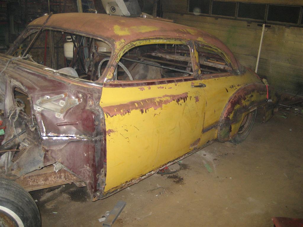

    Doors back on and decided to slant the posts
    Parting shot for now...

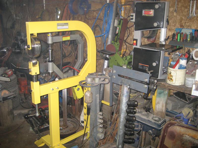

    New toys!!

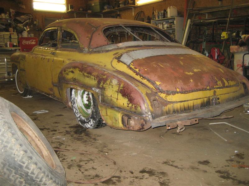

    Time to squash the trunk
    First gotta cut out the guts
    Next mark it and cut er up
    This part was a lot of trial and error now I know why everyone bitches about doing these trucks and nothing lining up or stretching to place lol. Eventually got er figured out.

    Innards all abortioned in place
    The new slimmer ass end.
    Parting shot

    Nice job man! I like how you did the doors,instead of cutting through the outer skin you relieved the inner structure ,slid the skin down and trimmed the bottom off,Nice.The trunk lid came out great also.Jobs like this separate the Bullshitters from the real custom builders with talent .
