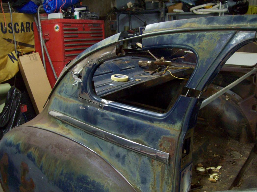

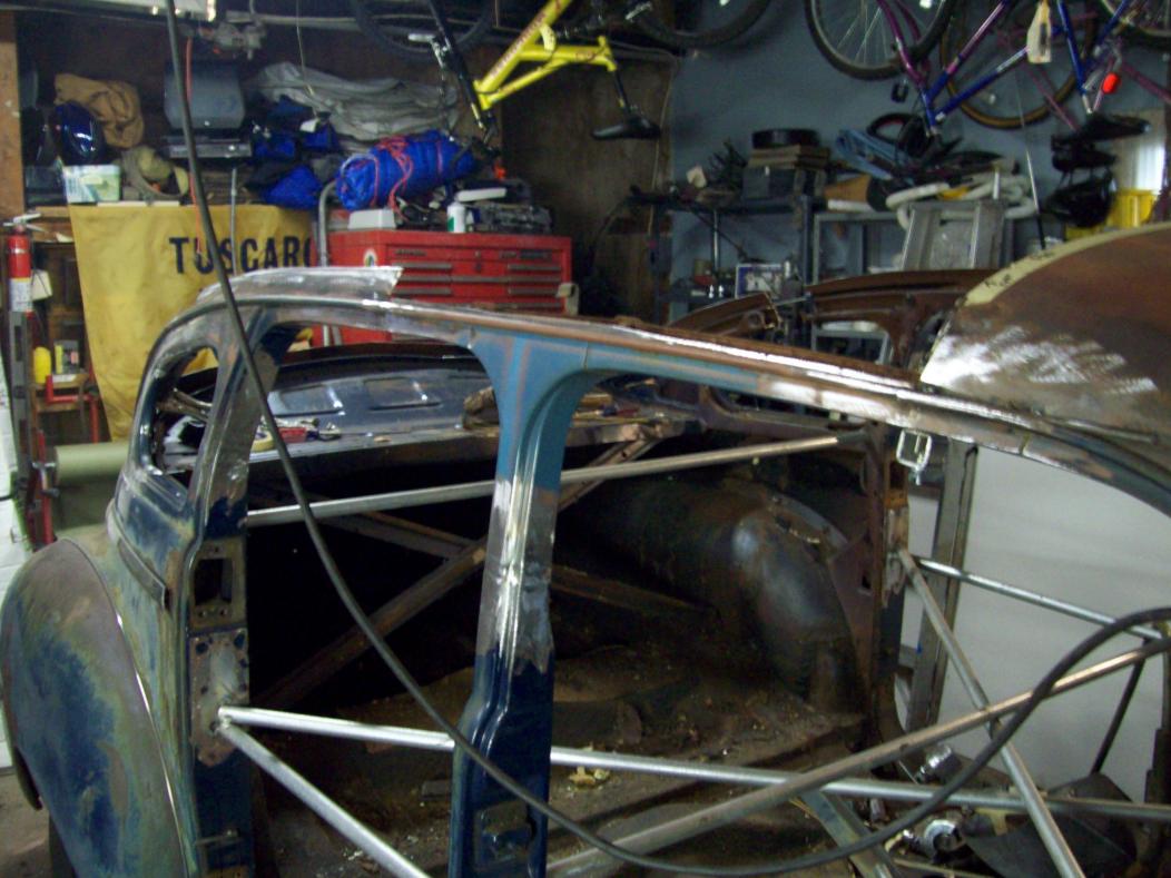

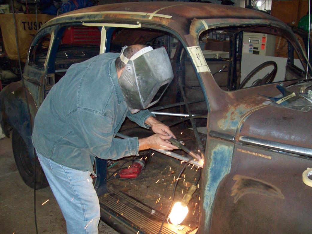

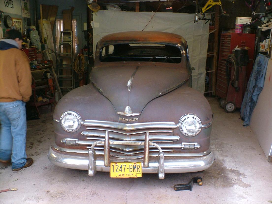

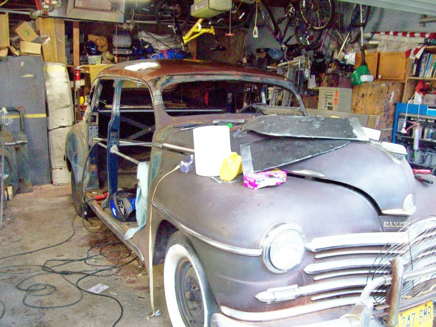

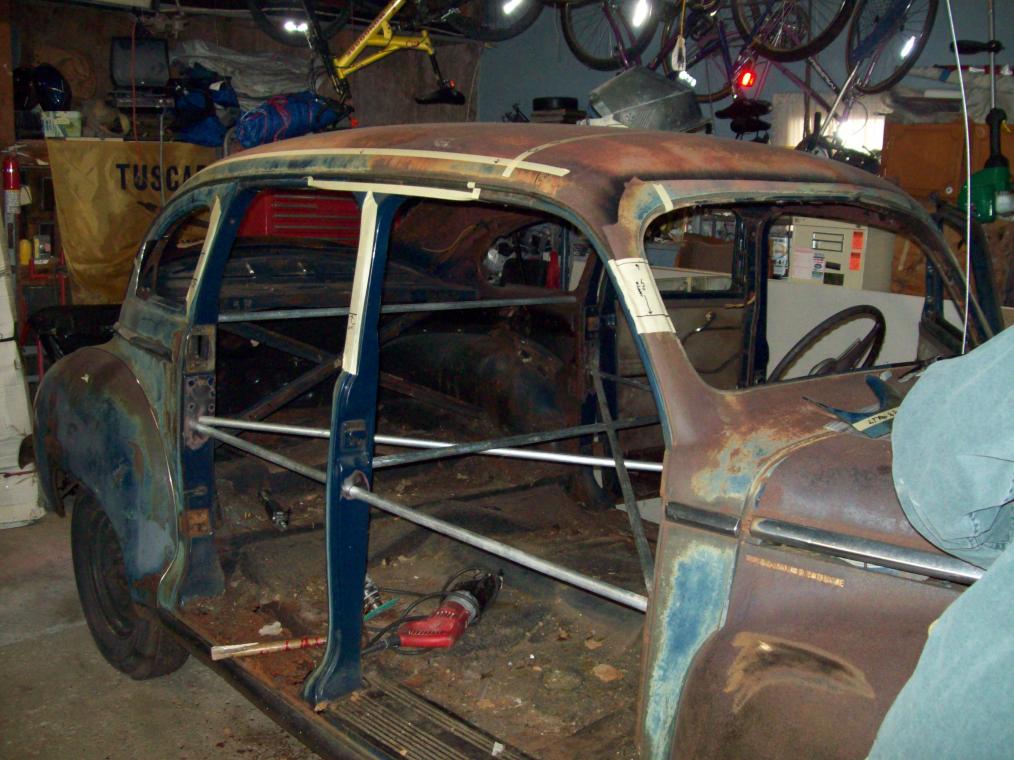

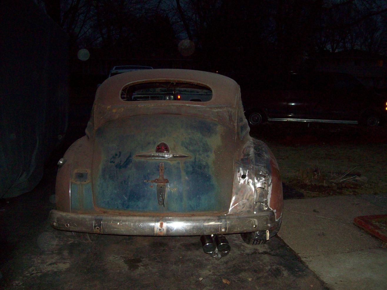

    Well today I took the plunge and began to chop the top on my 47 Special Deluxe.I have a donor roof for the car, and after thinking it was going to work out one way,I found out we were going to have to cut it in a lot more places than I thought. My buddy rodknocker was there to give me a hand, we began by cutting striaght across the front, just behind the windsheild.We then cut above the gutter back to the rear.My plan was to keep the B,C,& D pillars at the same angle as stock so they didn't look tilted it.Due to this being a 4 door,we went and got some 1/4" rod to put into the gutters to follow the contour,we bent the rod following the donor cars roof, then tacked it into place.Then we made the cuts at the B,C,&D pillars.We made it up to getting the C& D pillars tacked in.There will be more as progress is made.

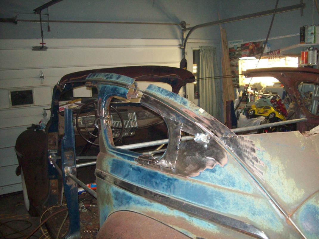

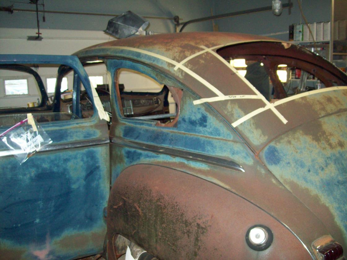

    I got the pillars welded in,and today I skinned my donor cars roof and slapped it on.This is working out pretty well, the rear window is going to set real nice without bowing out at all,again I'll have more updates soon hopefully.

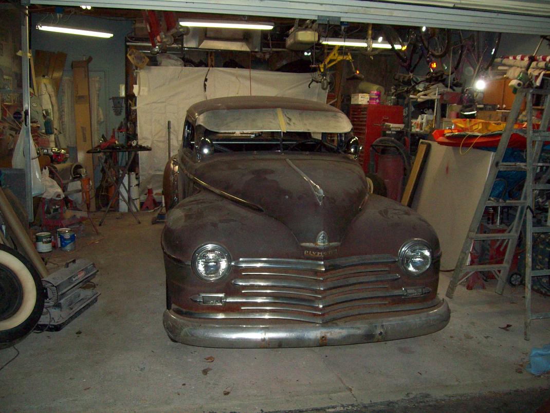

    Update... got the top all tacked in and dropped the front end a little.

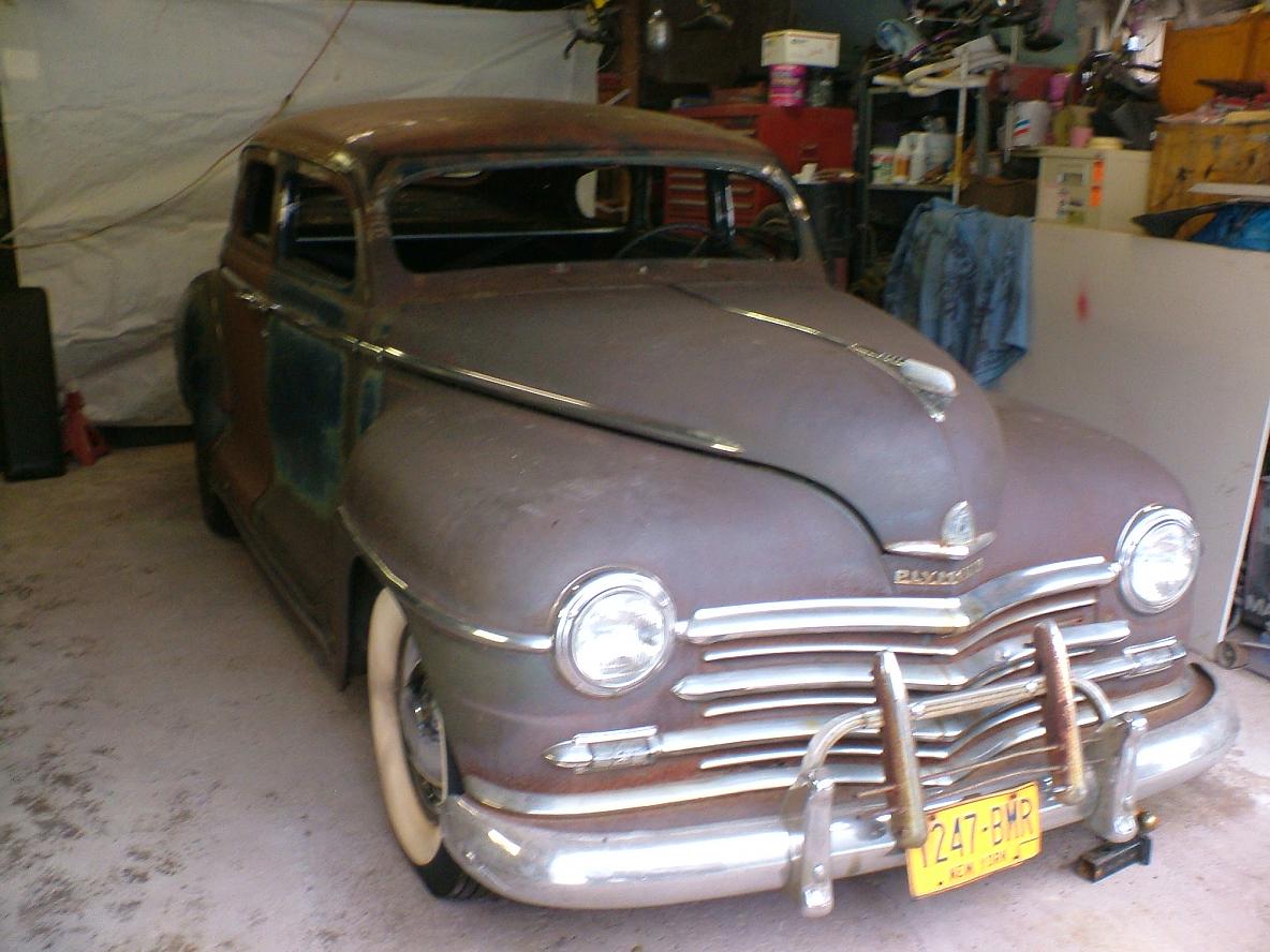

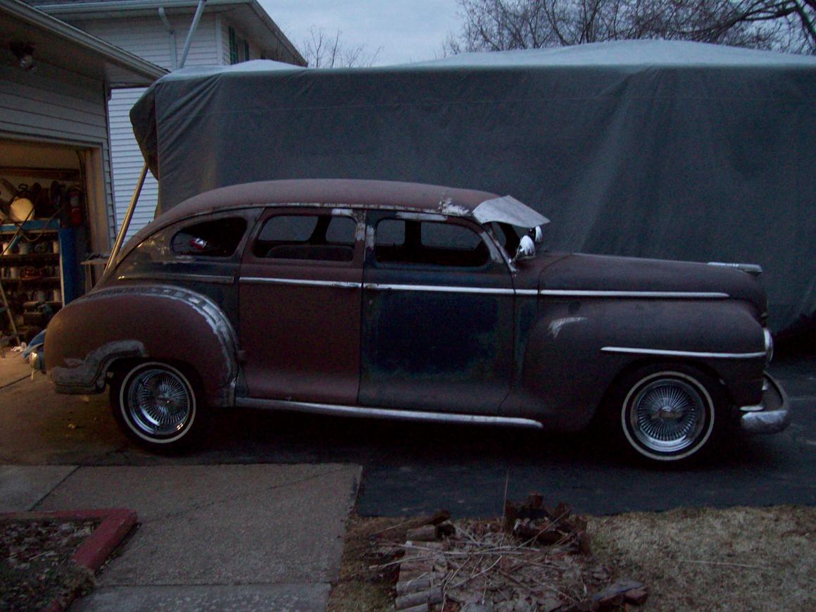

    Wheeled it out tonight to get a better view and to make sure everything is "flowing". I've been working on widening the rear fenders, also put the rims,visor,and spot light to get a better vision. Thanks for the kind words so far.

    Man you got bigger nads than I do. Your plymouth looks good with the chop. I found a pic of a 40 dodge tudor sedan like mine that was chopped and looked horrible. Curious as to why your widening the rear fenders? more tire clearence? later shawn

    cool car.......i needed to see it slammed

    it will eventually be like that, he's going to have the springs de-arched, He's widening the fenders to put it more in proportion, the fronts are nice and fat, so he wanted the rears to look the same.

    :DLuvin' it! How much are you guys widening the fenders, it adds even more to the curves on the old gal.
  27. rodknocker
    Joined: Jan 31, 2006
    Posts: 2,265
    rodknocker
    About 3" on each side.
