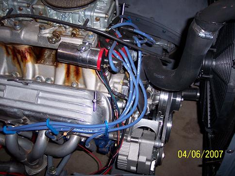

    I had and have a set one was made by Street & performance and the other Ford motorsport and the last one by me:D. The bottom pulley is flat and easy to make the water pump is a bit harder but still fairly easy for the single groove. I used a early bronco smog pump for the Alt bracket and mounts it low on the pass side. I also use the 90 degree oilfilter adapter . I have a extra set if you need some sizes:D

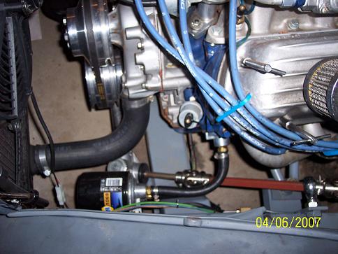

    Dirk35
    Forgot to add......... here is the pictures of my pulleys. It was easy, but not traditional looking. They dont look bad since they dont have those holes drilled in them though.
