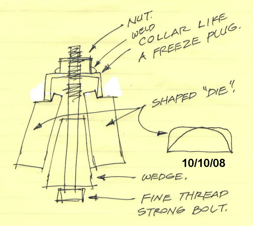

  12. First Your idea is cool and obviously will work... And I'm not trying to hijack your post.
    But the questions got me to thinking. What about curved pieces of tubing. I know there is probably a tool like this out there already. Probably at every muffler shop but I think this could be homemade like yours is.
    I've got too many irons in the fire to do this right now.... so I offer the design up. Hope someone builds one- maybe for the next tech week.
    Thanks, Dan
