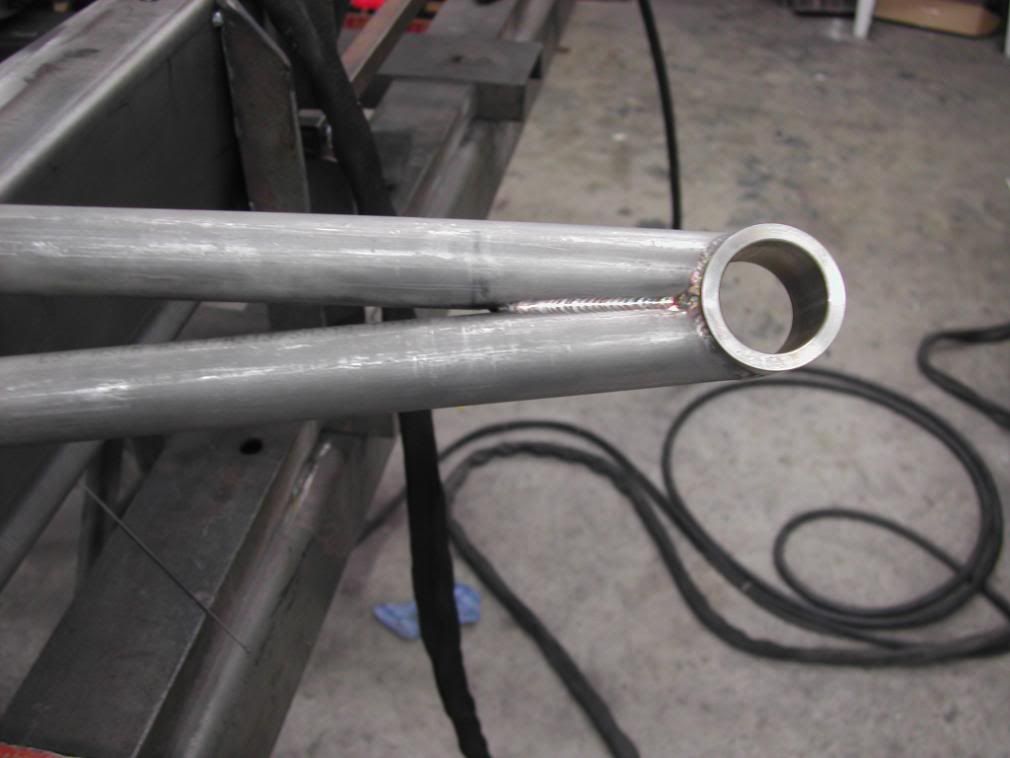

  8. Pretty good Aluminum Mig Weld...

    Aluminum welds look nice when they're done right. I cant weld fer crap. I think its an art.

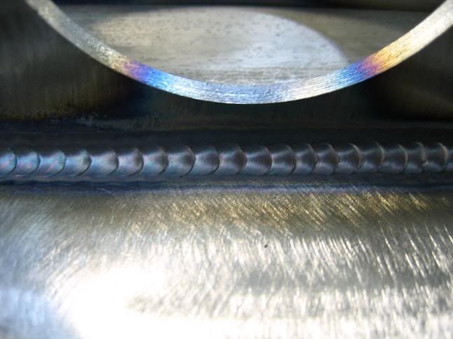

    This is a practice plate I did for a 3g(vertical up, open root, v groove) certification...the cover pass. It looks cool on pipe, don't have pics of that though.
    I did this sunday for a guy on a local board, it's stainless. He mounted it on a valve cover.
    A couple aluminum welds:

    You have to look at what makes a weld "ugly" or "crude". Inclusions, undercut, globs, too high of a bead profile, contamination, bad joints,ect. All of those things weaken a weld. In some applications they may hold, but they aren't as strong as they could be. Part of being a pretty weld is at least the appearance of a clean bead with the proper profile and no undercut. And with tig welding, a bead that passes visual inspection will nearly always pass a destruction test.
    I'm not a big fan of the "gorilla weld" theory: ugly, but strong as hell. If it's ugly, it's just not as strong as possible:)
