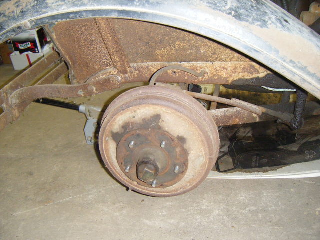

Megan is the drag link cut and welded together? I think I'd chang that first thing.

That is so cool,,I watch the video 3 times!,,I am so happy for you,,,but please do something about that drag link,,,It scares the crap outta me. HRP

Front end needs some attention. I would look into replacing what you have with a dropped axle and spring over set up. You can split the wishbones you have (whack off the spring perch) and recycle the spindles and brakes if they are serviceable. This should give you a longer (stock A) wheelbase and a better ride. And speaking of "ride" I think you need shocks as well.
