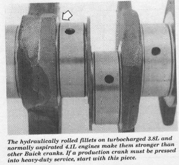

Kind of Depends on the angle of the V of the block. V8's are even at 90°, V6 and V12 are even at 60°. When a V6 is based on a V8 block, they are 90°, so they are odd-fire, unless the crank has the pins offset to make it even. Both the V-10's mentioned are 90° blocks, Ford uses offset crank pins, Dodge does not.
Here is an even fire 90° V6 crank. Funky stuff going on with journal offset.

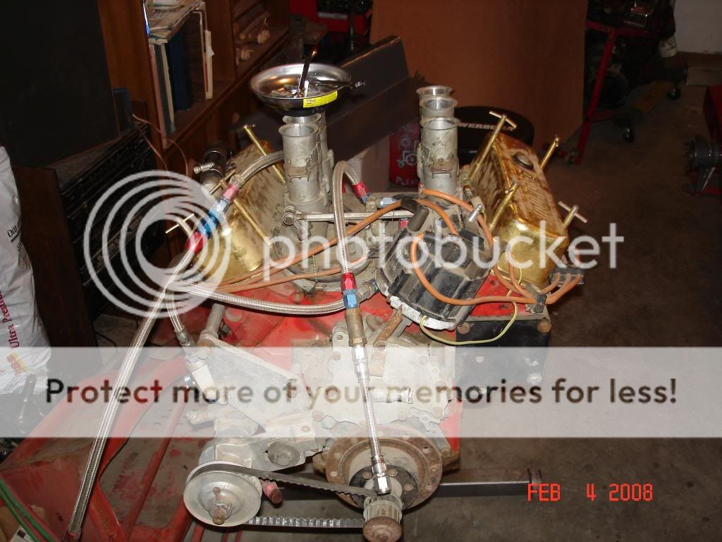

Default Re: even fire vs odd fire
Here is my 259 inch 1979 Buick even fire v5. it was the protype for the Indy and nascar stage 2 motors. it had 1.88 inch intakes and made 350 hoesepower on gas. it also has a dry sump oil sPhotobucketystem. the lower end is good for over 8000 rpms.
